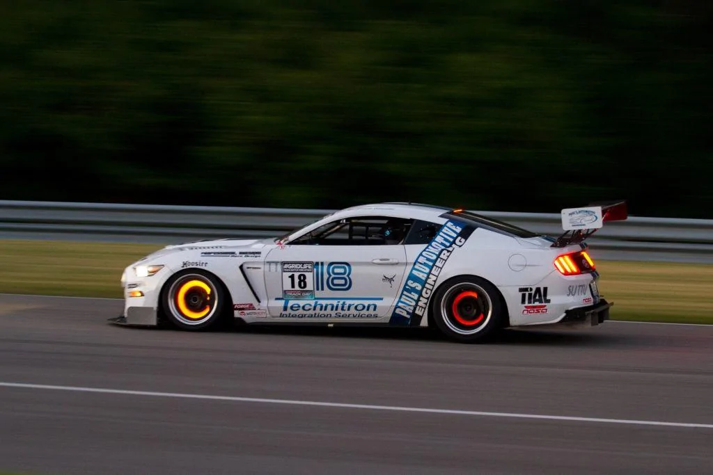

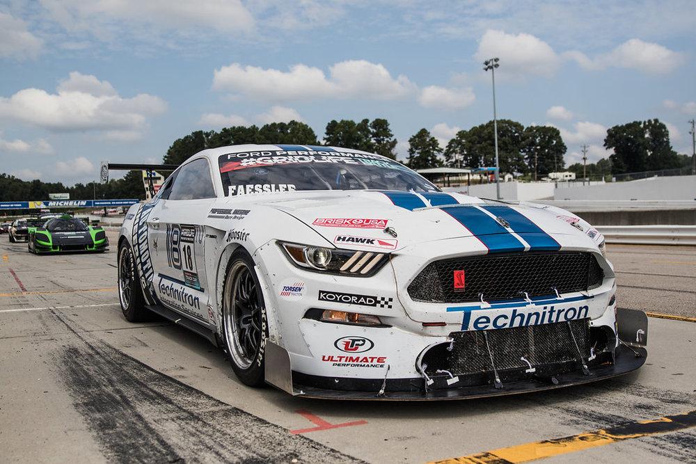

Look at the GT4/FP350 race cars for aero ideas, but remember, those are based on the non 2018, non standard Shelby bodywork.
