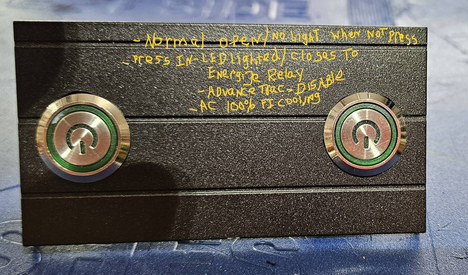

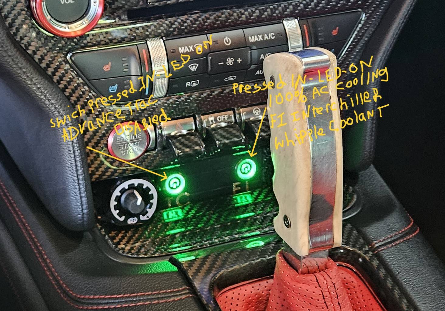

Just finished wiring in a set of LED latching Push Button Switches for Being able to deactivate the AdvanceTrac and Put the AC in 100% FI Cooling for the Whipple Coolant.
