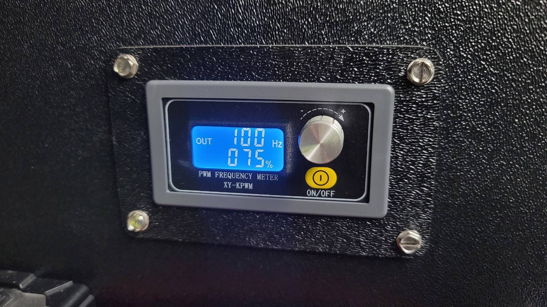

No, I have it on a speed controller. 100% is overkill. And pulls about 35a at full rip.
Can you tell me which speed controller your using? And how did you wire the 4 wires? I would get the mini temp controller but it won't work on the new CWA400

Amazon deal. Works great. Instructions included with unit. Easy to wire up.

Can you tell me which CWA400 part number you have. I was told when they redesigned after 03/2024 to a brushless motor the regular PWM controller wouldn't work?
- Do you remember if your CWA400 has 4 wires
BUT: They say to just ground Pins 2 (Lin signal) and 4 (power ground) and 12VDC on pin 1 (PWM Signal) and Pin 3 (12VDC power)
I was thinking of leaving power off of Pin 1 (PWM signal) if motor does not work then I will put 5VDC on Pin 1 to see what happens.
I wonder if this new motor needs a Lin Buss Controller which regulates the ground of the LIN wire instead of controlling 12VDC on the PWM wire?

I didn't really read this correctly the other day. My pump is the PWM version which is brushless. Pierberg moved to a LIN type control. Looks as if the LIN version is either on or off unless you have a way to control it. 100% all the time is not recommended in my opinion. It's gonna move alot of water and consume alot of power.
