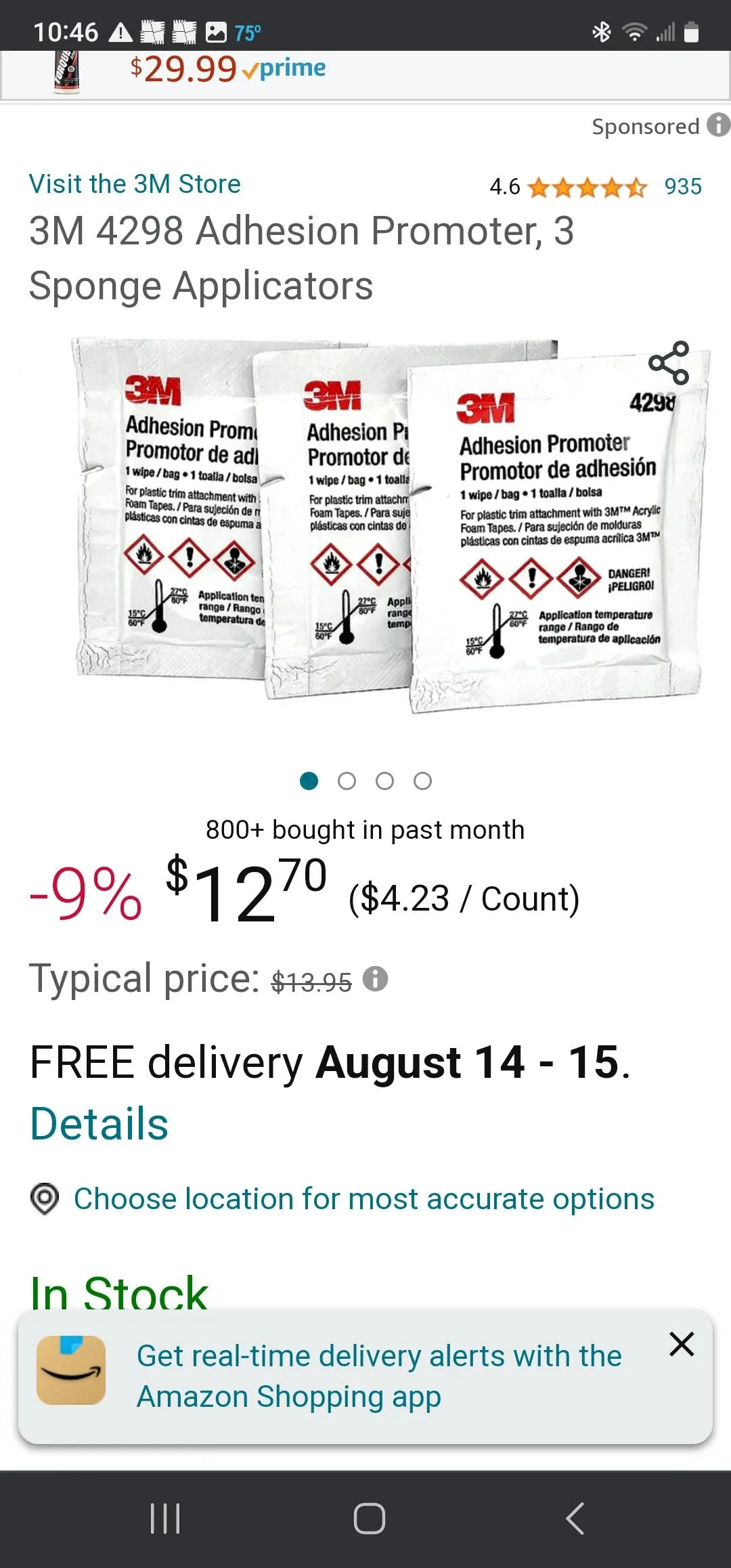

Adhesion promoter is a must. Make sure you dry fit the spoiler before you send it home.

There are different types of 3M VHB. The one you want for spoiler attachment is 3M VHB part# 5952. The adhesive portion is black. Don't use the grey version, it's not as strong. As mentioned, the adhesion promotor is an absolute must.
