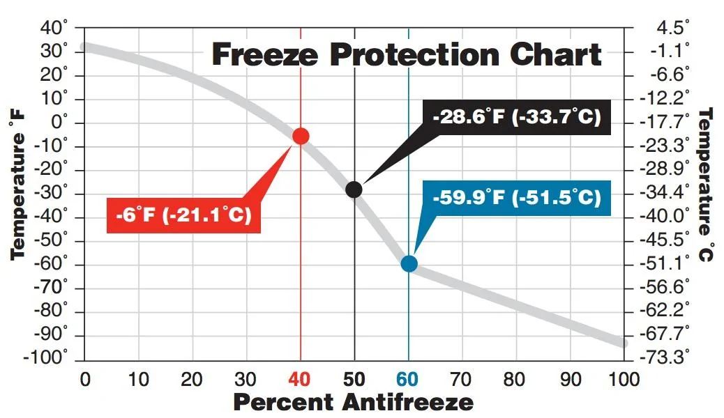

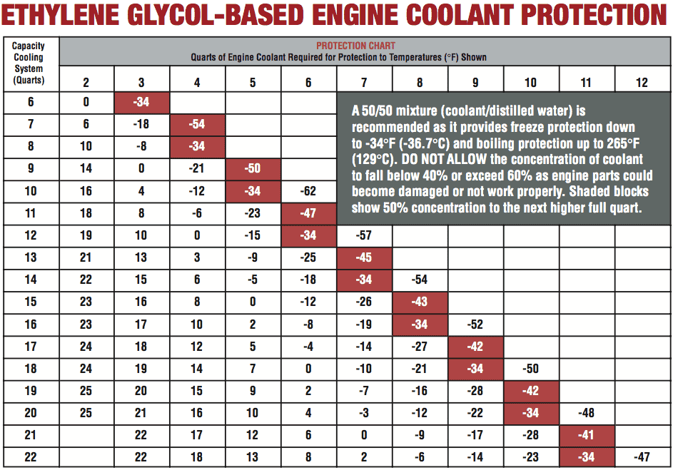

Seriously, it depends on the water. If tap water comes from a well, or has heavy minerals like here in the west, or lots of iron like in the east, then it's not the best thing. 50/50 is what you should always use, but if you're out here for example, you can use almost straight water with no problem (We don't freeze here).
If you're going to add water, distilled is the way to go, but I seriously doubt dealers have jugs of it. I doubt Jiffylube (et al.) don't either. It's the same water that feeds the toilet.

How much is "a bit"? If it's only a couple of cups I wouldn't worry overly much about raising the freezing point a couple of degrees by just adding distilled water. But I wouldn't keep doing that.
