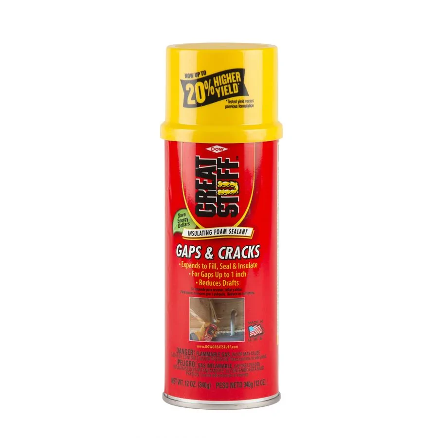

One thing you might want to try is expanding foam insulation inside the rear subframe around where the sub-frame bolts to the chassis (essentially anything tubular shaped). Kelly at BMR turned me onto this. Used a product called "Great Stuff" for home insulation. I have the Delrin subframe bushings...can be a bit harsh. Always concerned about placebo effect but yes the NVH is noticeably reduced. Might be worth a try.
Rebellion
Aug 30, 2016
1,052
273
Houston
2016 Competition Orange GT
I assume this helps on the noise part of NVH...do you have a pic on where to apply the foam?
