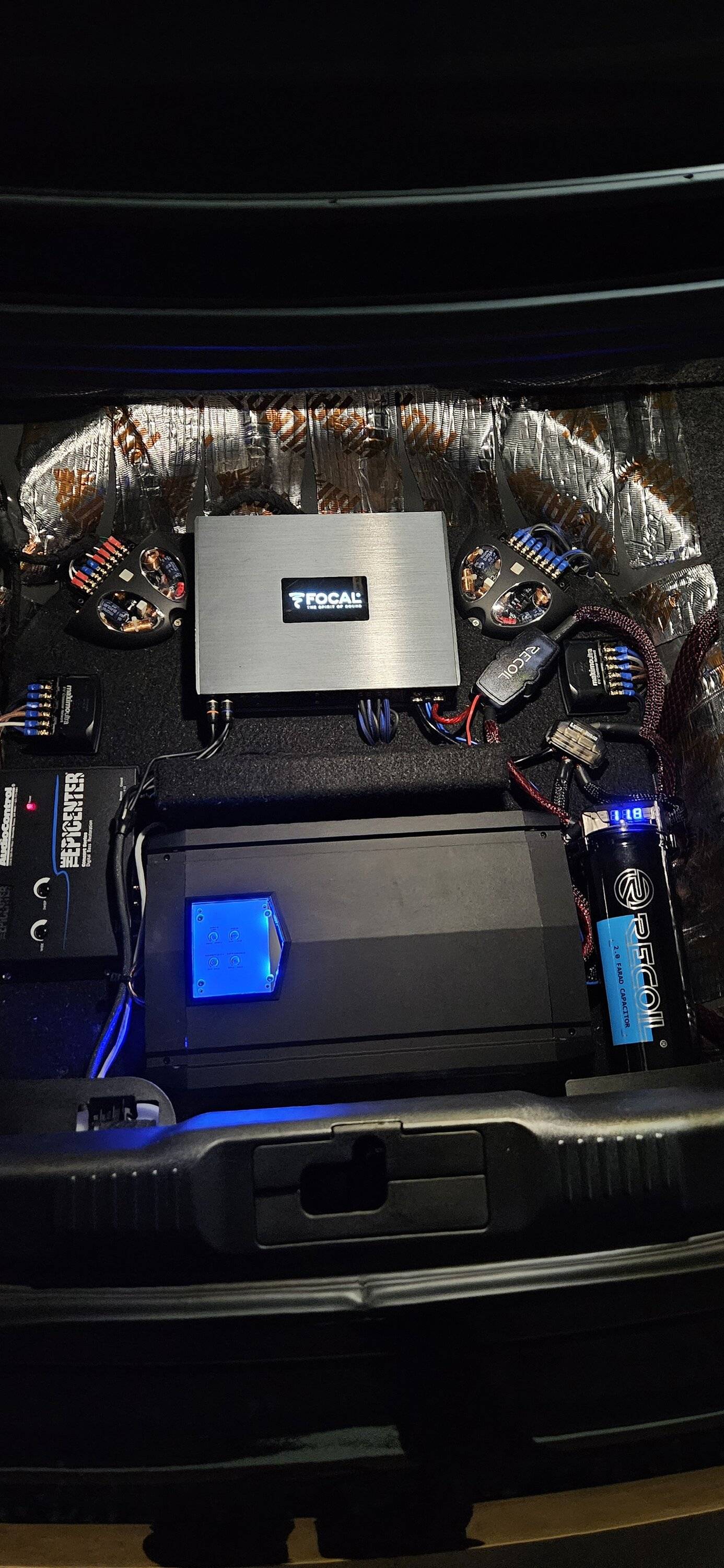

So I just finished my stereo replacement and I'd like to show off the amp rack I designed in the spare tire well. I'd like to do a large oval shape with the chrome pony I pulled off the front grill in the middle. Not sure where to begin, I've never worked with plexiglass before. My thought is to have it under the trunk floor, so I can have a cover that's carpeted...for daily use, and remove for car shows. Any ideas?
Here's the amp rack...

You would need at least 1/4" thick for that. You should buy a small piece and put it in the trunk near the amp and test for high temp impact. I was thinking the same thing as a clear cover to the airbox under the hood. But I think the high temps may warp or crack it.

Use Lexan instead of Plexiglass. It's far more robust and not as easy to scratch. It's good for 265 deg F. Perfect for an amp window or intake cover.

My first concern would be air flow. Your amps need exposure to the air for proper heat dissipation. Enclosing them could cause thermal shut down. If you really want to do acrylic over the rack I’d add a few 12v computer fans to a switched power on circuit in a push-pull configuration.

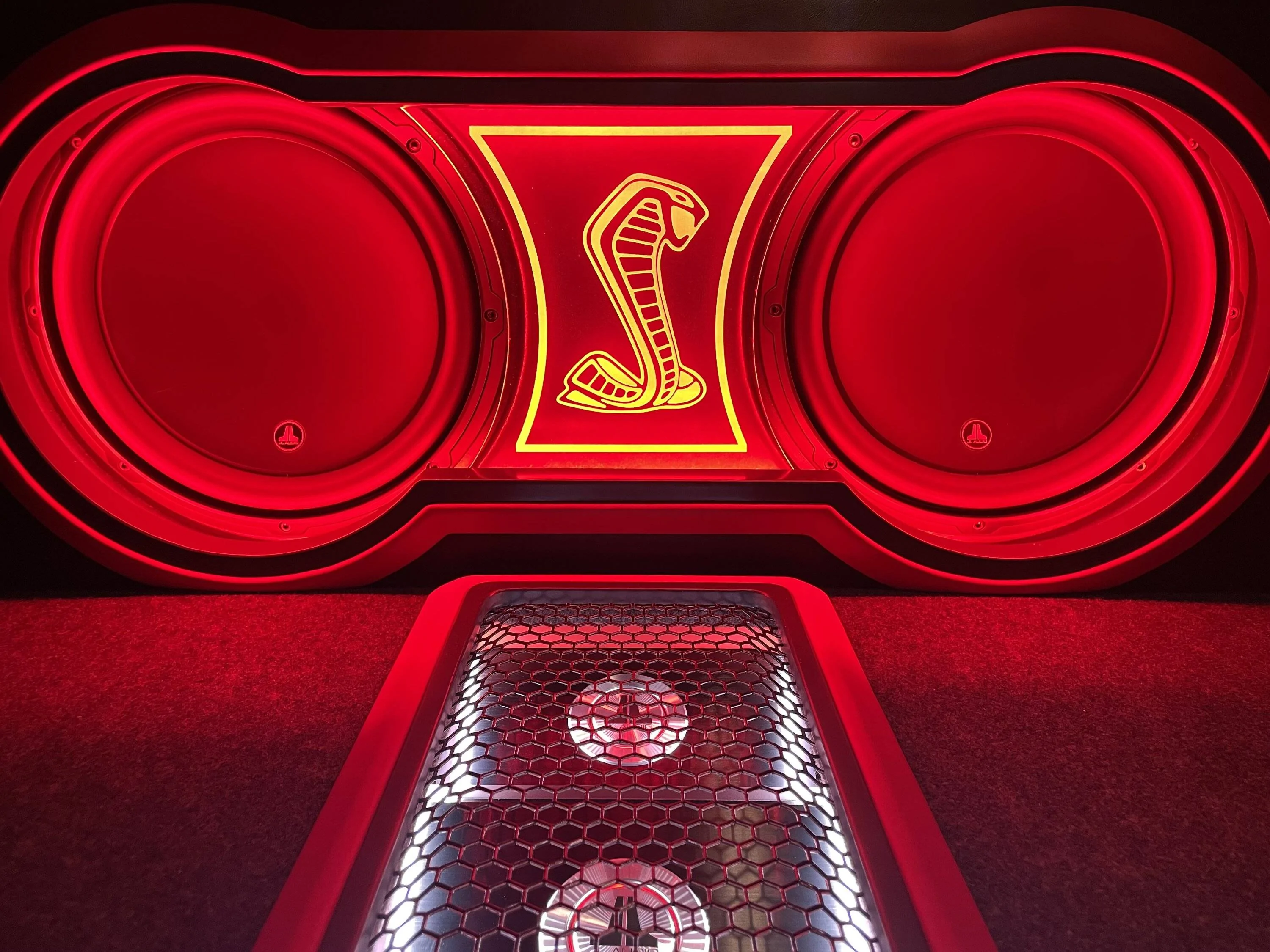

As for how to do it, check out CarAudioFabrication on YouTube, he has a few videos about doing acrylic. But, unless you have a router you’re most likely not going to have a good finished result. Maybe call around to your local trophy shops, they usually have acrylic engravers than can do something like I did.
The snake is etched into the backside of the acrylic and is edge lit from top and bottom.

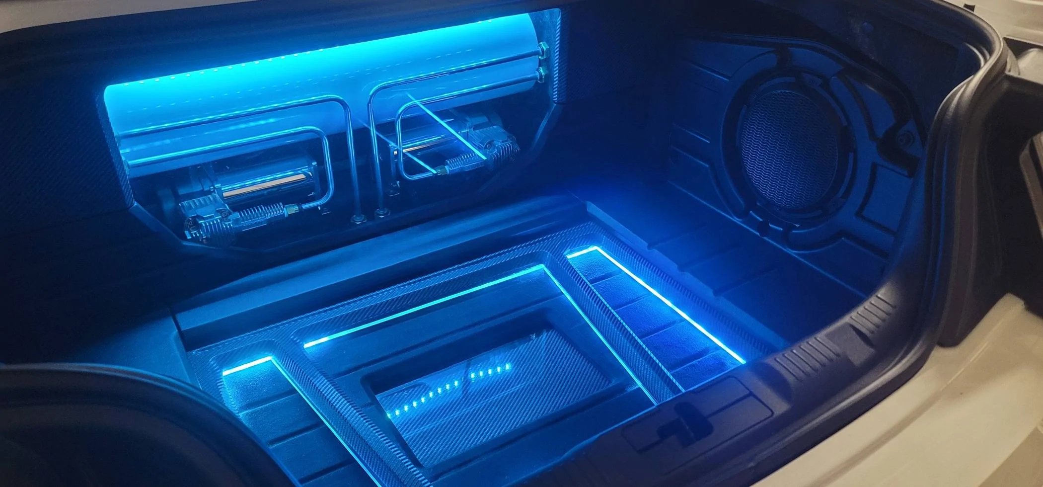

I agree. I tried cutting my own with a router and it was a huge mess. I had a local sign shop cut a piece (though not as big as yours) and had them laser etch it. I just finished this up yesterday. The section where the air tank is,
I cut years ago. I think that one was with a router though. Not sure why it didn't work this time; maybe different type of acrylic.

Looks good! There are two different types of acrylic, extruded and cast. Extruded acrylic is more prone to chips and shatters from cutting and routing. The bit you use is also very important. You want a spiral fluted up cut but.

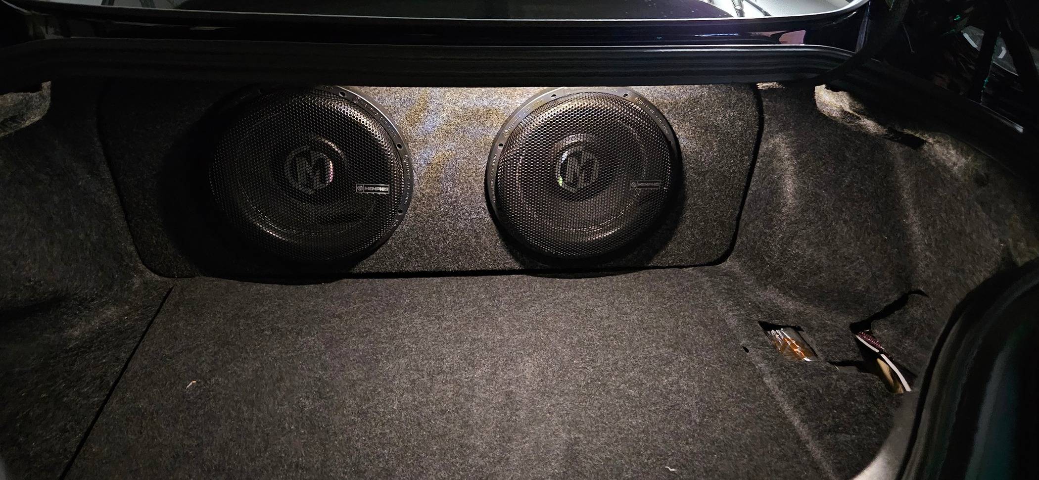

This! I Have multiple pieces for my setup. I have the factory sub and the Meth tank in the trunk and the floor wraps around both. In order to get it to do so and allow me to remove when necessary for servicing components underneath the floor, I couldn't keep in one piece because it wouldn't fit. If you have nothing on sides of trunk, you might get away with it, but test out with some cardboard or material that is stiff.
