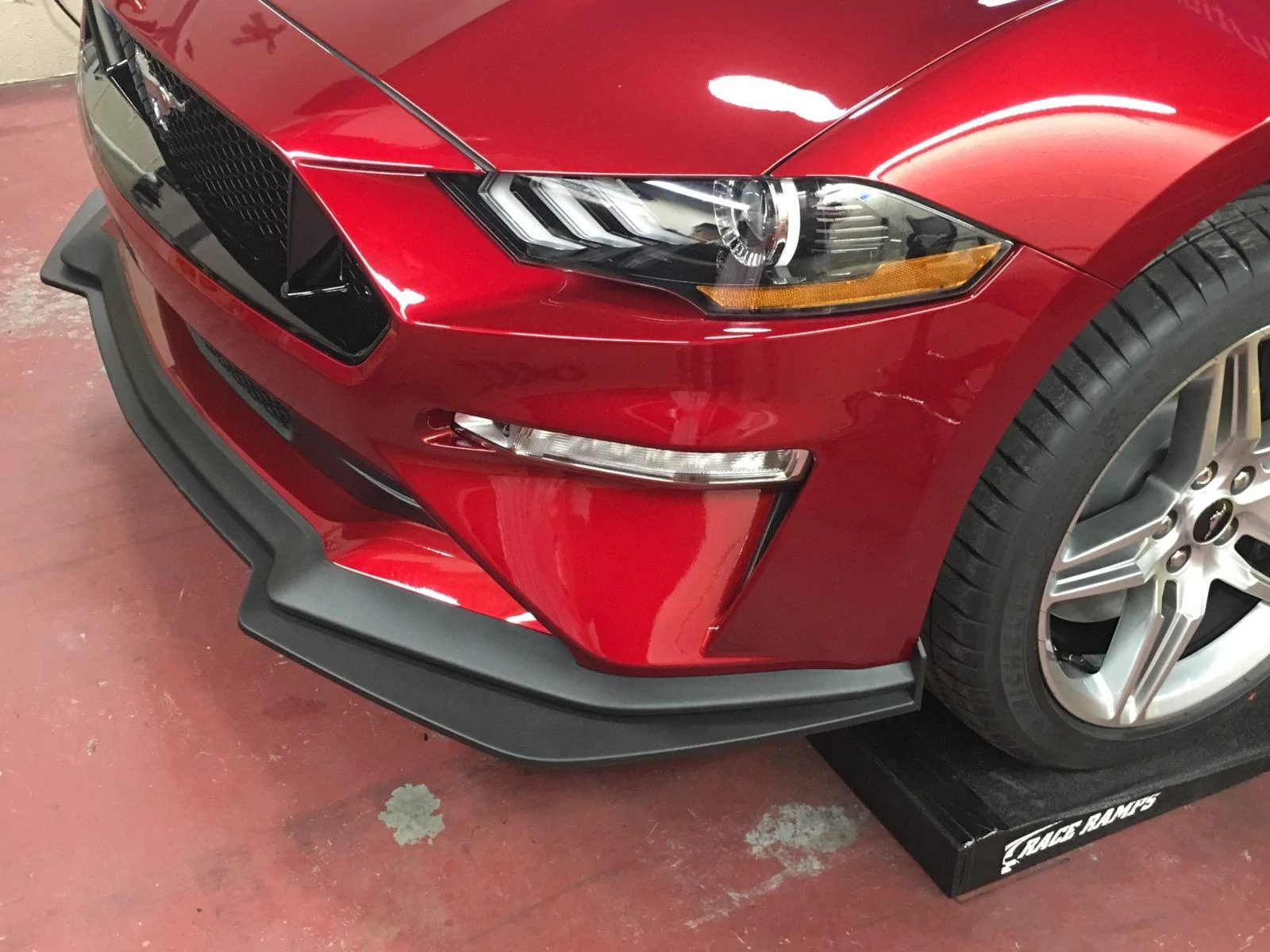

I did this. The PP2 uses a different lower valence. The difference between the pp2 valance is that it has the holes needed to install the pp2 splitter. With that said, I was able to get it to work with my pp1 valence. I lined up the Pp2 splitter with my pp1 valence off the car, drilled the holes needed and it all went into place.

Or check out SBS Performance Parts, they make a splitter extension for the PP1 that is fairly reasonable in cost at $225.
