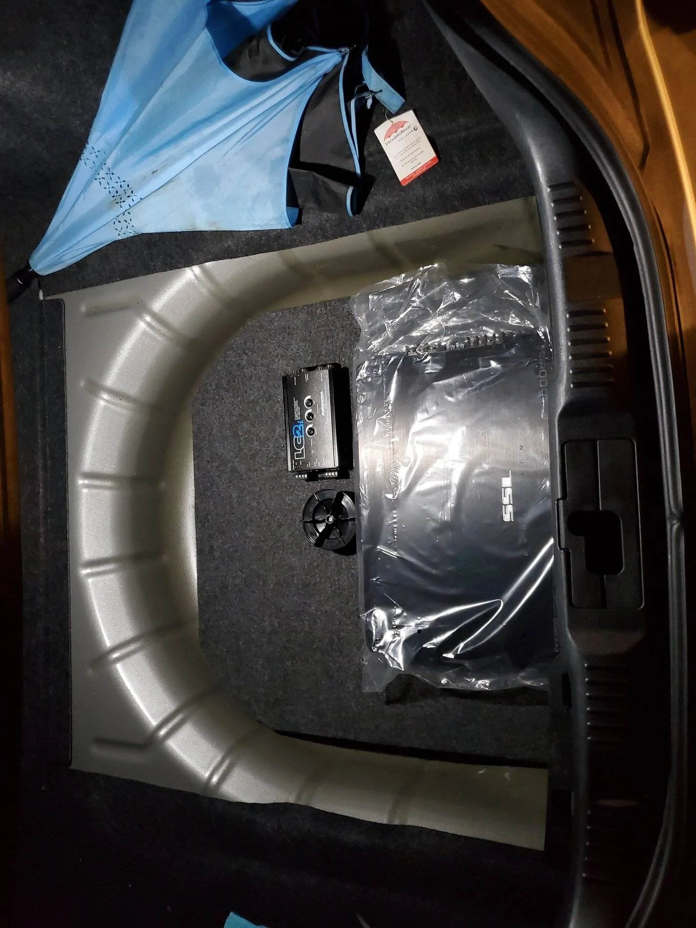

Have alot of down time due to covid and have a bunch of audio equipment laying around to piece together a decent set up. My goal is to have full use of trunk space and have a clean OEM look.
Keeping the factory radio here is what i have.
Things im using
- SSL amp
- AudioControl LC2i (dont need to find a remote signal from factory radio for amp and can set up a second amp for mids)
- 2 way power block
- The usual amp power, ground and RCA's
First i started with thinking of where to install the amp. i decided to put it in the spare tire area. Since there is no use for it.

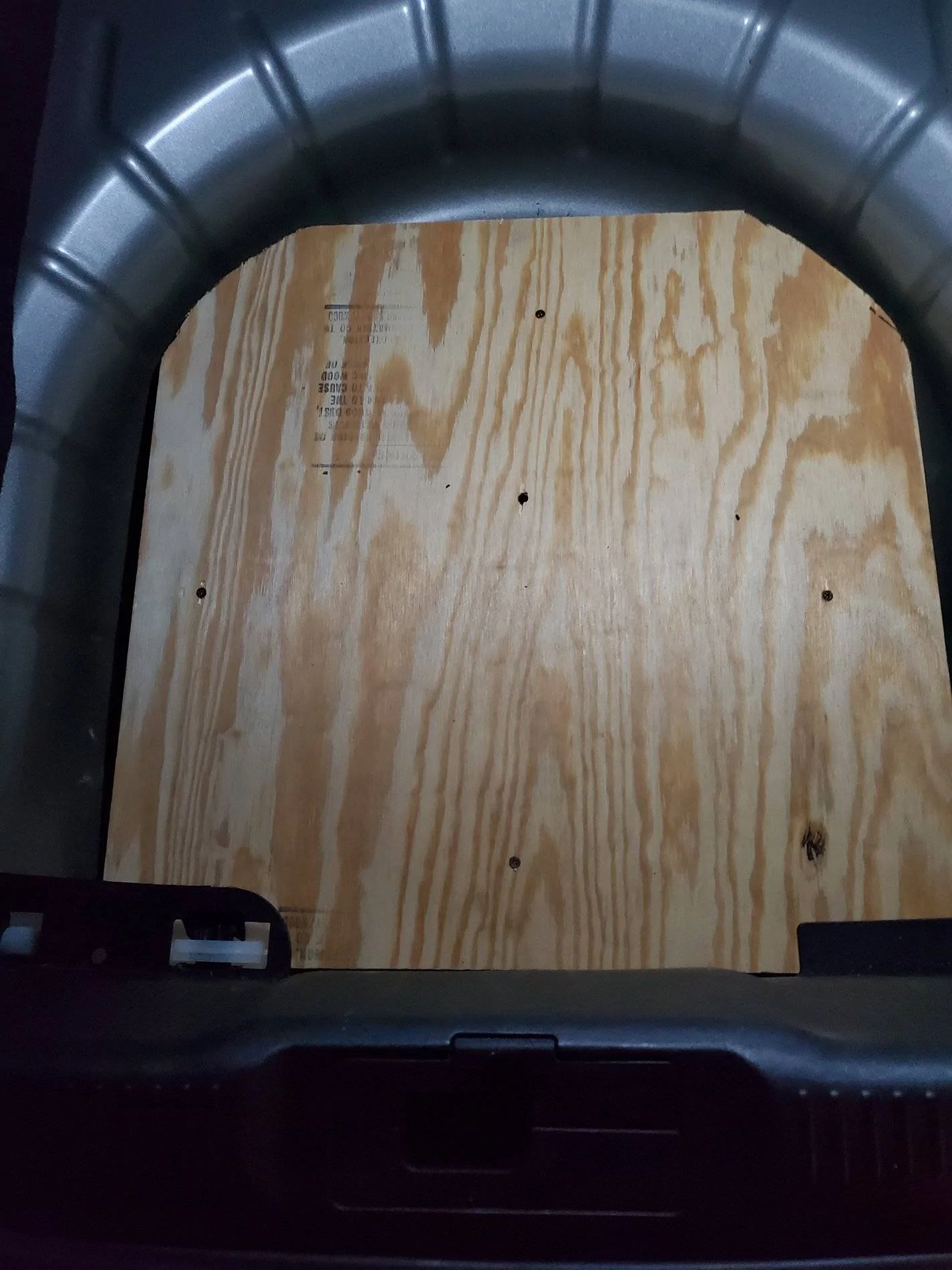

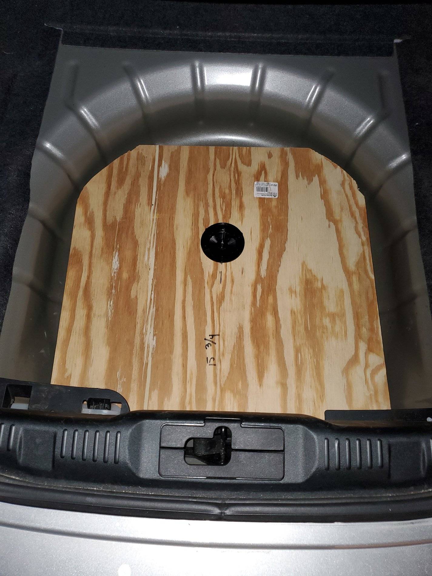

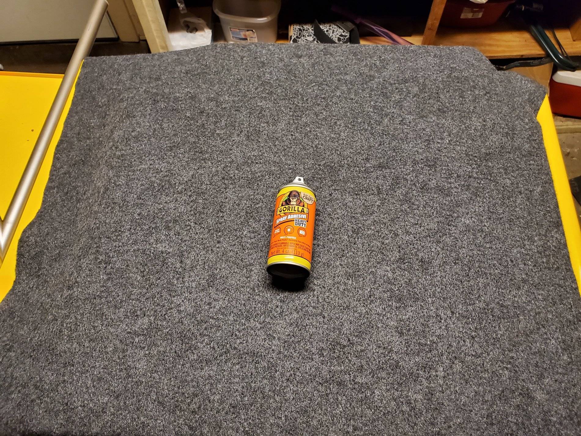

I ended up buying a 24"x 24" plywood and rounded off one side of it for a better fit. Found the and im using the factory hold down for the flat tire kit. Purchased my car used and it was missing.
Purchased some charcoal gray material and some adhesive spray

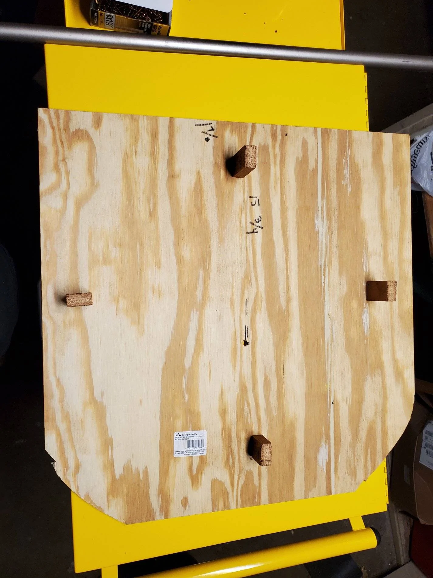

Added some legs to make it more stable
Here is the stopping point for me tonight

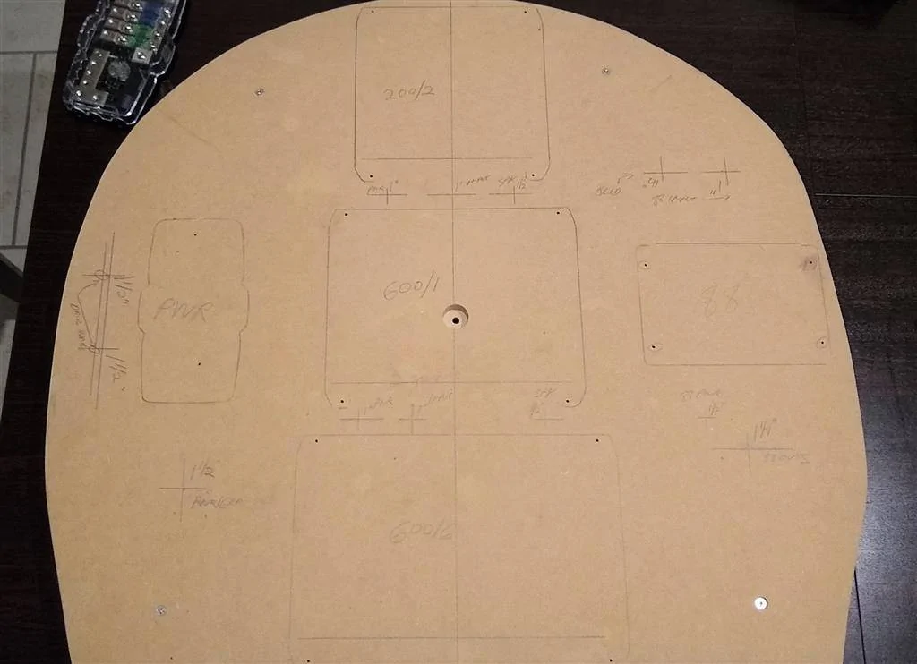

Just a thought: If you drill a 3/4"-1" recessed hole for the bolt to anchor the rack to the spare tire hold down, that would give you some more placement flexibility for components now/later. That big plastic knob takes up a lot of room. Something like this, from the amp rack I'm building. Home depot sells all lengths of 6mm bolts. I'm using a 20mm but 16-20mm should work.

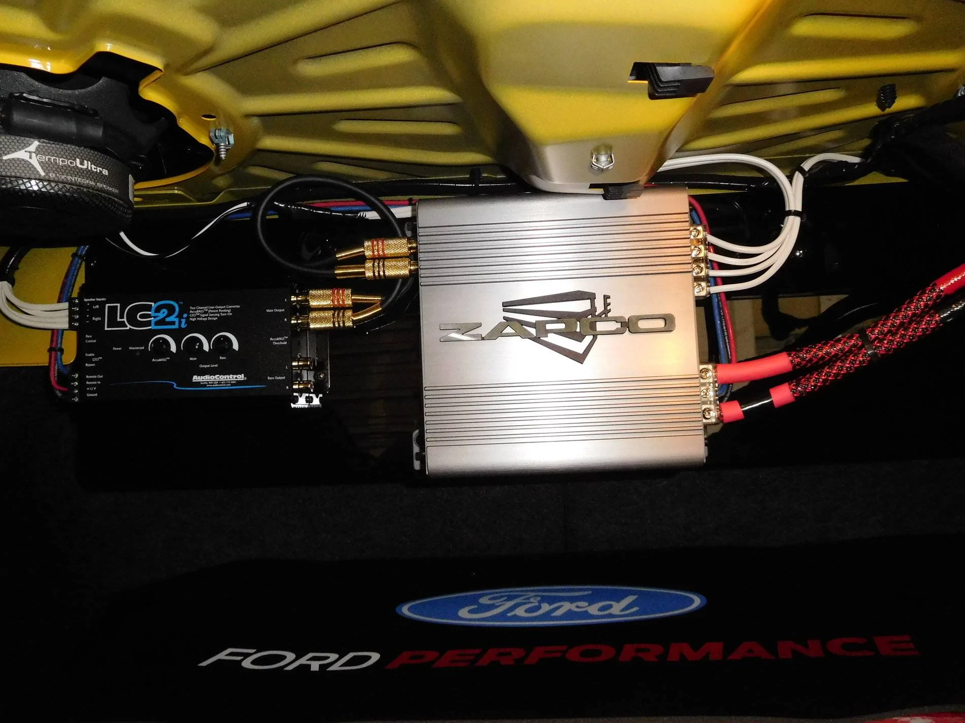

I tucked all my equipment up under the rear deck so I could still utilize my spare tire compartment. I mounted everything to some black lexan from Tap Plastics.
