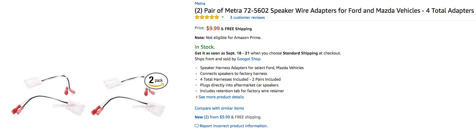

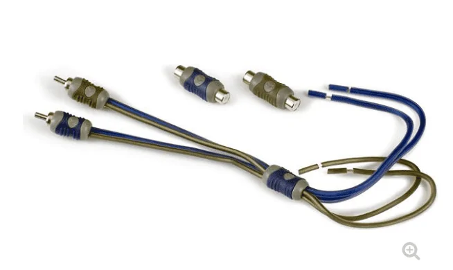

If it has speaker level inputs you don't need the LC2i. But your not just tapping one speaker. You need to tap both rear speakers. I did something similar and bought these wire adapters on Amazon. The picture is not exactly what I received. The connector actually had four wires. I just cut the two wires that weren't being used and attached the speaker level inputs.
The second pic is the RCA to speaker level input.
Thanks that makes option one a bit easier!

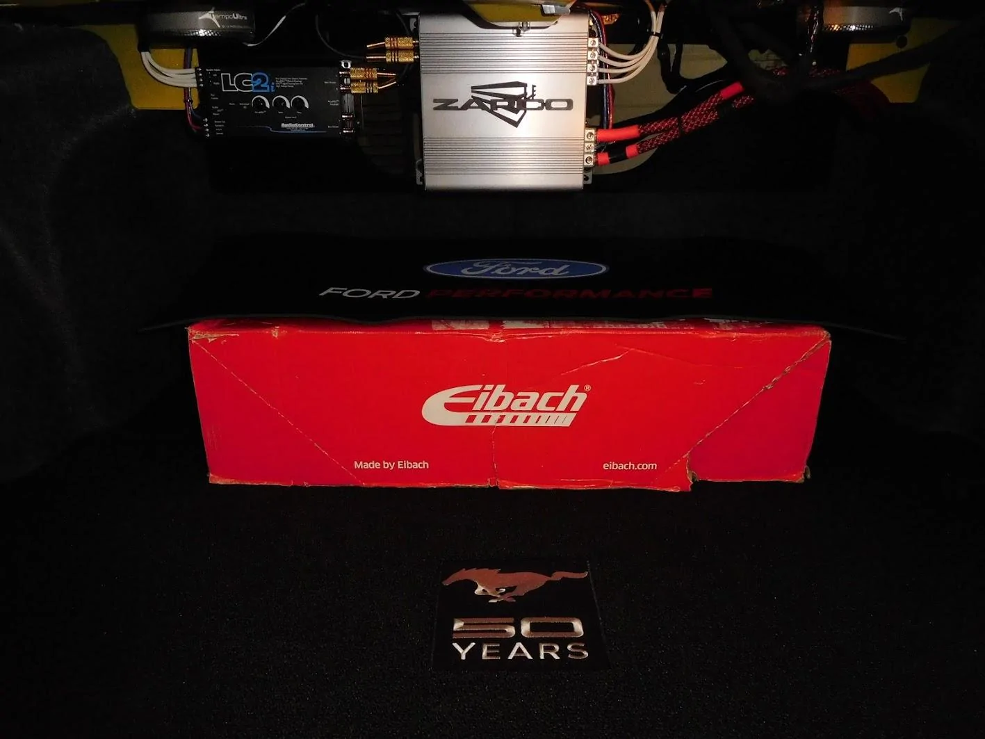

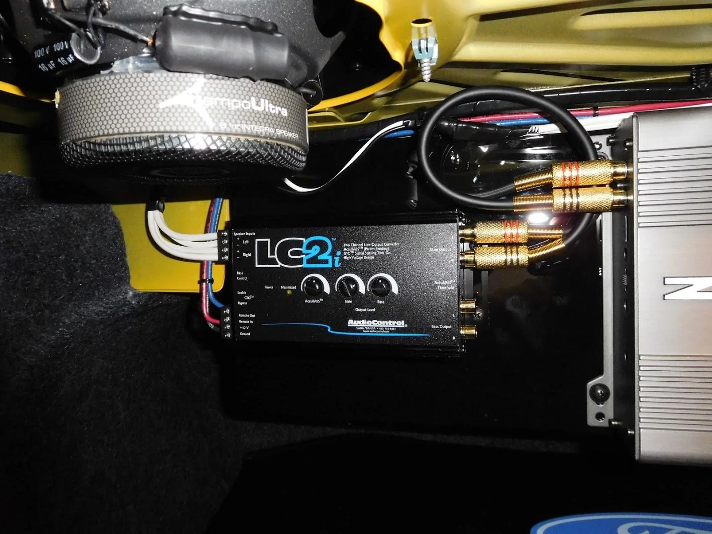

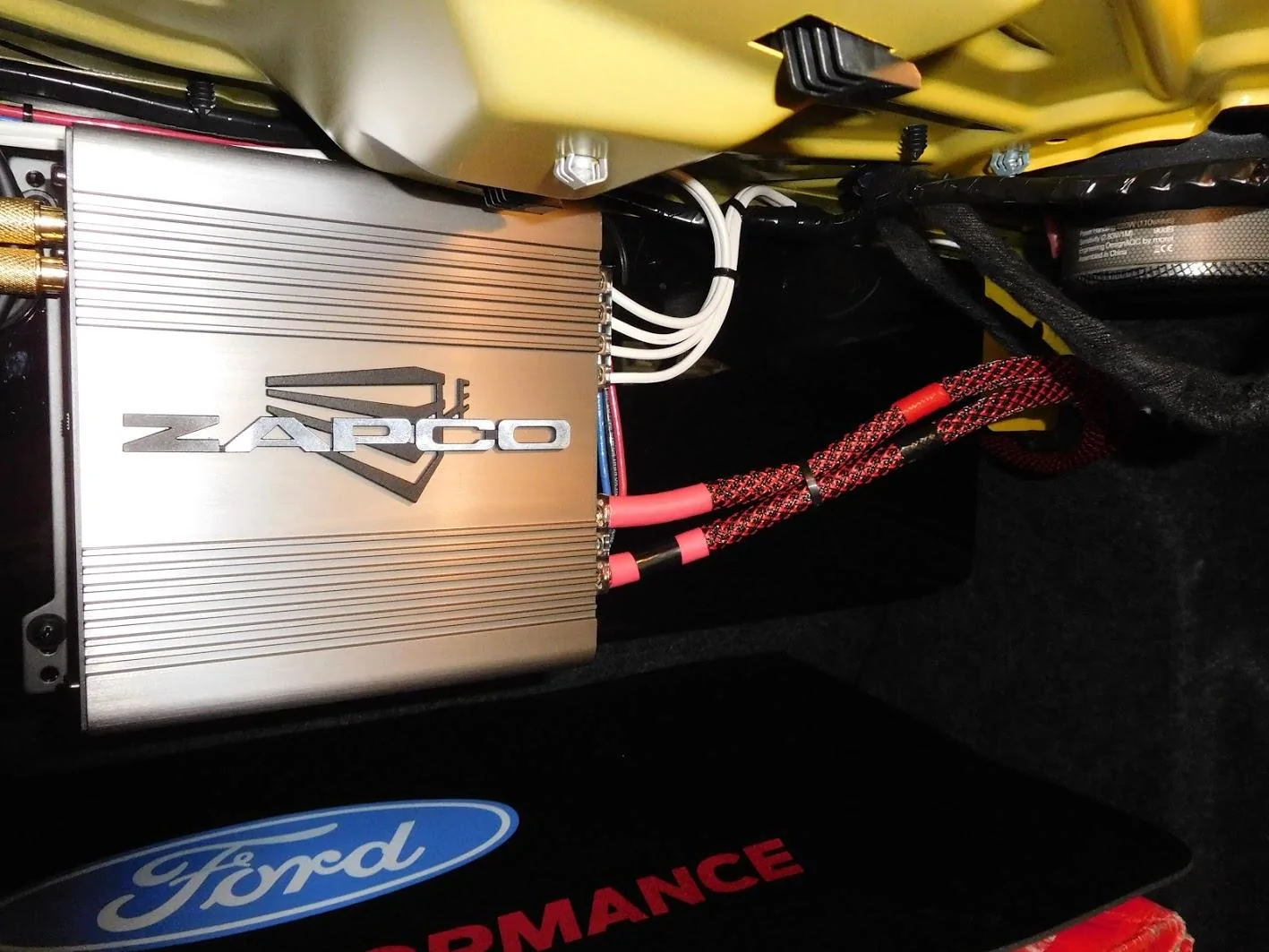

Here's my set up. I replaced the 6.5" rear deck speakers with Morel Tempo Ultra 602's, speaker level inputs to an LC2i and pre-amp inputs into a Zapco ST-2D amp. After some adjusting of the pre-amp out puts on the LC2i and a slight bump on the gain on the amp I now have a balanced sound system and the fader works as it should. I left room on the plexiglass plate to add another amp that will power a proper 8" sub by-passing the factory sub amp.

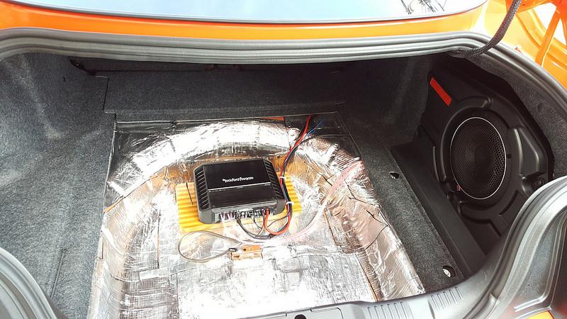

I used the speaker level RCA connectors as above.
i used a Rockford P300 amp and a RF P3D2-8 sub.
