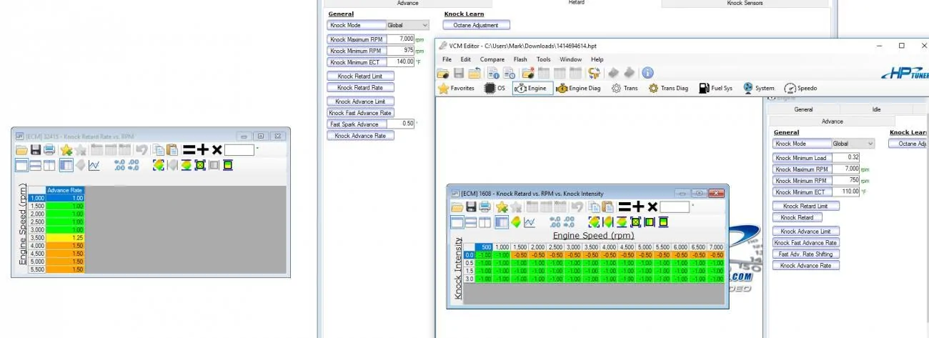

Whipple assured me that the normal or borderline knock logic that maximizes timing for power is in the 2 degree range. Beyond 2 is when and power is reduced significantly.
I think this is thinking from 11-14 ECUs that should not apply to the 15+ ECUs. Stock the retard rate was 1* per knock event below 3000. Above 4000 it would be 1.5* per knock event. Saying up to 2* positive knock allowed it one last chance before the transition from Knock advance mode to Knock retard mode.
I commented on Alex's video to see what he says about it but no reply.
Again ford added an intensity axis to the table that replaced this knock retard rate table being based just on RPM. Now you don't want more than 0 knock, this will keep the system with in .5 of true borderline for the fuel you are running.
Adding a picture from HPT for a visual of what I am saying.
Interesting...so you think Whipple has it wrong and is referring to 11-14 knock logic?
By the was love Hawaii. Was stationed at Kaneohe Bay Marine Corps air Station from 86-91.:thumbsup:
That would be my guess. They may have found 2* at wot at the top of the rpm produces best power on the dyno from the 11-14s and may not even realize Ford added an intensity level in the 15+ ecu and this idea no longer applies. Unless their tunes flash a 11-14 strategy on to the 15+ cars they are selling their kits to which would be unlikely.
