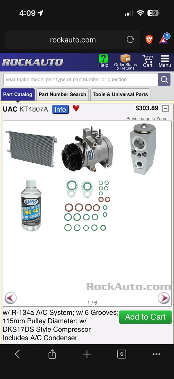

It’s a 2016.
Sounds reasonable to me that everything needs to be gone through if a blockage is the case.
Looking at Rockauto they’ve got all the parts to change everything for a reasonable price. I know some would balk at replacing with non-Motorcraft, but considering the reputation of the AC systems in these cars, how much worse could it get?
For 303 bucks I can replace all but the lines and the evaporator, plus the cost of adding refrigerant back in. The condenser has a built in drier. I’m not sure if replacing the compressor would be necessary though, unless it is coming apart. That said, I’d be in there disconnecting everything anyway, so what is 3 more fasteners and a belt?
Gonna check around the evaporator drain with a UV light later when it’s darker and see if there’s anything glowing. I sure as hell hope not, I don’t want to have to rip the dash out!
