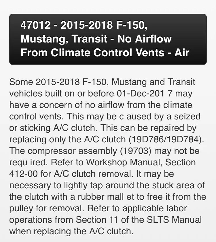

If you are still within the 3/36 or have an extended ESP Warranty - it should be covered. However in the event it’s not, here’s the info you need:

Because of holiday travel commitments, I was hoping to replace the compressor after I got back home to the bay. The compressor clutch decided to melt and seize the compressor while I was on the highway on Christmas Eve, which was awesome. I turned the damn defrost on and didn't think anything of it... fatal mistake. Oh well, new compressor is in now and all is right with the world.

I have 3 months left on my 36k so I will be checking this tonight. Does that TSB posted above cover us if after the bumper to bumper is up?
