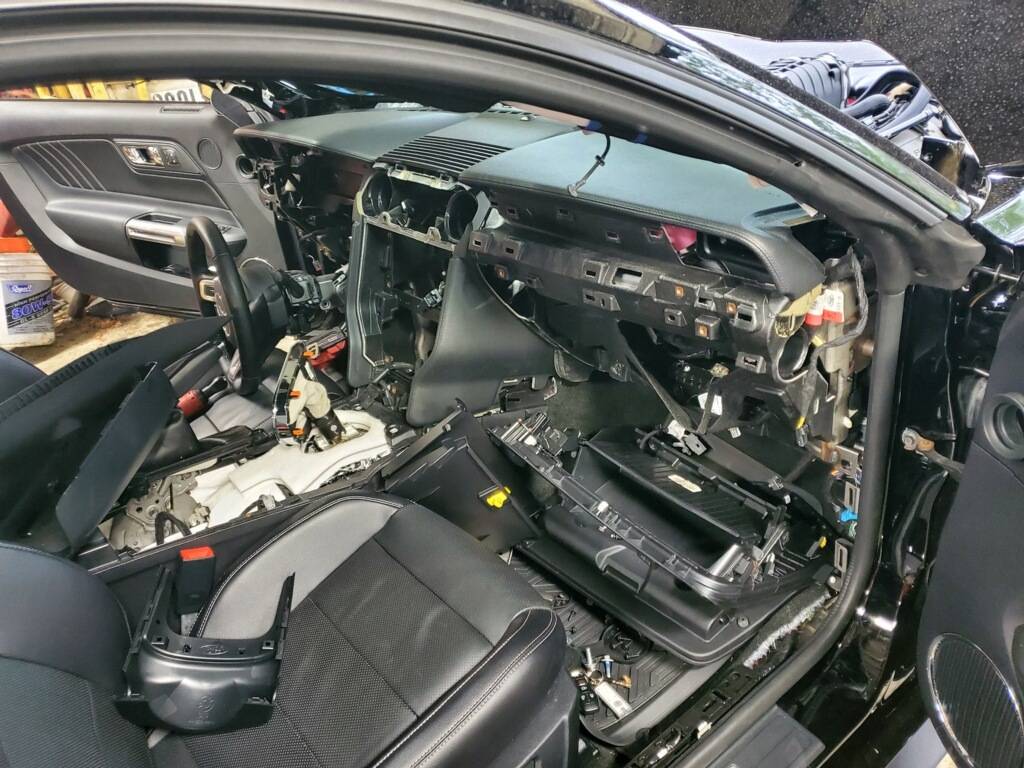

What your car will look like if your AC Evap and compressor fails.
Elp_jc
May 2, 2020
48
3,527
807
None
Man, there's no f***ing way that car will be put together like it was before. OP, your car is still within the mileage warranty, and only 4 months out, so it'd be unbelievable if Ford doesn't at least eats half of the repair cost when it's for a known issue. I'd fight for that like hell. In fact, ask for the whole thing to be covered, so it settles at half as the worst case scenario. I would not want to keep a car that has to be dismantled like that. Geez.
