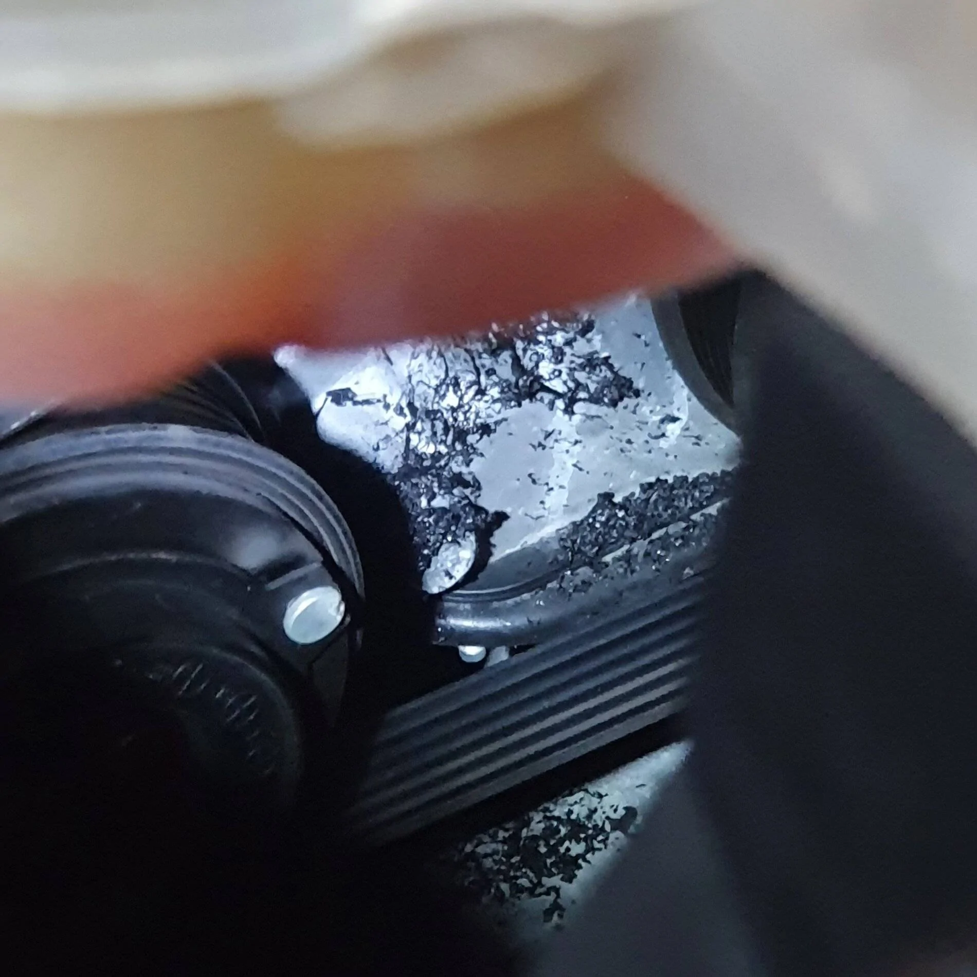

Driving down the highway yesterday I noticed a burnt metallic smell, thought it was a semi but got off and seemed to be coming from my car. When I started it again I had no AC.
After further investigation theres burnt up metal all under the compressor (clutch material I'm assuming). The inner wheel does not turn when the AC is turned on. I can lightly spin it with the two fingers that I can get on it when reaching down there.

Typically when a compressor kicks the bucket, they do us the service of sending metal throughout the system in the seconds before seizure. This will mean a new condenser & accumulator, and a thorough flushing of the entire system. Hopefully it didn't stuff your evaporator full of compressor guts. I've read many instances where the evaporator was successfully cleaned in place.

Whoever looks at it will determine the cause when they take the clutch off. I've never seen it, but I suppose it's possible that a malfunction / piece of debris smoked it, but a burned clutch is normally caused by a compressor that refuses to spin. All I can offer from this distance is a guess.

What does it mean that I can spin the inner spindle by with the two fingers I can get on it? Seems like thst would indicate the compressor isn't seized but I dont see why the clutch would abliterate itself...
