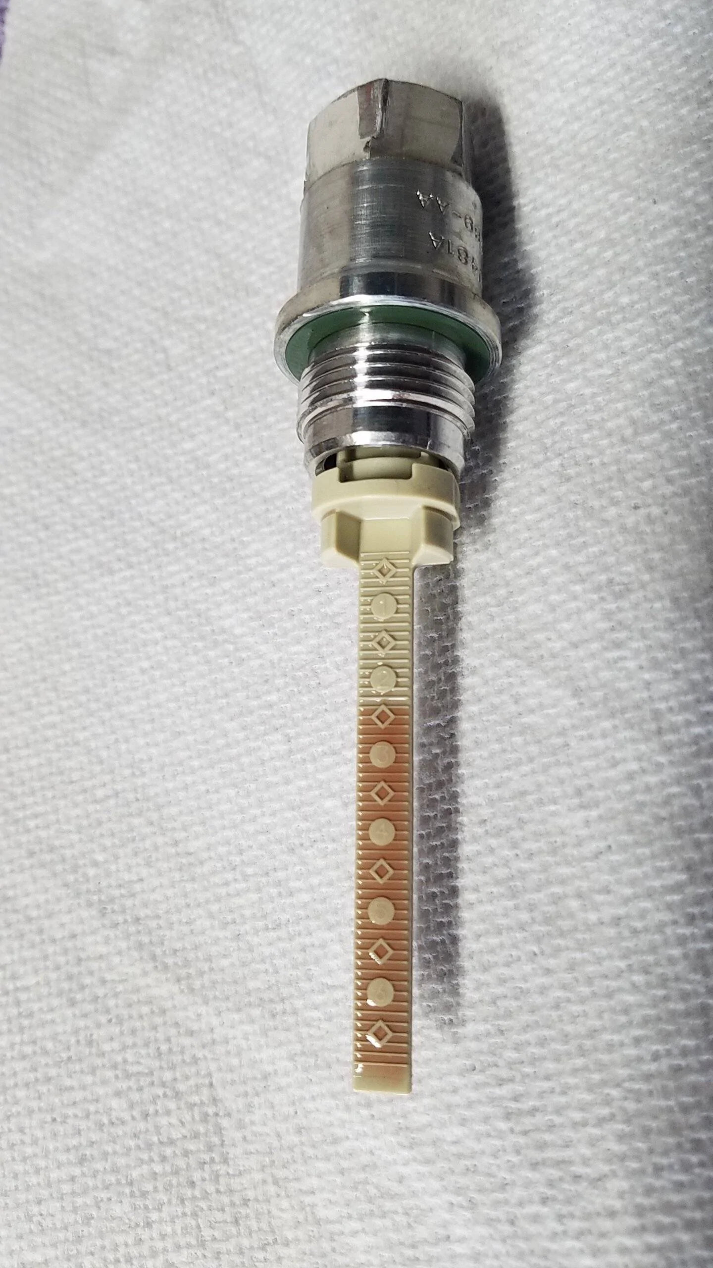

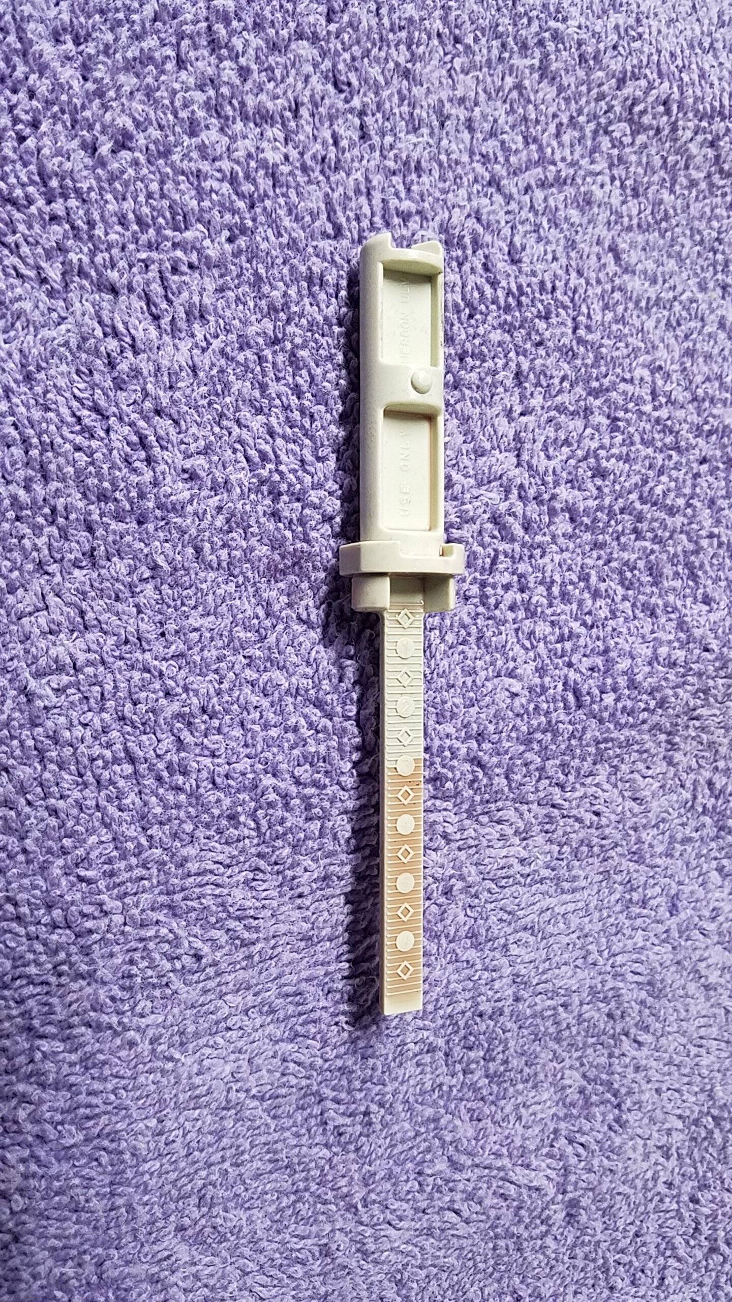

This thread discusses the (2) very different 10R80 dipsticks - thanks to @leonrudi and @speedup for their findings!):
https://www.mustang6g.com/forums/threads/a10-fill-plug-impossible-to-remove-help-plz.141548/

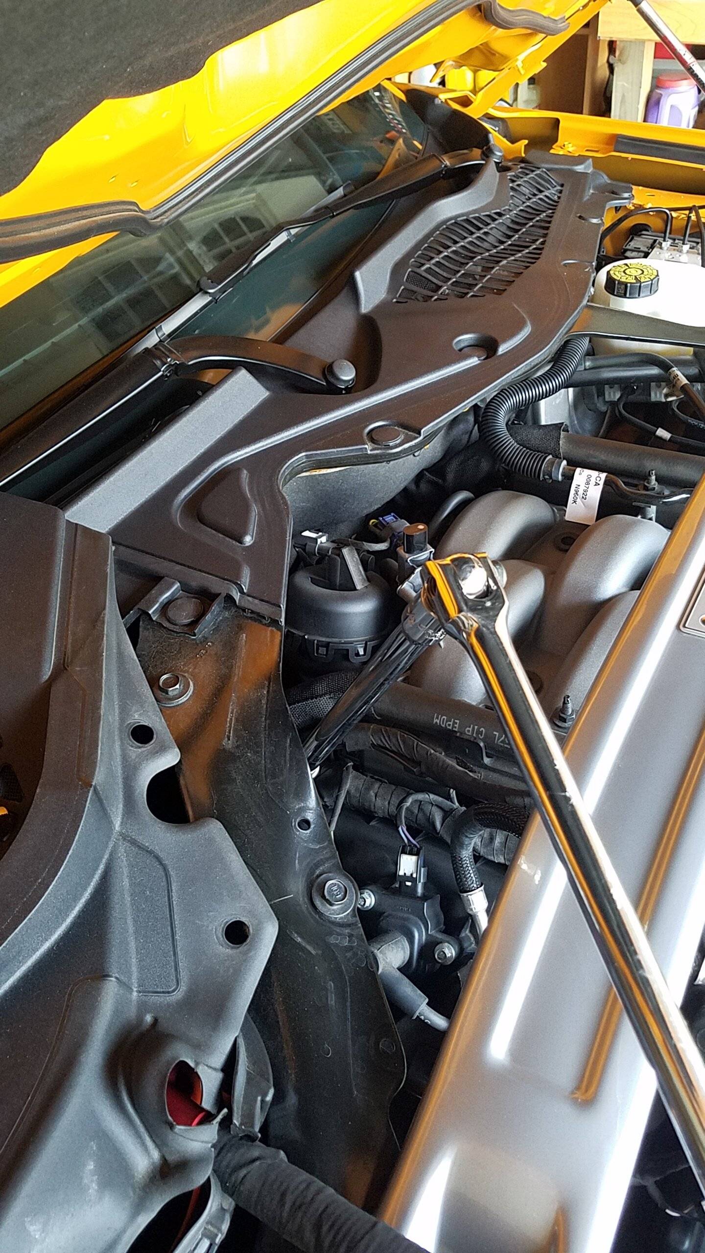

I went in from the top. Back passenger corner of the engine compartment downward . I had to use about 2 1/2 feet worth of extensions, a ½” drive six point Flex socket, a universal adapter on top of that, and it probably took 70 or 80 foot pounds of torque to get that thing broken loose. And it let loose with a bang.

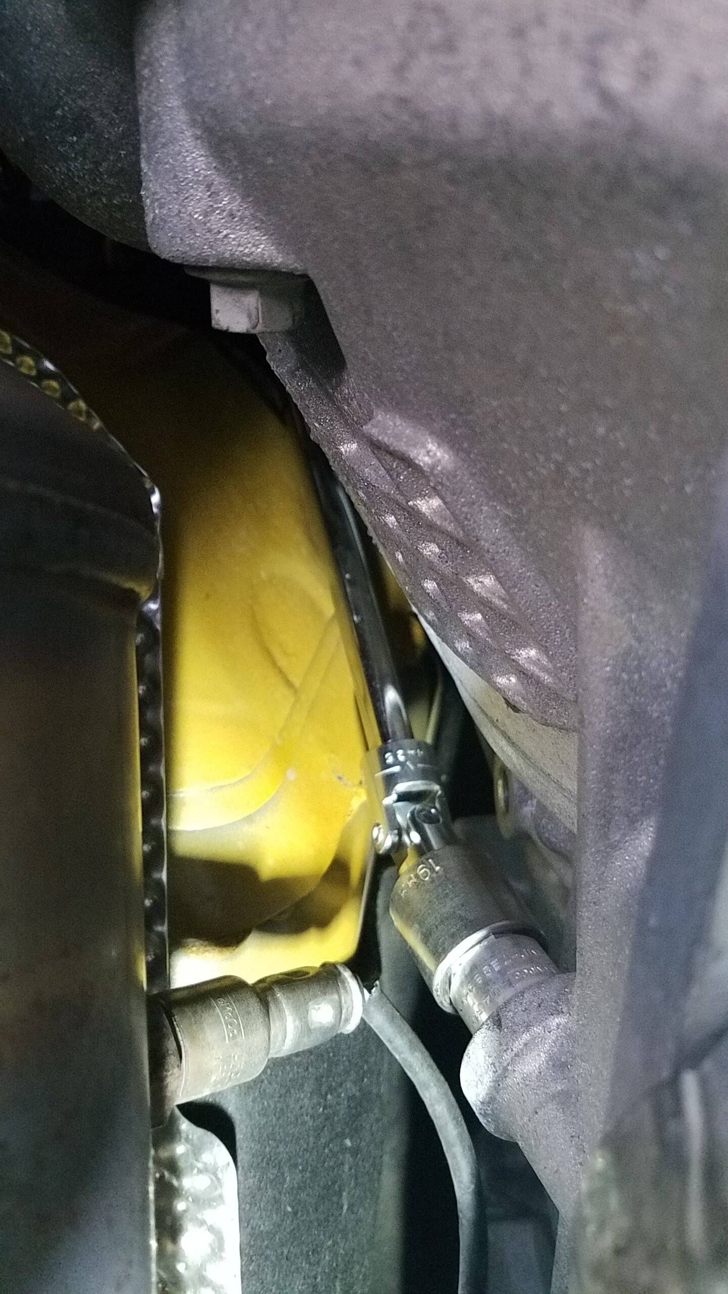

note, I did the dipstick removal with the car on a lift, but had to go in from above. Fluid addition and checking was done from beneath. Used a siphon hose....very, very messy.
I agree with all the above. At least 2 feet of 1/2" extensions, 6-point 19mm socket, U-joint on the socket, breaker bar at the top, counter-clockwise to unscrew, and expect a pop/crack sound. A helper can hold the heavy stackup from above while you guide the socket onto the fill cap.

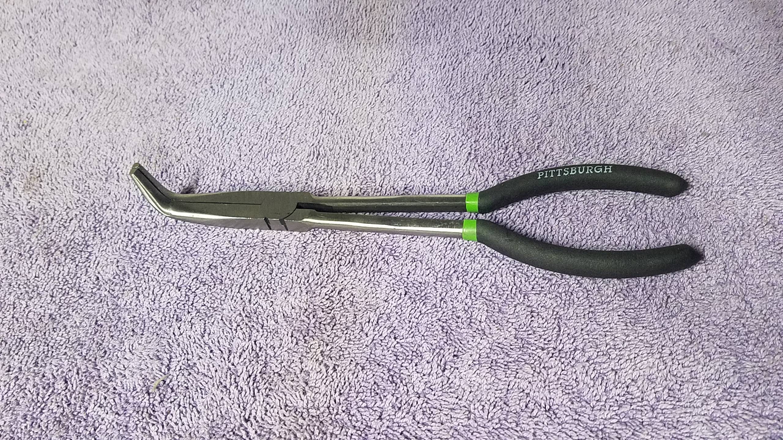

  2. Use long-handle bent nose pliers from below to dip the dipstick and get a reading. Keeps your hand away from the exhaust.

Came across the photos I took, and posting them here.
Access from above - entry point
Guiding the 19mm 6pt socket and U-joint onto the filler cap. Note the view is slightly from the front looking to the back of the car.

Dipstick level, trans is cold, and engine is off.
This is the WRONG way to check final ATF level, but it may serve you as a convenient reference point.
Dipstick level after adding 1/2 quart (due to second trans cooler mod), somewhat warmed up, and with engine running. Level = 3.
This is the correct method, and correct level.
Pliers used for dipstick to prevent hand burn.
