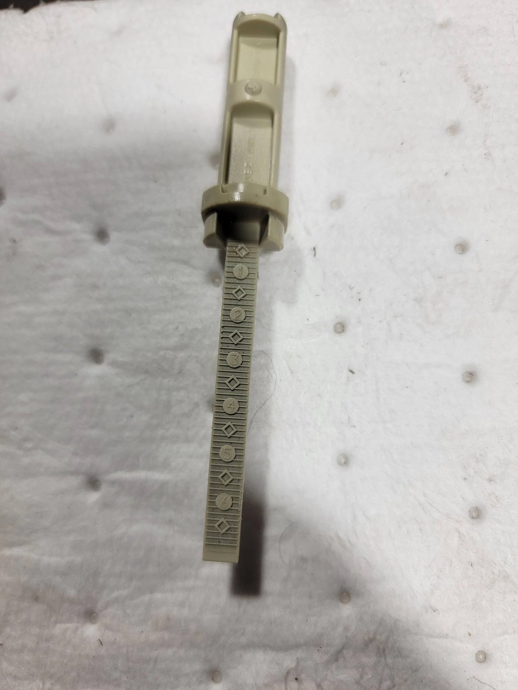

My dipstick is labeled 1-6. The level is at 5.5. Does anyone know what the right level is supposed to be on this dipstick?
