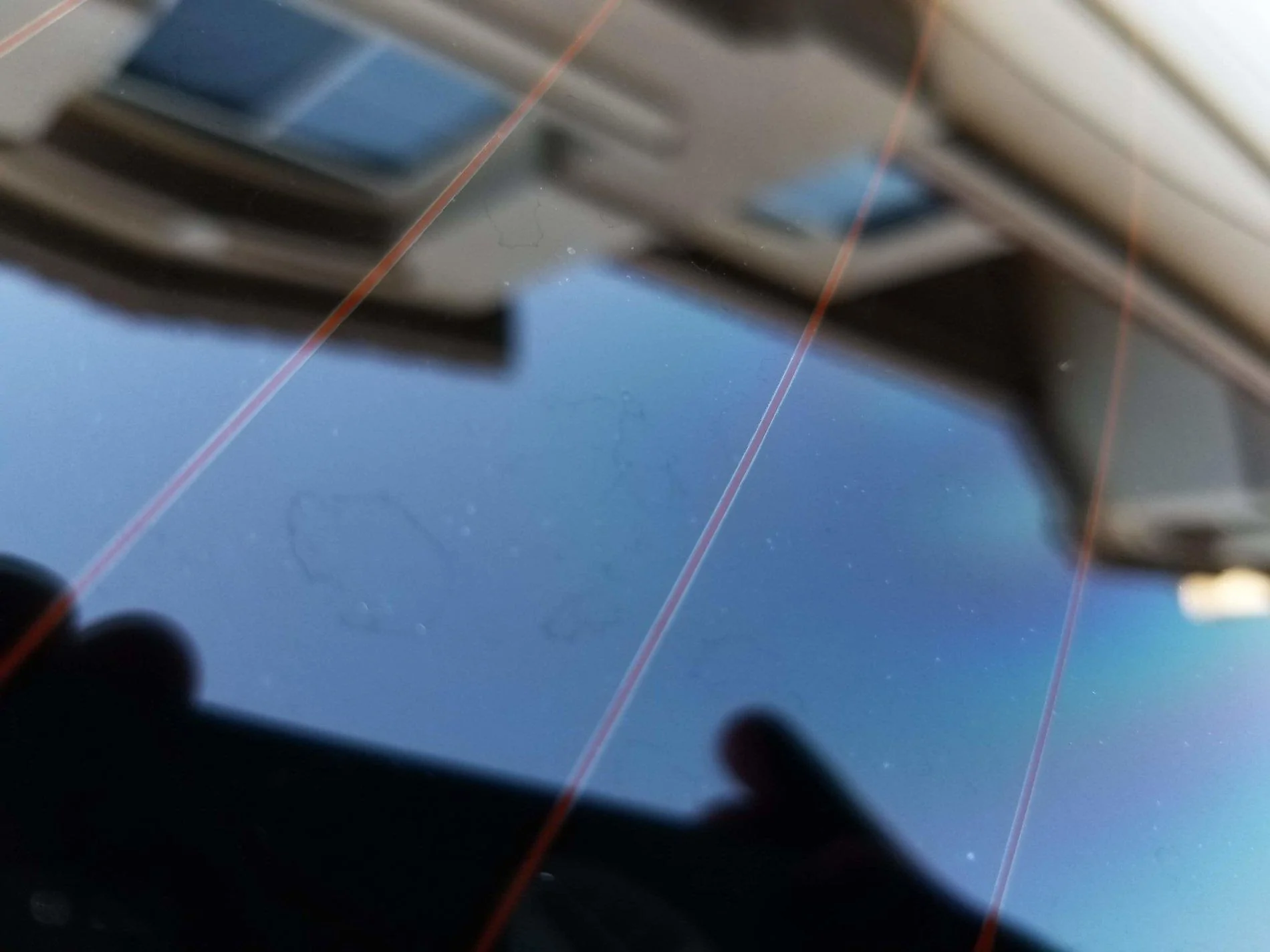

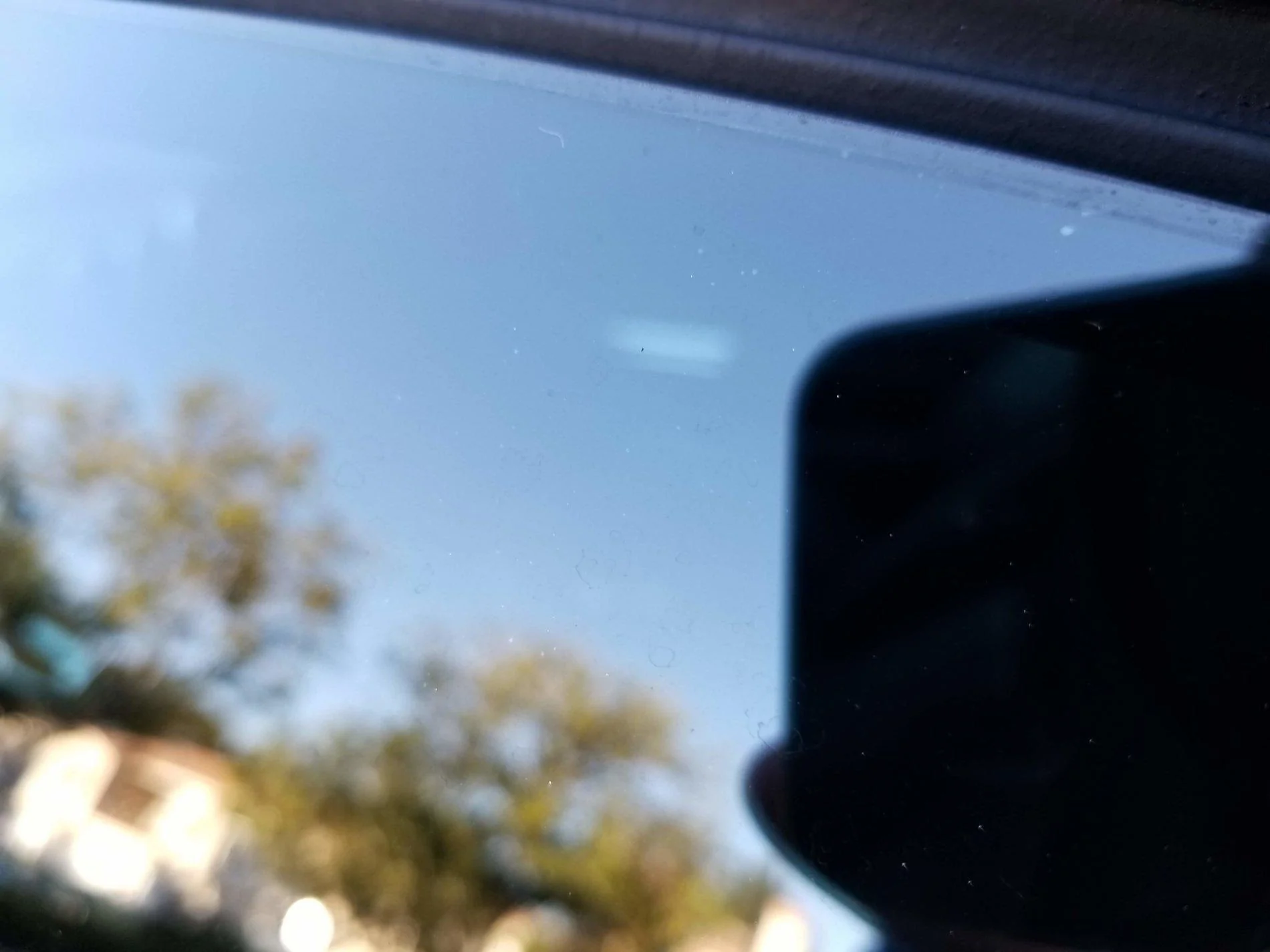

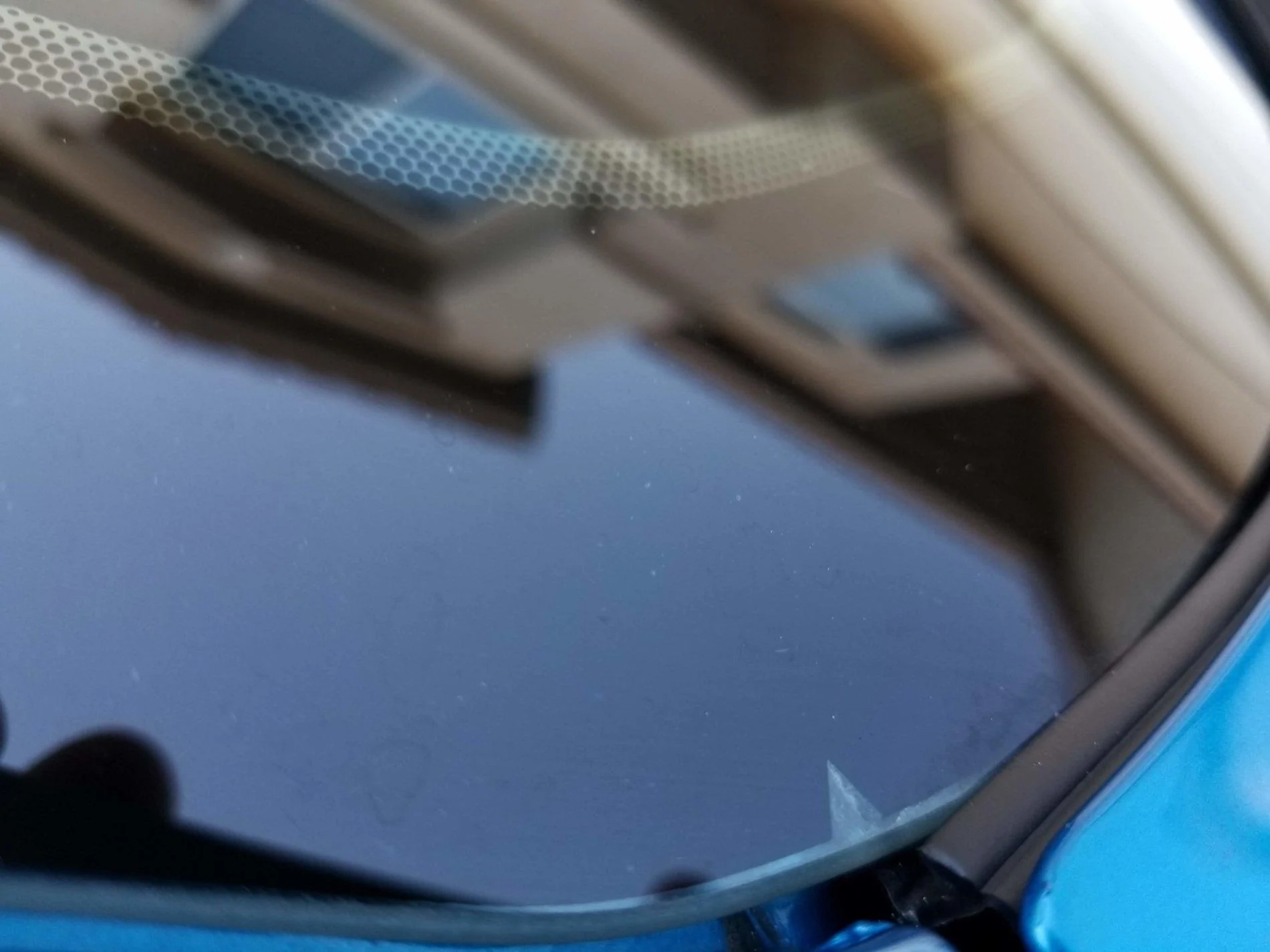

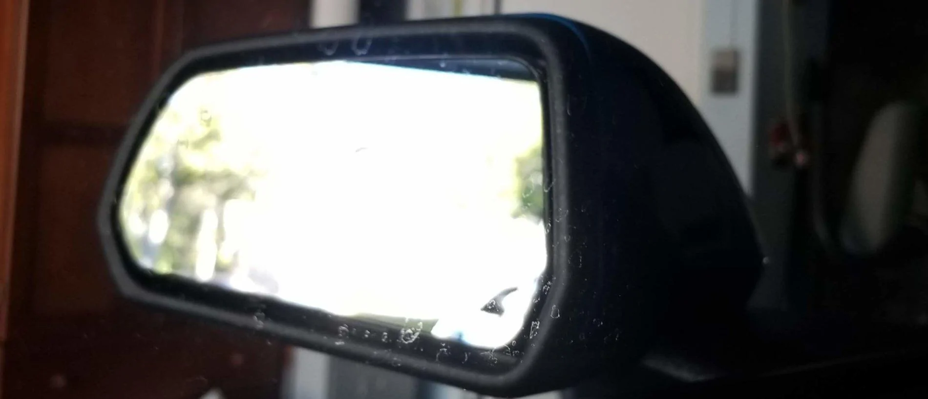

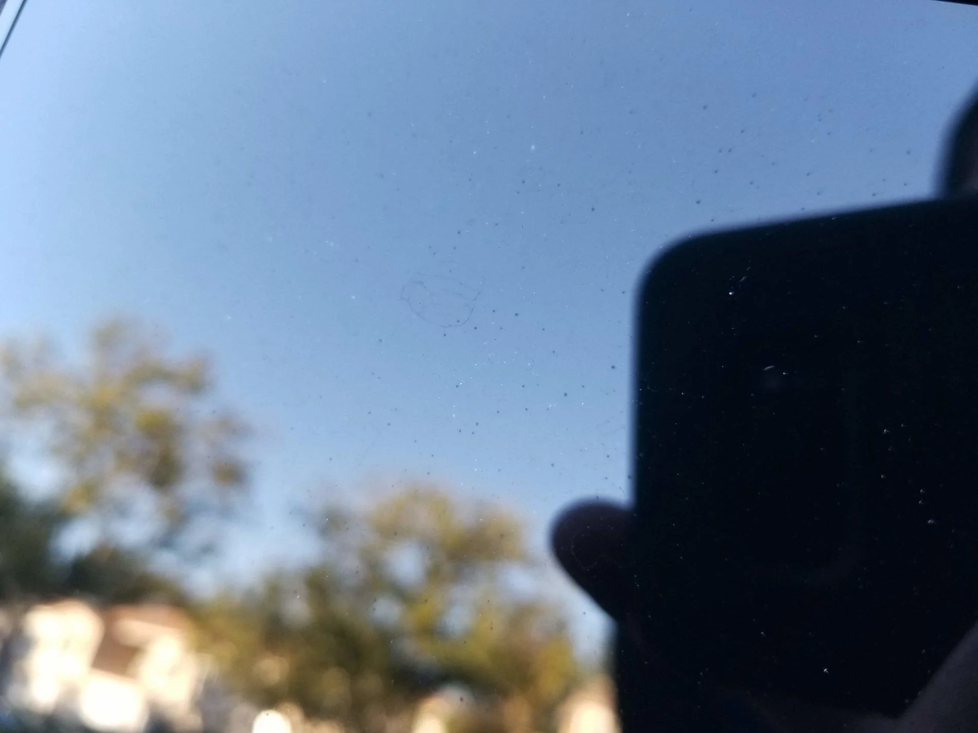

I've noticed on every window on the car, there are what seems to be water spots? Or some sort of spotting? It will not wash/wipe off at all. I can't tell if it's interior or exterior, but I am assuming it's exterior since I have tint on some windows with the spots and some without. I tried to get some pictures of it, but it was extremely hard to pick up in camera. I know it's probably not any help, but I wanted to give an example of something at least. Do you think this is where a clay bar would be necessary on the windows?? I have no clue what else to try.

What you're seeing on the glass is one of two things:
Mineral deposits left behind when water evaporates.
Or, if the deposits are left on long enough, they can actually etch the glass.
My guess is that it's the former. An acid-based water spot remover will dissolve the minerals so they can be wiped away. I like 3D's Eraser water spot remover. You should be able to find it online. You MUST follow the directions. Leaving water spot removers on glass too long can cause damage as the acid will eventually etch the glass. Used properly, it works great with no damage.
If those spots are etching(and again I really doubt they are), you'll need to polish the glass to remove them, and that's a pain in the ass and messy. A special compound and pad for glass polishing is needed.

Thank you! I will look into the product you recommended, hopefully that's what is going on!
