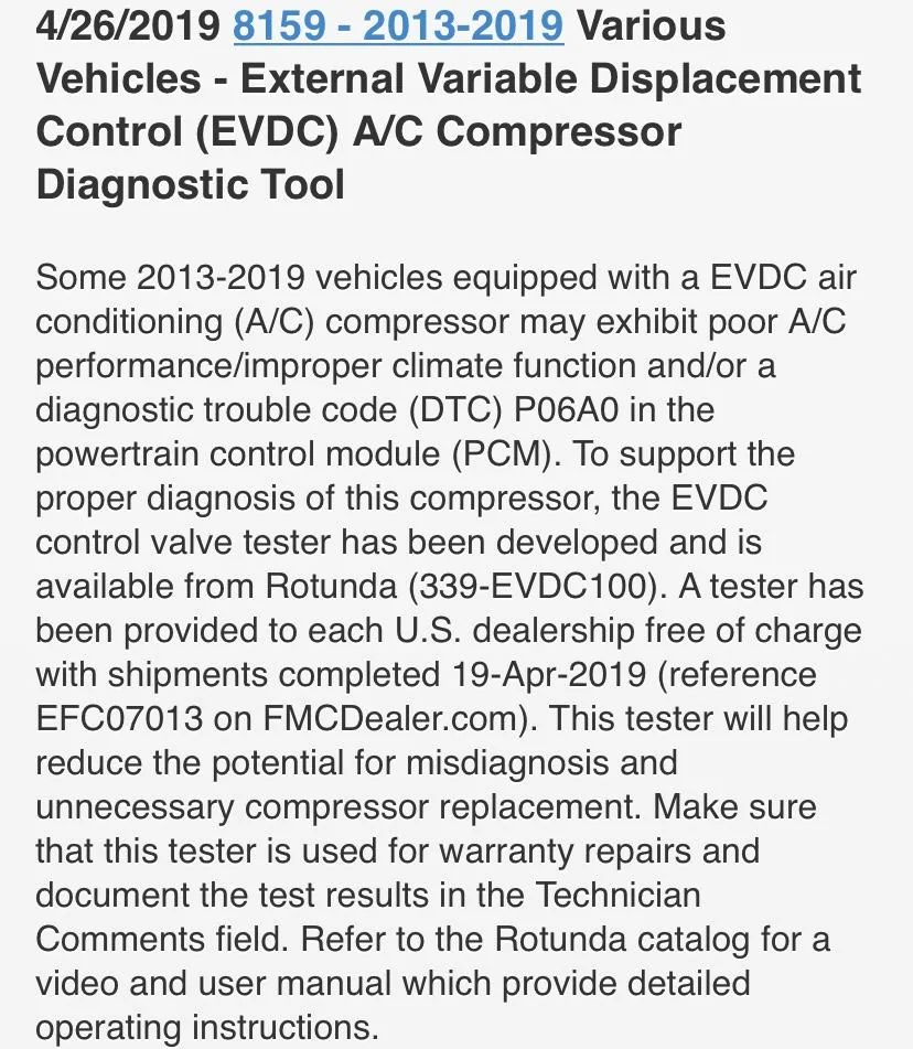

This SSM was just released a few days ago. I’m not sure if this is applicable to the S550 unless someone can confirm the S550 has a EVDC A/C compressor:
Very interesting! Seems most of these so called compressor fails are really the clutches burning up.

I know it's a month since last post, but the GT doesn't have an EVDC compressor. This is only for the Ecoboost.
Start the car and check if the clutch engages or not. If you have enough refrigerant and don't have any error conditions stored related to the pressure sensor then it might be that the shaft seal on the compressor is leaking oil preventing the clutch from engaging even if it gets the 12volt to engage (you can actually measure this on the clutch connector).
If this is the case you need to replace the compressor again.
