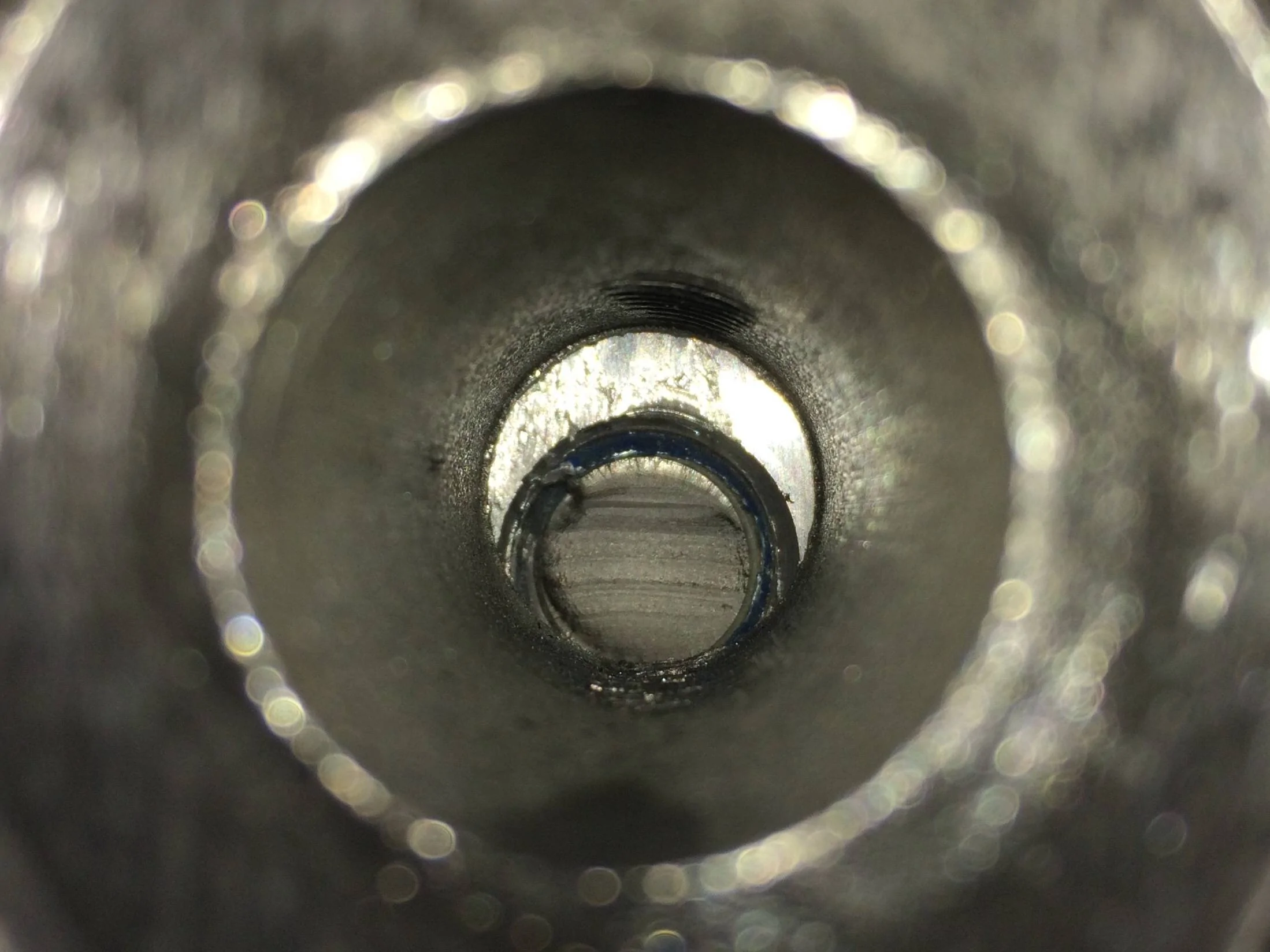

Not to be all doom and gloom, but my thud …
That’s a sheared diff bolt viewed from the now open end of the diff bush.
The car is driven enthusiastically but it’s not abused.
Check out this video to see just how much the diff moves around and the crap that bolt / bush / joint takes :
You can just see the rear right bolt above the ARB.
WD :like:
WD :like:

That video is to sell the the IRS bushing supports, but it shows clear movement in the diff bushes too - that’s the only reason I posted it.
I have the diff bushes and the IRS bushing supports in now and there is a clear difference in how the car feels. I have the braces too but they aren’t fitted yet - it will be interesting to see if I feel a further difference with those installed or if one (or the other) gives you 80% kind of thing.
Trouble is with the bad weather, it will be a while before it gets driven in anger again so maybe not a fair comparison.
WD :like:
I'll have to look. It's always been present in my car. Maybe oe diff bushings are just shot
