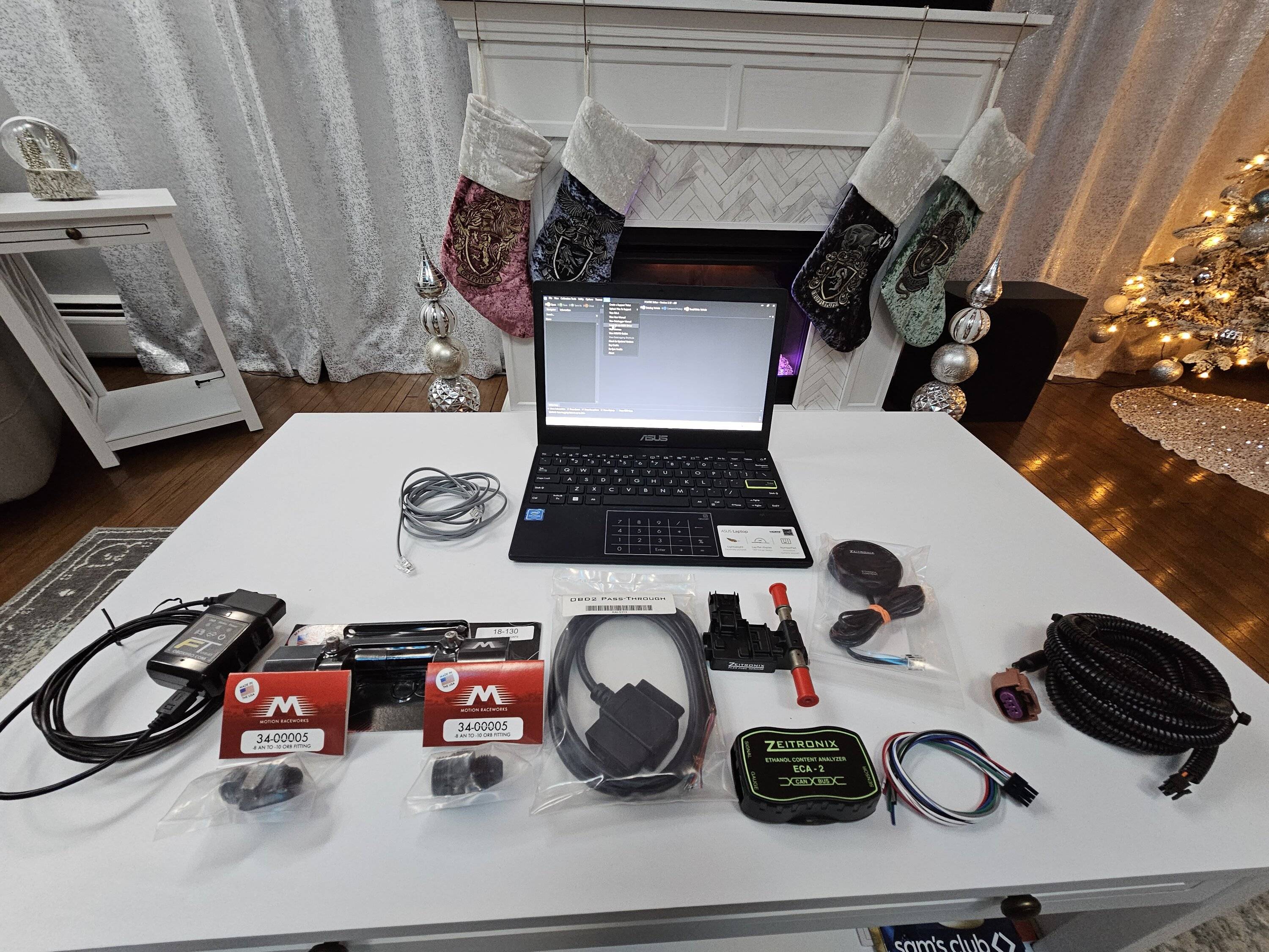

I'm about $700 into hardware to run the canbus function of PCMTEC.
64 bit flash device, flex fuel mount and fuel fittings, Zeitronix canbus box, flex fuel sensor, ethanol guage , harnesses, and OBD2 passthrough so I can keep my nguage plugged in and logging.
