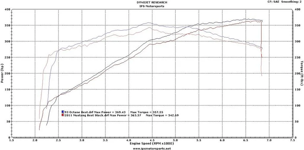

I know we have this argument all the time here, but you won't notice a power difference unless you are running at timed events. The HP difference is minuscule, not "a bunch".
Peak numbers the difference isn’t large but you take a nice hit in the mid-range with 87 octane.
