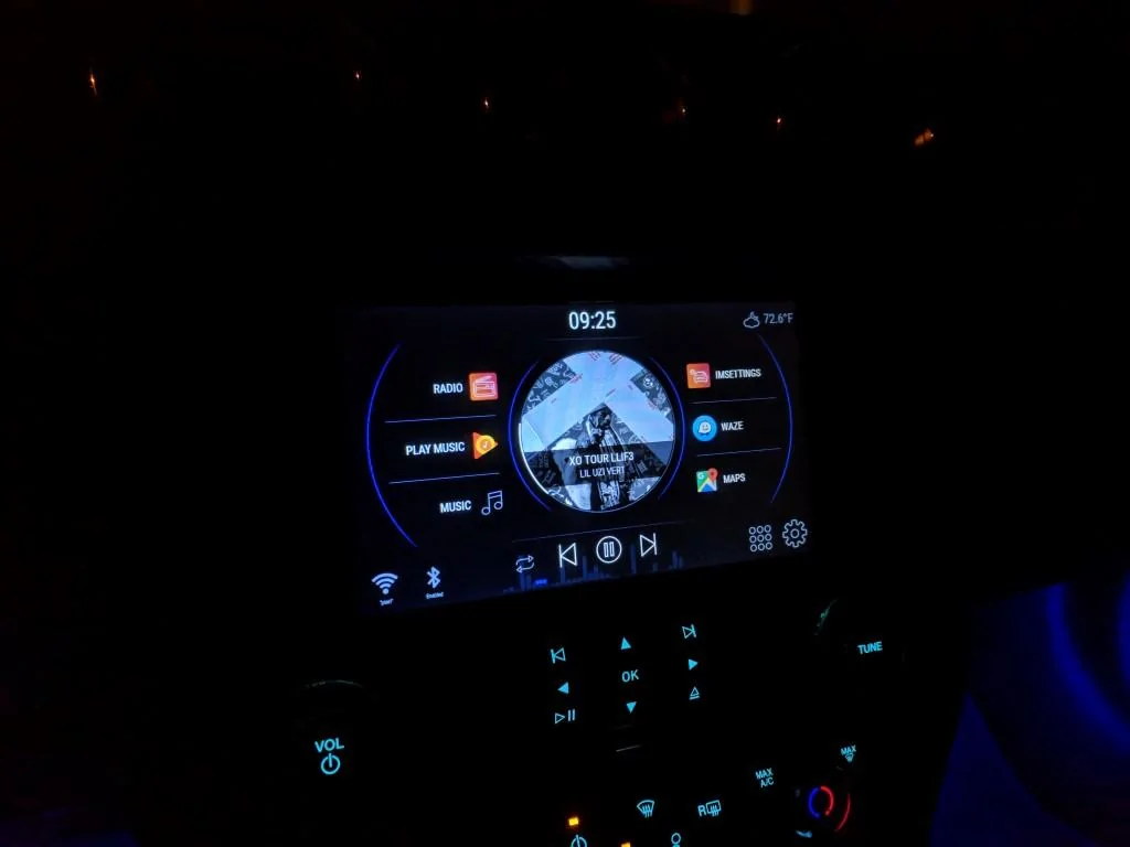

Threw on another launcher to see how it worked, here's a peak at that with the live visualizer.

I like that :D

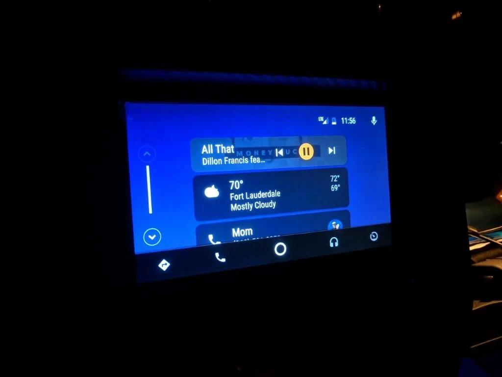

is that android auto running through usb via phone?! :hail:

[MENTION=30139]nancy[/MENTION] I set it up to be wireless via tethering/hotspot :ninja:
