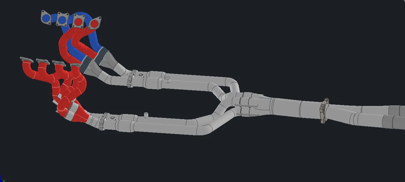

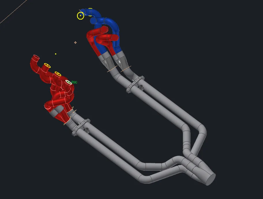

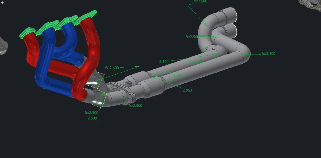

Here are the CAD of the new system :
Any idea if those are for the GT350-specific system? Try to decode the cylinder pairings and looks like they're using a couple different.
The first/second pic has cylinders 1 +3 paired, and 2 + 4 paired on the passenger side. But then it looks like its pairing 5/6 and 7/8 on the driver side. But then the third picture pairs 5/7 and 6/8.
Curious to see what the final pairing. Hopefully its (1+3, 2+4, 5+7, and 6+8) for the Voodoo kit
I was sent these pics and, full disclosure, I didn’t even study them like I should have—I was way too excited about new designs to apply basic engineering brain cells 😂 New exhaust geometry makes my brain go smooth.
My assumption is these are for the GT350, but he’s also claiming it’s a modular system that will bolt onto the GT500 with zero mods and will accept the Tri-Y setup he’s working on.
I’m going to follow up with him and see if this is real engineering wizardry or just peak CAD optimism before we all start mentally reallocating retirement funds.

If you reach back, can you get them to expand a bit more on what he meant by modular, and the triy option?! Not having any luck visualizing that.
Yes sir !

Hi guys.
This is the response to the questions at hand :
Not a problem.
Yes, the cylinder pairing that member mentioned is correct. Some of the pictures were for the Coyote.
Regarding the tri-y. There is now flanges on both sides for the secondaries. Instead of carrying the 4 secondaries all the way to the 4-1 collector, we would merge them into their own respective single pipe. It will now be an equal length 4-2-1 header.
