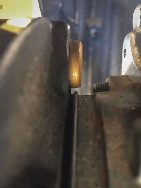

If I'm reading this right you want to unseat them 3mm? That's a recipe for a mess. Once tightened they will pull the rest of the way back in.
Correct but they'd hit the back of the wheel once tightened, which should leave the studs 3 mm unseated. I'm trying to avoid cutting the studs by tapping them back 3 mm.
Judging by the pics I see, that hub is not very thick so perhaps I'll cut instead.??

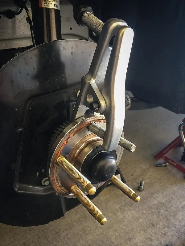

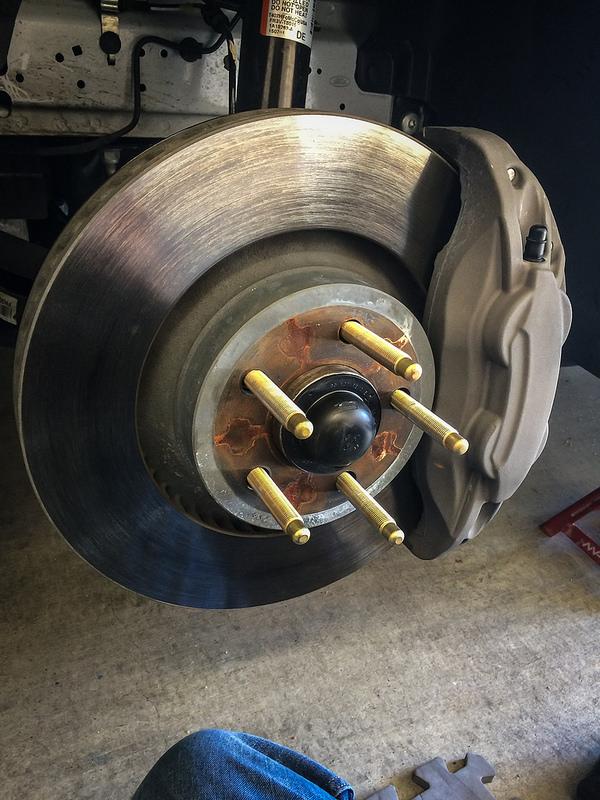

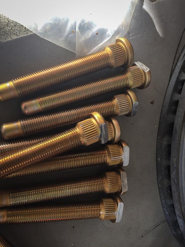

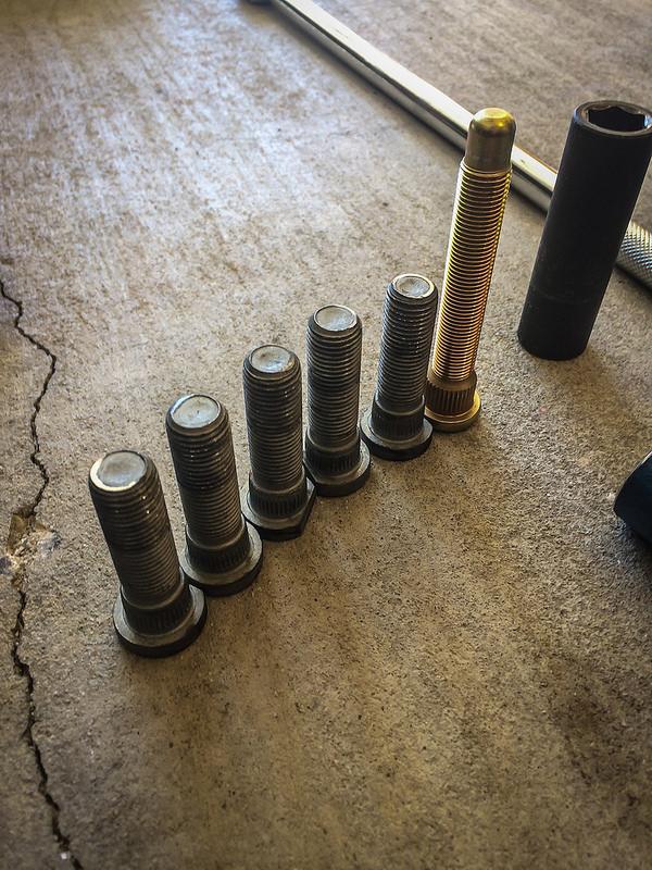

For those interested here's what I did and what all is involved. I hope this helps anyone looking at extended studs.
I went with ARP's 7703 (1/2-20) studs. I personally went these because I've run these in the past, price and because I like to zip off the lugs. To explain, I always torque them on with a torque wrench. But due to having to torque these to 149 ft/lbs on the stock (M14) lugs, my factory lugs after 3 install/removals were rounding off, bulging, getting stuck in the socket and overall getting beat up pretty bad. I also went with Gorilla's Forged Steel Lugs with the new ARP's. It's nice to be able to torque these down to 100 ft/lbs just like my previous Mustangs and the lugs not take such a beating.
Having the right tools made this job smooth and easy. There were 3 studs that the ball joint tool kept slipping on that I had to "tap" out with the mini-sledge. Being that the car was so new, those 3 studs took little effort to tap out.

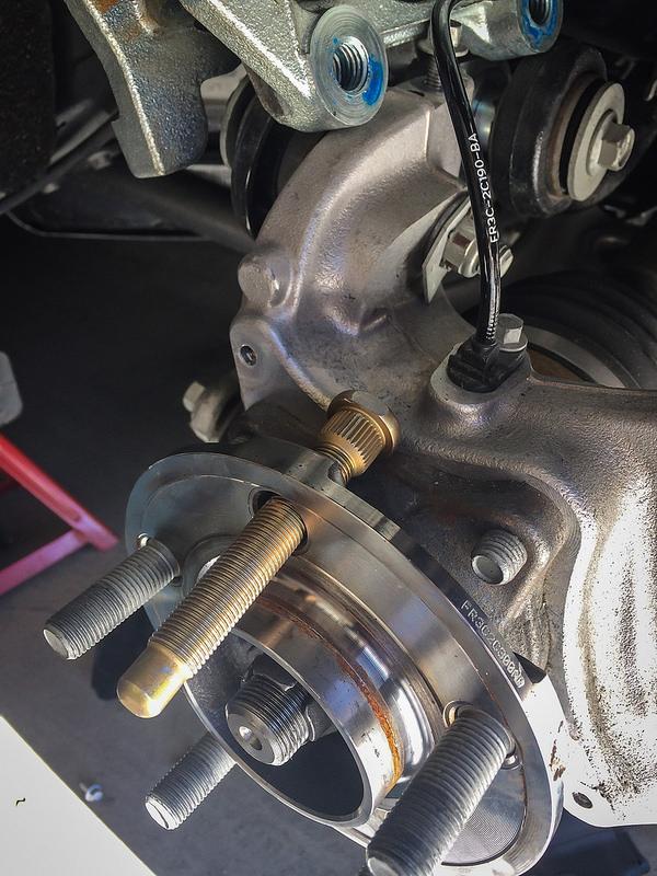

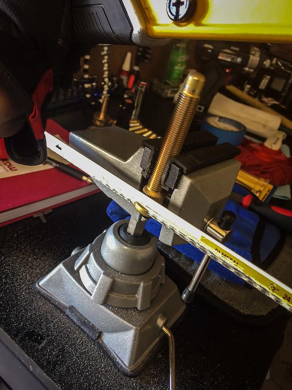

On the rears, you do have to trim the head so it does not interfere with this lip behind the hub..(I'm not sure what this part is called).
You do not have to remove the hub for the rear. This spot was the only place I could get both the factory stud out and ARP stud in. It's like a small cavern that they could easily slide in and out of.

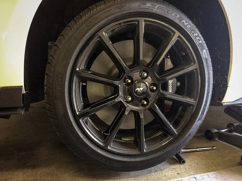

Can you provide a link to the lugs you purchased? Gorilla 45088bc-20?
Any pics with the wheels and lugs on?

Just wan to confirm; you do NOT need to remove the rear hubs in order to install the extended studs?

Correct, no need to remove the rear hubs. I found a spot near the ABS sensor that they would fit. The hub had some casting flash and I tapped the stock stud gently and it self clearanced and they all came out no problem.

I'm looking to purchase, I see in the pics that you cut off some material from the new studs. Did you have to do this for the ones in the rear? Also how do you install them onto the hub? Thanks
Sorry about bringing an old thread back to life.
Just started my ARP rear stud install and am having no luck removing the old stud when it is positioned as indicated in the picture above. Have the flat side of the stud facing the hub but it just will not slide out.
Has this technique without removing the hub worked for anyone else?
You have to smack the old stud pretty hard with a really big hammer. It is a press fit in the hub

Or you mean the stud is free from the hub, but you can’t get it past the knuckle? Maybe try another position to see which clears
Yes, I have the first stud free but can't remove it. It is close but no cigar! I am pretty sure the location between 11 and 12 O'clock just in front of the speed sensor is the only location close to working.
