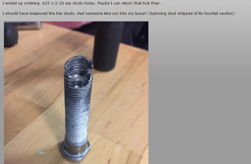

Unless they have new studs then the ones they list on their website they would need to be welded in. The knurl is smaller than the Ford part by about .040". We know because this picture is what happened.
That said if they actually have a stud with the correct knurl diameter in 14mm for $4-5 a stud that would be great for the street guys. I would verify the studs they have in that kit before you buy.

That does not look good, I have another set that are not installed, what is the measurement for the correct knurl and I will measure the ones I have to verify.
the ones I have in their current kit are:
knurl size - .625" or 15.875mm
I do not have a stock one handy to measure.

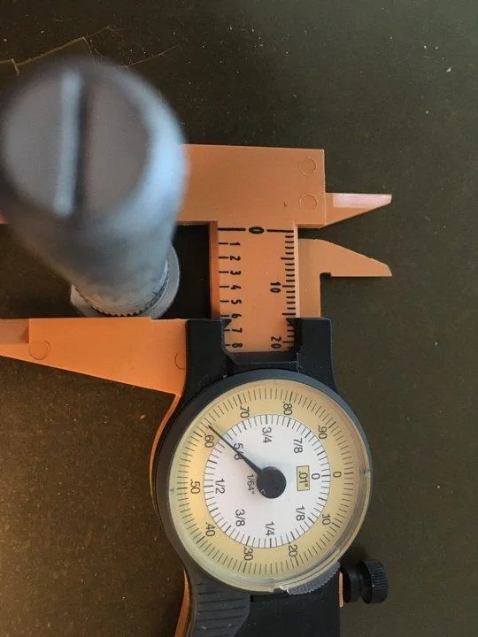

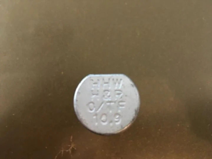

Dave, The .625" would be correct, did you measure the ones yourself or is that what they say they are. We would like to know, they do not list anything on their website that resembles a .625 knurl diameter. If they have a product that works that would be great.
This is what I got, not the best pictures.
