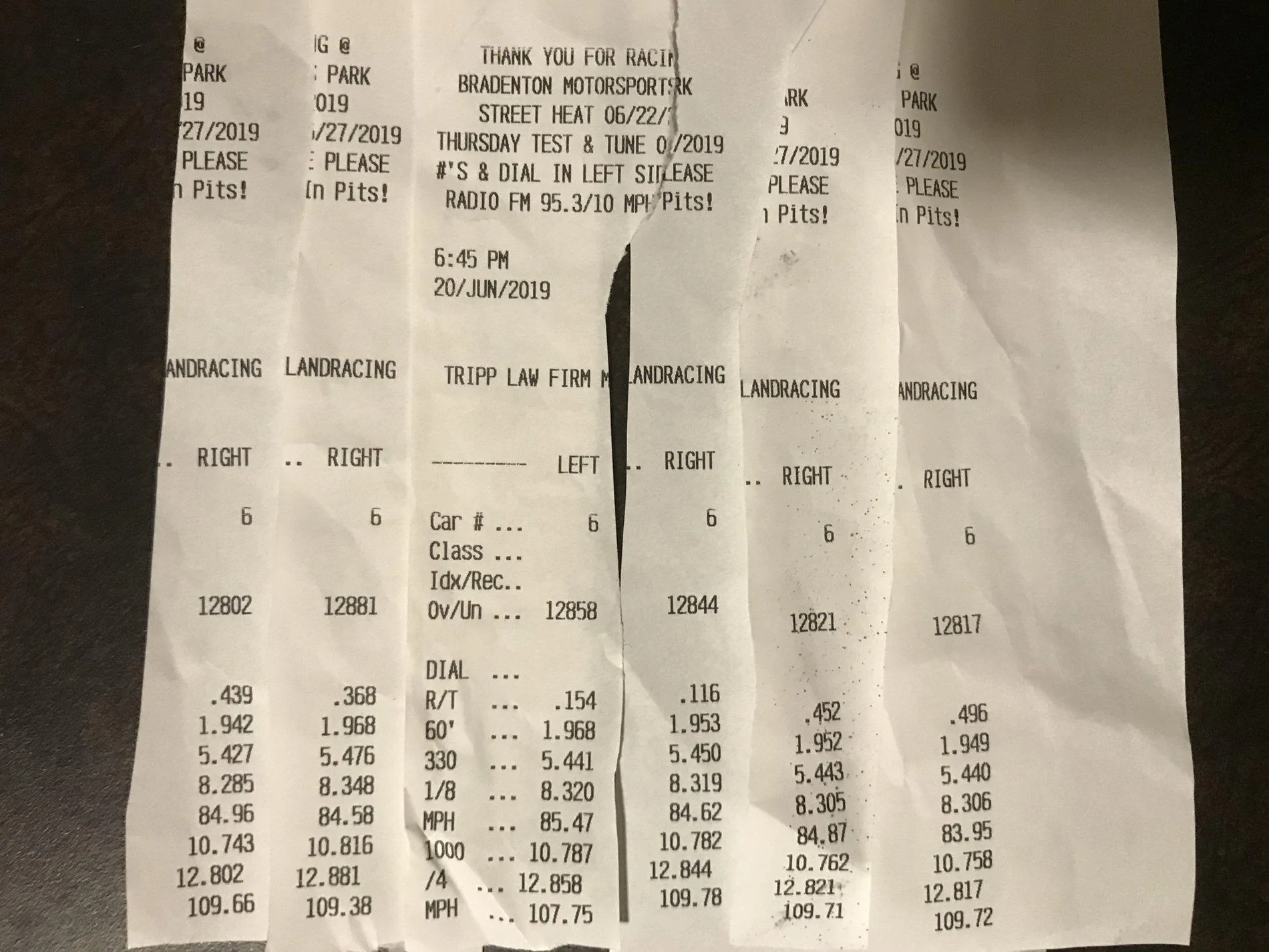

My first time at the track was 6/20/19.
Had a great time.
Plan to go back.
Was happy with my results.
My first run was around 6pm and the last was around 8:30pm
My time slips are chronological in the pic.
I started at 20 psi(rears) and dropped 1 psi (pre burnout) every pass.
I’m pretty sure I had zero traction issues... but, what do I know? It WAS my first time at the track.
I keep reading that I need to improve 60’ times for better 1/4 mile ET’s. I’m not sure where I should start.
2016 Mustang GT (premium- if it even matters)
Automatic
3.15
Transmission in D
Drive mode in Normal
STEEDA closed CAI
STEEDA 93 octane Tune
BMR CB005-cradle lockout.
FRPP track shocks/ struts.
BMR SP083 springs.
MT ET STREET S/S - 275/40/17
Bradenton Motorsporst Park
DA- 2700
I was a bit nervous with the whole process(newbie).... and didn’t log my launch RPM’s every run...
At first I concerned myself with my R/T’s... before I realized they really don’t matter!!
I’d guess I was “foot brake stalled” at or near about 1200 rpm every run.
Constructive criticism welcome.
