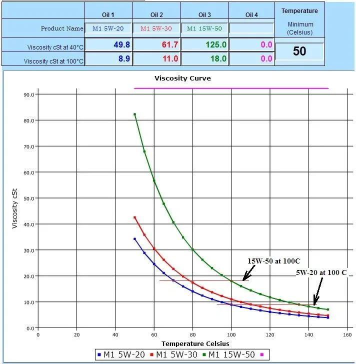

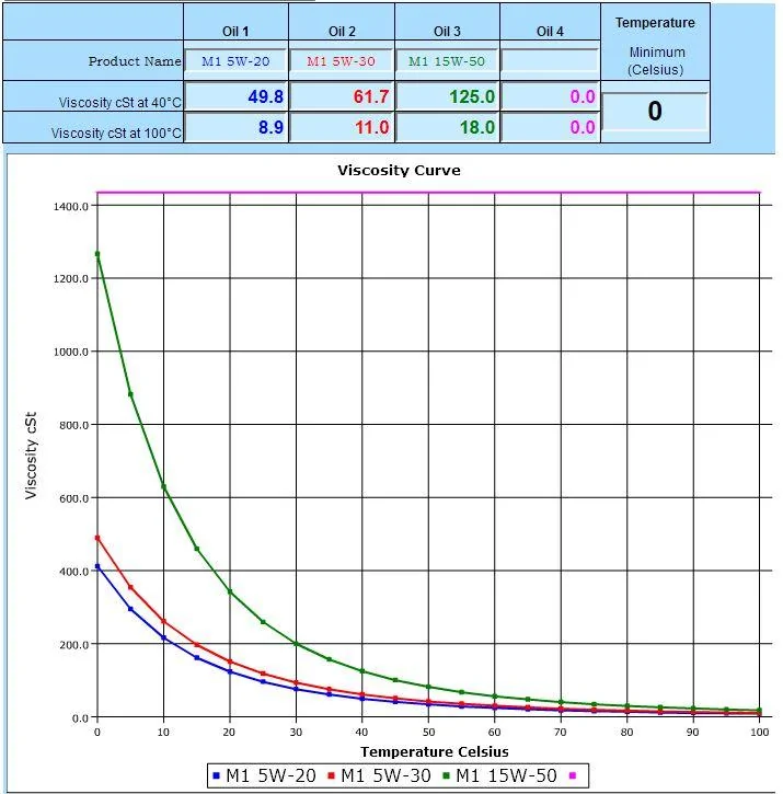

This is what @engineermike is getting at. This example is using the KV100 (Kinematic Viscosity at 100 C) and KV40 (Kinematic Viscosity at 40 C) values off of Mobil's website for their Mobil 1 Full Synthetic. The viscosity vs temperature calculator can be found here: https://www.widman.biz/English/Calculators/Graph.html
First graph shows the viscosity curves through a large temperature range to get the overall perspective. The second graph blows up the temperature range between 50 to 150 C (122 to 302 F). See the horizontal lines I've drawn through the curves.
15W-50 at 100 C (212 F) is the same viscosity as:
  • 5W-20 at 70 C (158 F) - Temp delta = 54 F
  • 5W-30 at 78 C (172 F) - Temp delta = 40 F
5W-20 at 100 C (212 F) is the same viscosity as:
  • 5W-30 at 110 C (230 F) - Temp delta = 18 F
  • 15W-50 at 135 C (275 F) - Temp delta = 63 F
It's pretty obvious why Ford and other manufacturers recommend a heavier oil for track use where elevated oil temperatures occur. A car running around on the street with 15W-50 at 212 F would be like it running around with 5W-20 at 158 F, and 5W-30 at 172 F.
You can also see that at 100 C (212 F), which is where most engine's oil temperature runs during normal street driving, there isn't much difference between 5W-20 and 5W-30. But, if you look at the High Temperature High Shear viscosity (HTSH measured at 150 C) of 5W-20 vs 5W-30 you'll see that 5W-30 does give a bit more added minimum film thickness between parts - which is important in keeping moving parts from contacting each other.
There will be no issues at all running a 5W-30 on the street as it will give added film thickness protection between parts in case you do get a bit nuts and drive it hard at times. 5W-20 will probably be just fine for most street driving, but 5W-30 will give insurance that protection remains if you hammer it hard for any extended periods.
