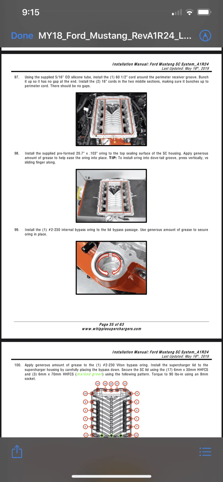

First off look behind the bypass valve on the front of the blower. There is a 1/8 npt port there for boost reference that needs a plug if not in use and I could see somebody forgetting to install the plug if not being used, I think there might be one on the back of the blower too. If thats fine, check the orange gasket you have to install under the blower lid, make sure its seated correctly. If thats good, pull blower and check the green o ring gaskets and the bottom of the blower that seal to the head.

I have it sitting in the groove inside that cup.
I pulled the lid last night and everything looked good. Pulling the lower portion today to check those seals. I was thinking possibly one of the injector adaptors might have popped out from removing the injectors. Going to check that as well.
