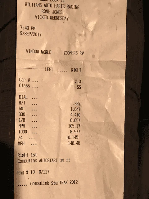

First time out with new motor /combo.

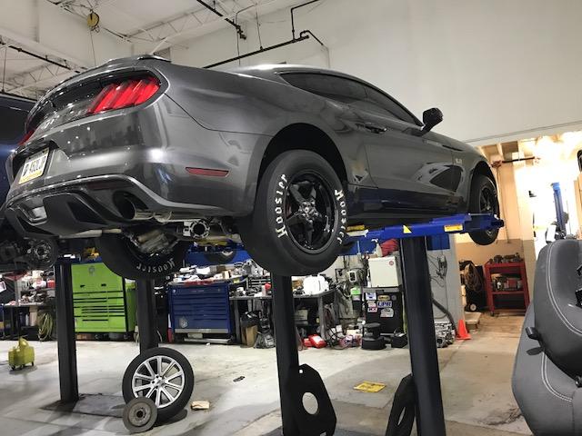

Sleeved 5.2/GT 350 heads/3.2 KB(20 OD and 3.5 pulley/Tremec(2.66)/still 3.31 rear/17 inch Hoosier (28 inch tall)slicks/skinnies/corbeau seats.
10.1 @ 148
60 -1.65
1/8 -6.65 @ only 105 mph so picked up 43 mph on big end staying in third.
I need to figure how to post pics of slip.
Should be easy 9 sec when I get the 60 down.
I am building a 4.11 pumpkin but that will mean shifting to fourth. I may try the 26 inch ET R -bias ply- on 15 inch wheels when I swap the Baer brakes (should drop another 100 lbs of unspring weight).
