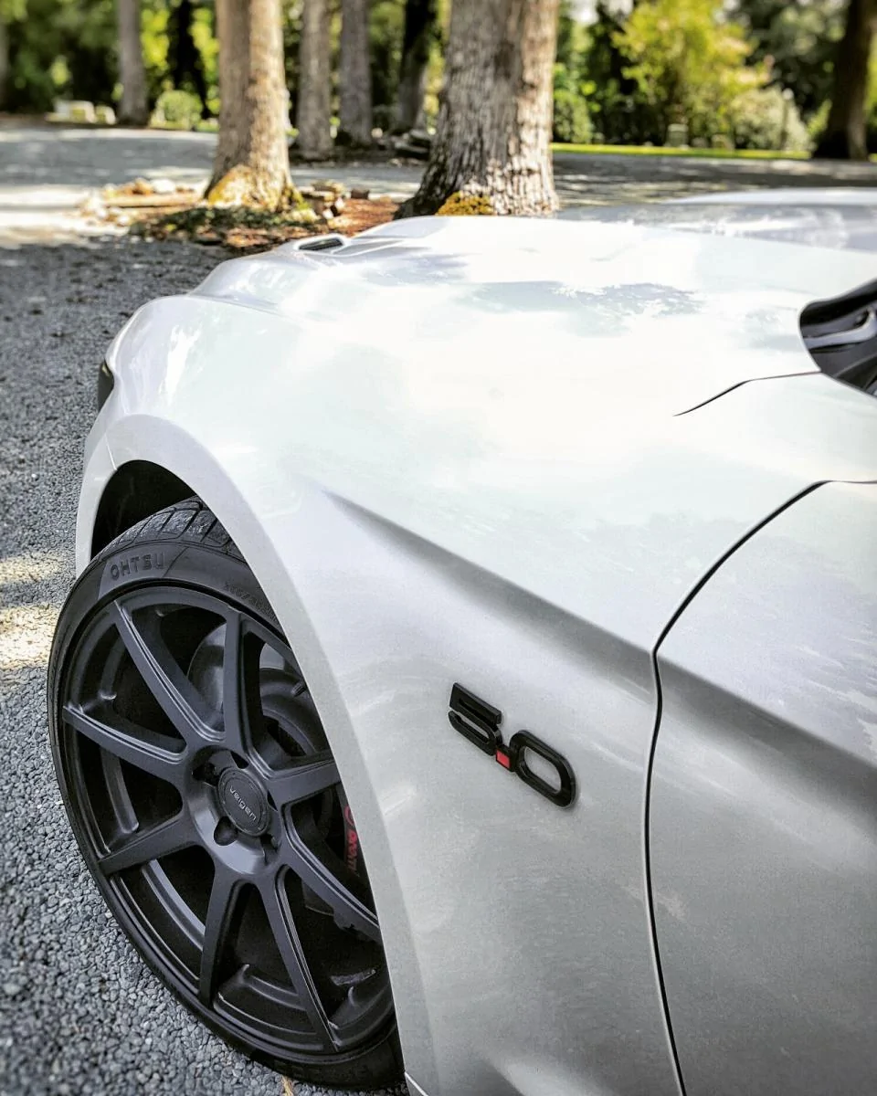

I just ordered these body colored 5.0 badges http://www.cjponyparts.com/fender-emblem-5-0-pair-gt-2015-2017/p/EMF124-V/ Should look more stealth than chrome ones that are on the car now. My first choice would be a blank finder but there the holes to cover up. So this should work. They are a bit pricey though. I already have a blank black rear deck panel. Got tired of kids in older Mustangs chasing me down on the freeway wanting to race.

Ya that's crazy expensive. I got the gloss black ones from ebay for $19.99. I think they only offer them in chrome, flat and gloss black though.

I ordered a pair of black 5.0's from Hypermotive.. They are Ford licensed and have the tabs on the back. Yet to install...
