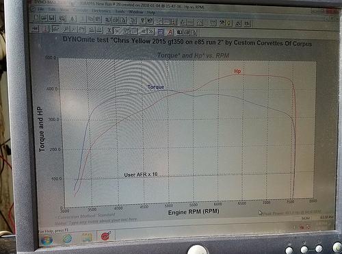

Here’s mine, I feel like I should be getting more power no? I have no clue lol
Gt350 IM, TB, Cai, 47lb injectors, e85 race tune from Lund, extreme catback, still have stock cats on. Let me know what y’all think?

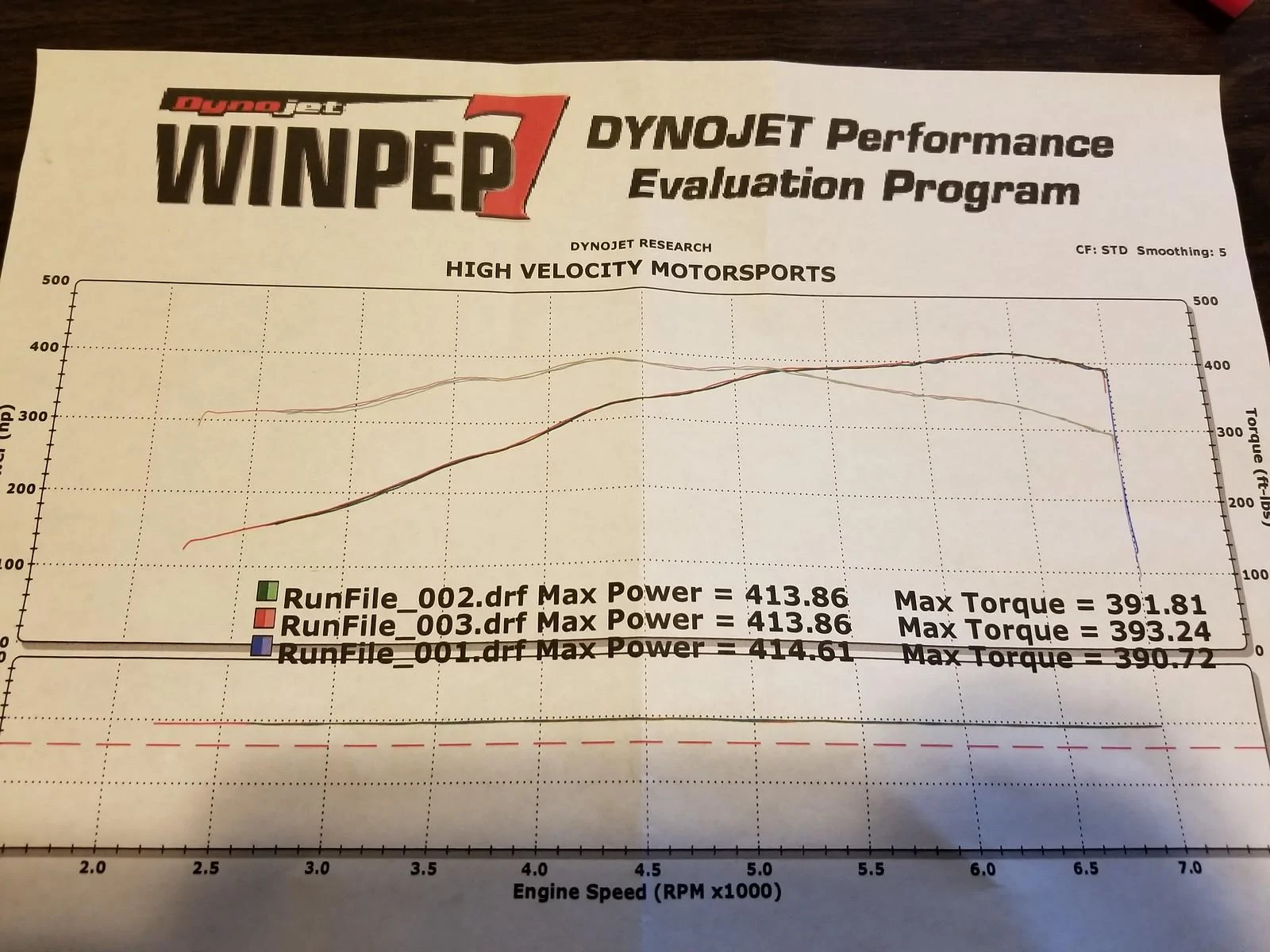

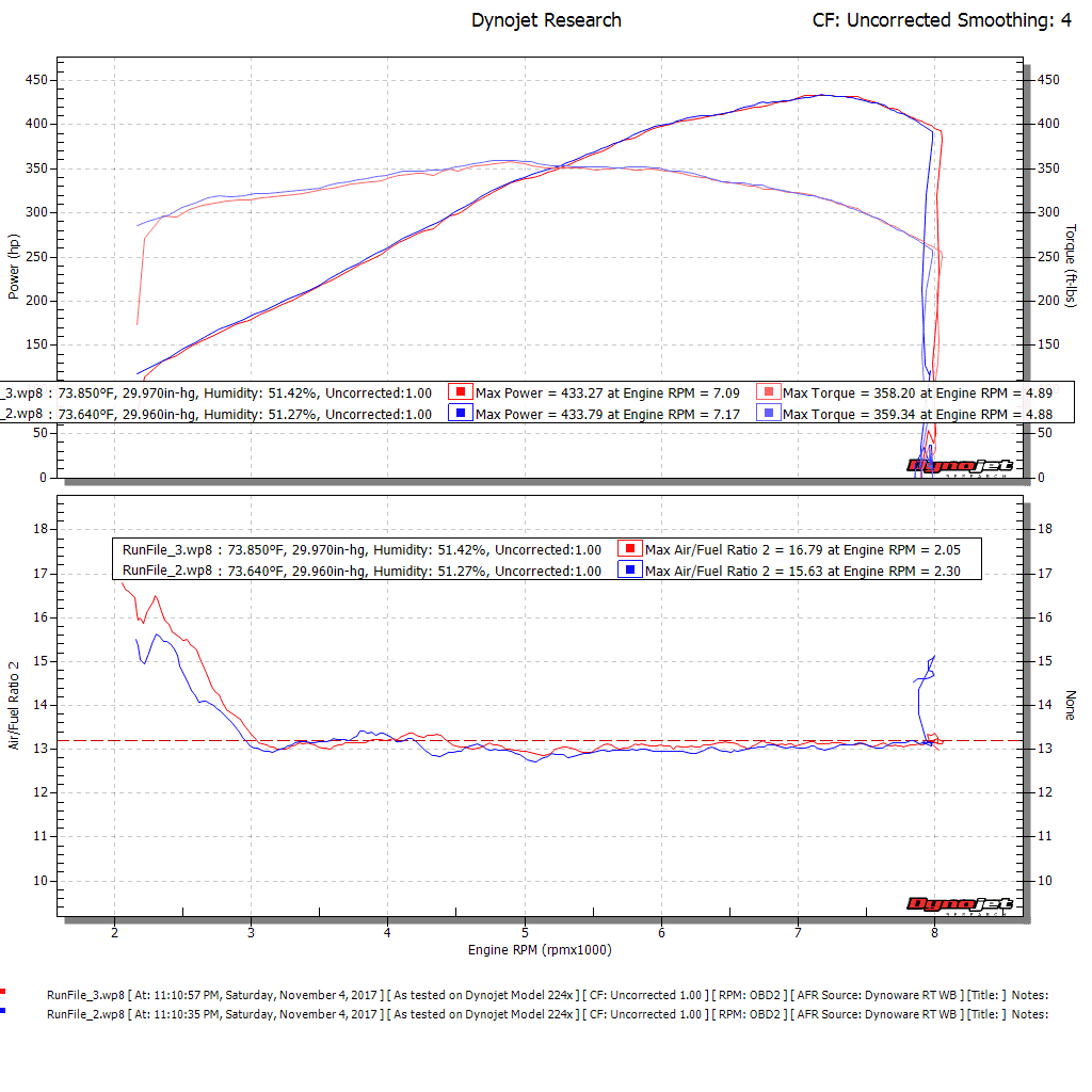

So, 2017 5.0 GT PP (so 3.73 rear end), Power Pack 2, Dynojet dyno, today. Pretty happy with the 414, though I was hoping to get past 400 ft-lbs (Can you guys see the pic?)

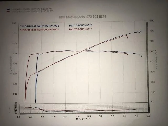

This was my 2015 GT auto with only a Whipple stage 2 on the 3.625" pulley. No other power mods.
Red line is Whipple Calibration, Blue Line is HPP custom tune (still in progress).

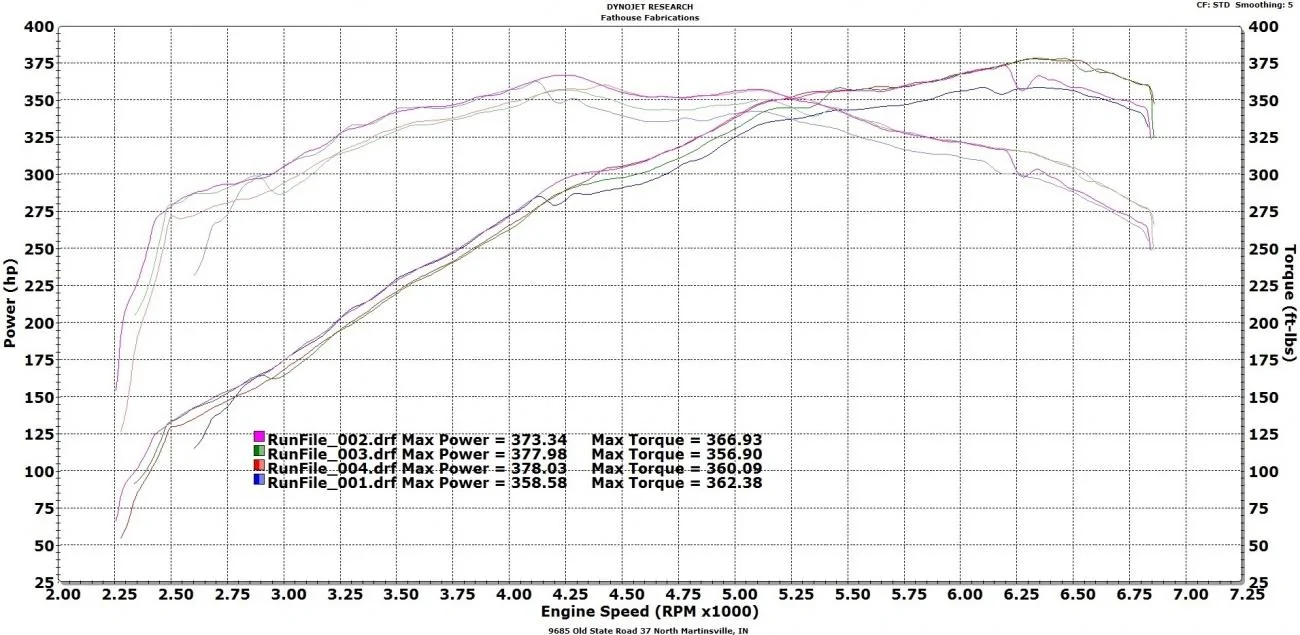

Completed 4 runs at a local shop yesterday to get a good idea of what my starting point is before going FI.
Stock engine with auto tranny, Roush AB and MRT H-pipe.

looks like your car was pretty unhappy on some of those runs pulling a lot of power.

Yeah that might be on account of me driving like a grandma these past couple of weeks :)
It or the software or whatever was flunky woke up on the 2 last runs and they were so close I think that's a good benchmark.
Next one will be with the Whipple kit in a month or two! :)

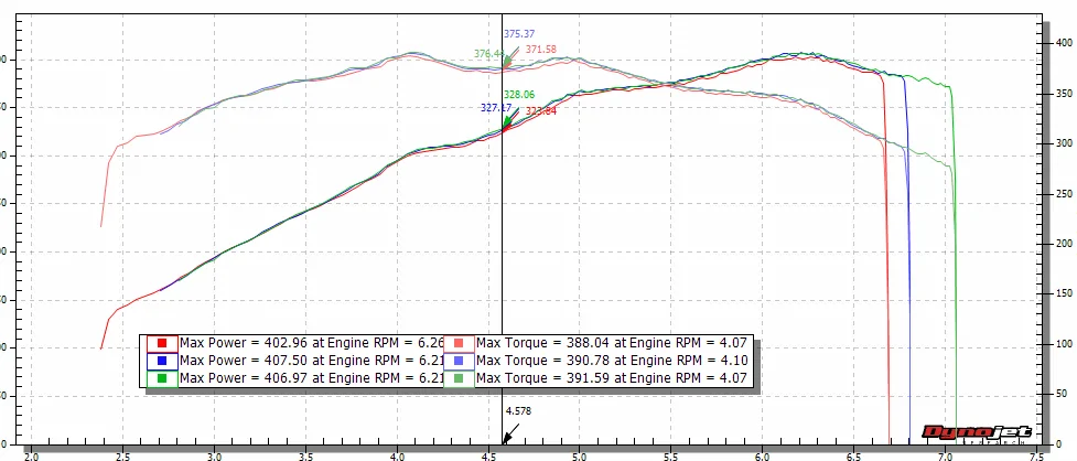

This pull was from this morning:
Looks like it needs some tuning above 5500 RPM ... torque & HP falls off too fast for a Coyote. Too bad there wasn't A/F ratio plot data also to see what's going on.

For me it really showed how good the Whipple calibration was - my Whipple vs HPP tune comparison dyno is earlier in the thread but the Whipple cal put down 660 / 521 through an auto and the HPP did 700 / 521, although at a 4-500 rpm higher redline - so really they were almost the same output line over line. E85 just changes everything though - no more fuel quality / knock / timing issues. Can't wait to track it!

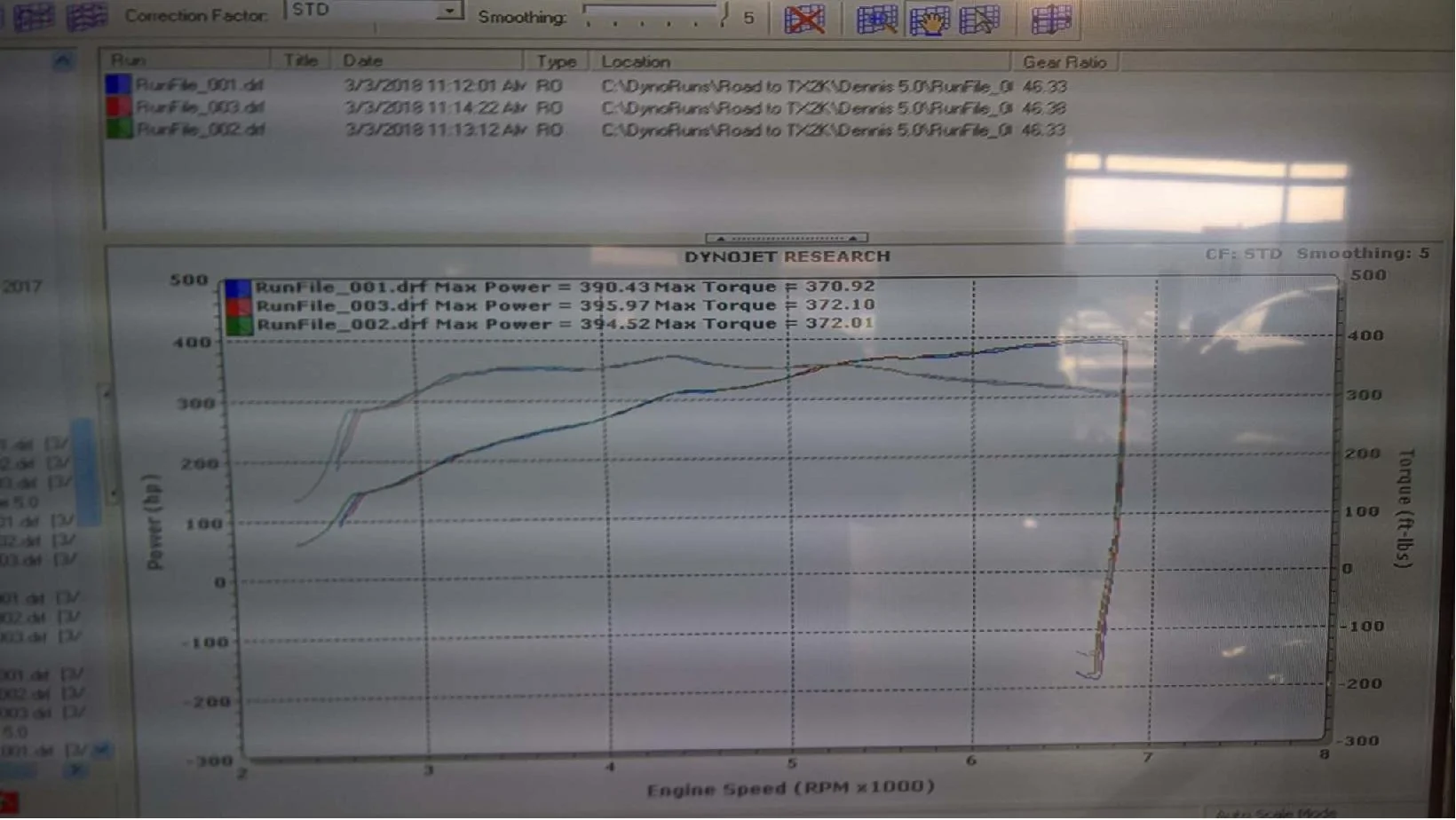

I don't have a stock dyno to compare against but there looks like quite a bit of under the curve gains as well as peak gains. 2016 GT A6, Kooks 1 7/8 headers with green cats, MRT H pipe, Borla S type catback, Mishimoto CAI, factory tune

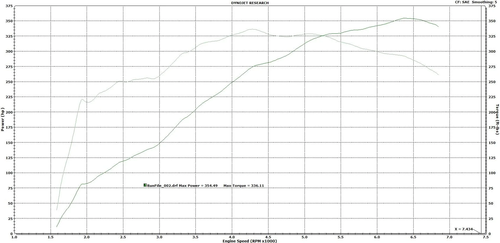

2015 5.0 Automatic Completely Stock with 70k Miles. Pull done in 3rd gear.
Dyno done on a Dynojet. Air Temp 54F, Humidity 66%, Absolute Pressure 29.3 in-Hg
