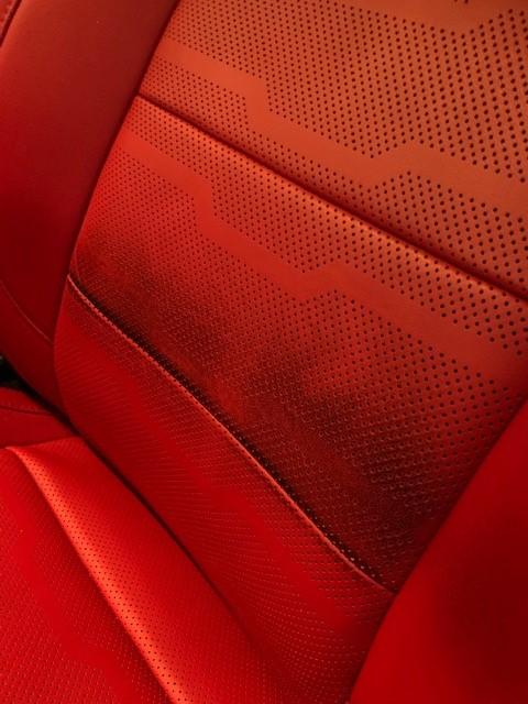

We have an 2018 GT Premium with the 401 option with Show Stopper Red Seats and trim which was awesome until they started to discolor on us and Ford will not warranty it. I have 3 high line upholstery shops that all say the same thing that the discoloration is coming from inside the seats. But all the people that have an opinion that matters to Ford say it is caused by a dye transfer from our clothing/belts.

The fact that its blackest in the indentation between sections makes it seem less likely its some transfer from your clothing and also less likely its the red being being worn off exposing the underlying black. So with nothing else to go by the from within explanation sounds more plausible although I can't imagine what could be inside and "leaking" thru.
When (miles/age) did you first notice anything and how regular and fast has it got worse?
Do you drive it when sweating or with wet cloths? I guess moisture might cause something off clothing to flow into the indentation.

Some pro detailers use a dye to change the color of seats.
If cleaning doesnt work on that (id try car guys super cleaner) then maybe the color on the red leather is dyed on and somehow rubbed off? Not sure really but if it isnt color transferred off of a belt or something then its probably color removed from the seat its self I would guess.

We purchased the GT in July of 2018 and first noticed the discoloration the end of September 2018. It has slowly grown to the area in the posted photo. As of today we have 8961 miles on it.
Sweating and or wet clothing is not an issue. After the third warranty turn down from FoMoCo I have no recourse with them. And the selling dealership (Plantation Ford) has no interest in pursuing my claim.

If it is indeed "dye transfer" from clothing or something else, a Mr. Clean Magic Eraser will take it off (works almost every time to clean leather), (mineral spirits on a MF towel works as well, but is harsh on the leather), if the Magic Eraser does nothing, it is not dye transfer (or dirt), it is as the others suggested, the leather wearing down internally and is failing, which should be a warranty concern. (but, as you said, you are most likely SOL on that now, which is unacceptable in my opinion).
