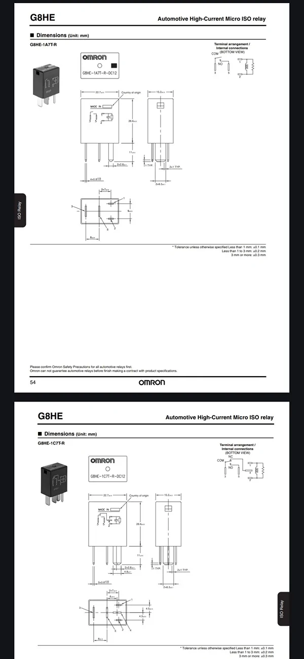

I've seen a few Panasonic and Denso relays that look the same, and they are less than half the price of a GU5T.
I searched ISO relays and there is a bit of variance on size and shape aside from the ones that look like Ford's. Is there a specific variant of ISO 4-pin relay I should be looking for?

So for the 4-pin relays Omron does make that size. It's their G8HN series.
Size and connector layout look to be correct but 2 of the blades look to be bigger than Ford's version so it looks like they won't plug in.
This looks to be the case with Panasonic, Denso, and the other lookalikes I've seen so far too.
EDIT: scratch that, looks like Omron's G8HE-series is the one!
