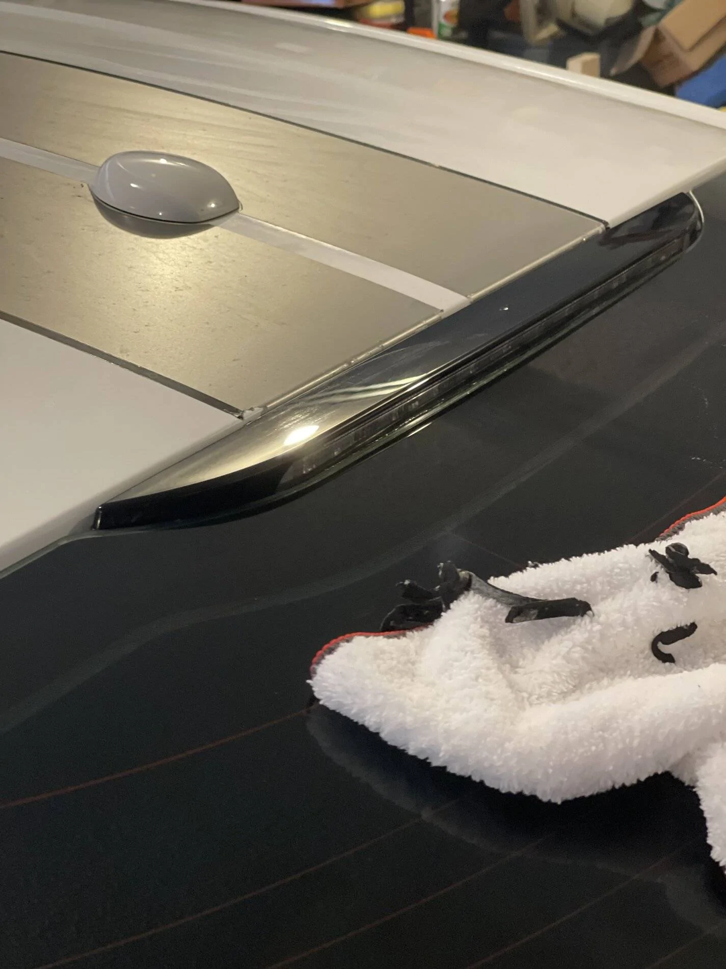

Hey all! Was washing my car and when i went to move it i saw a drop of water on seat, and sure enough passenger side in the back was very wet. It seems to be coming though the 3rd brake light? Is this an easy fix? 2018 and just out of warranty for it...

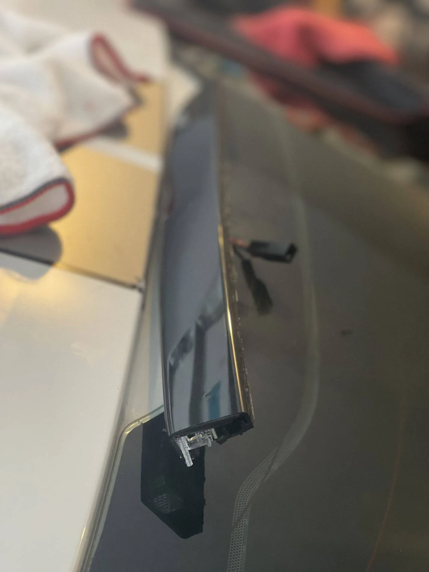

Sooo even w/heat gun these brake lights crack... not the way i wanted my Sunday to go.... Now to wait for parts... At least i get a garage spot till i get new one... 2ed plus side i have a reason to redo my stripes now. Im thinking blue..

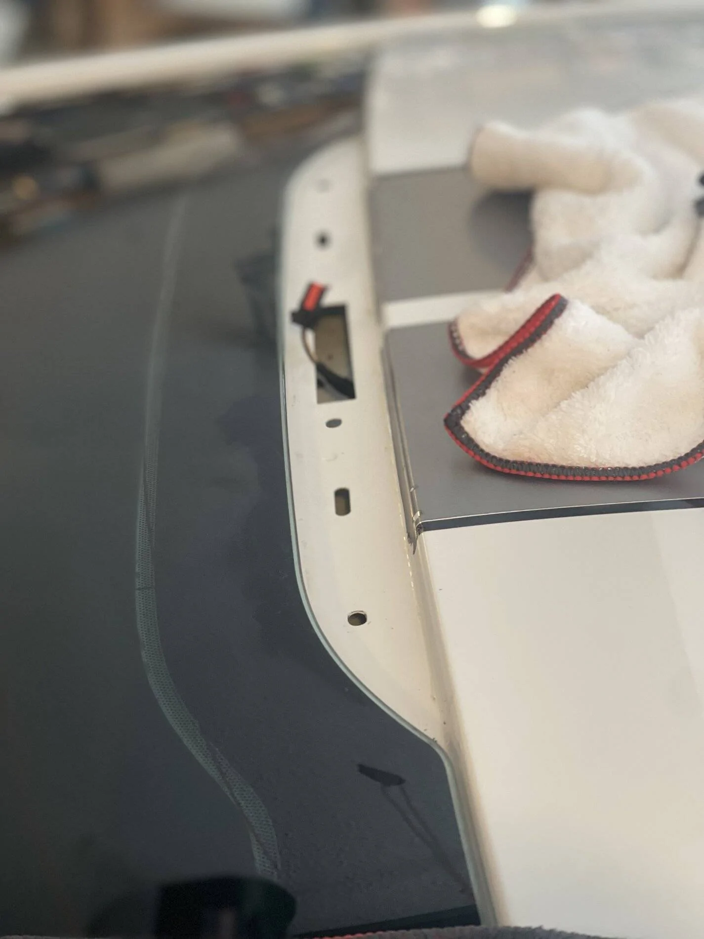

I think i know what happened -whomever put the strips on took the light out to fold them is as they should but instead of redoing the double sided tape just pushed it down and tightened it down and never thought about it. ugh

New light installed - This one does not move at all like the old one - im 96.654% sure its fixed. Ill find out in 24hrs.

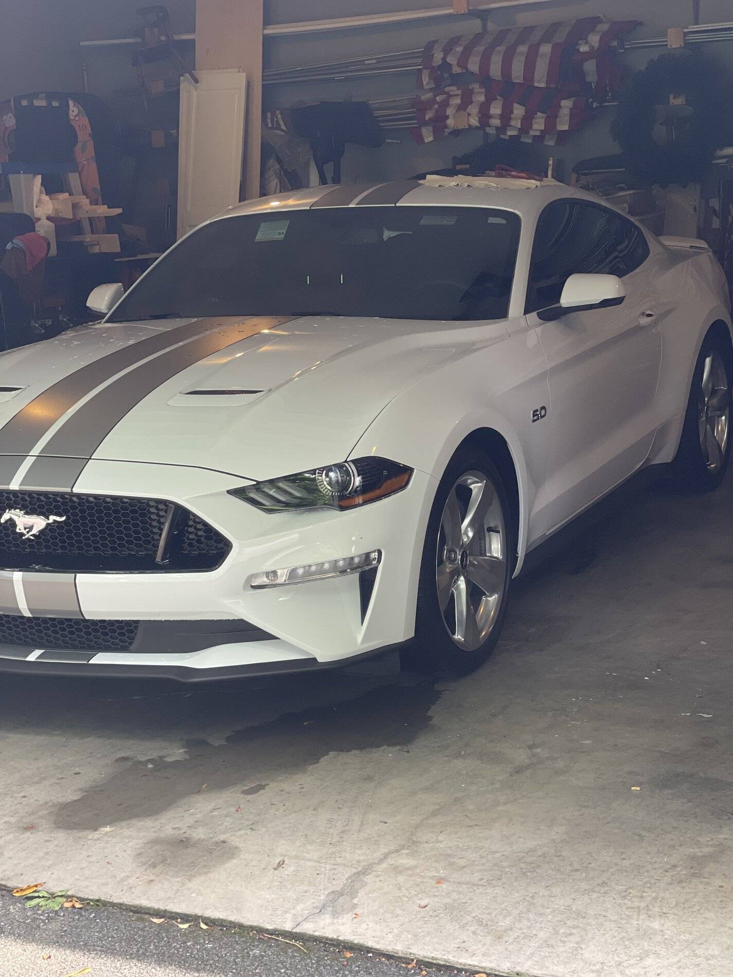

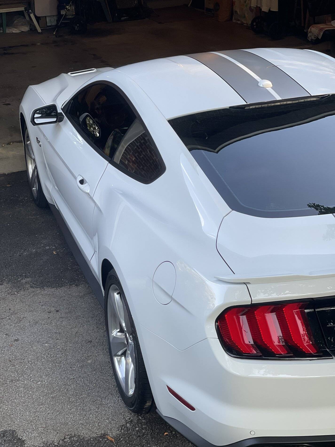

Washed and waxed it - so far no leaks. Love this car...

Good to hear and glad everything worked out!
The Mustang looks great with the stripe and wheel combo.

TY TY - i was very relieved when it didnt leak
