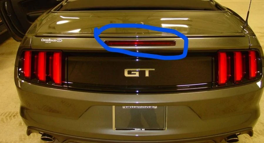

Mine doesn't light up any more. Did some research but not finding much information. Recall one fix was to update the computer or something.
What's the chances the 3rd brake light is bad versus the wiring to it not working.
If it was the wiring wouldn't my back up camera, remote trunk release also not work?
Any links to vids or step by step instructions on how to replace this light?
Light in question:

Check the trunk harness from the trunk lid that goes into the trunk cavity.
That harness is known to have failures within the wiring loom. If you don’t see visible exterior signs of problems, open the loom and check for damaged, chafed or broken wires.
