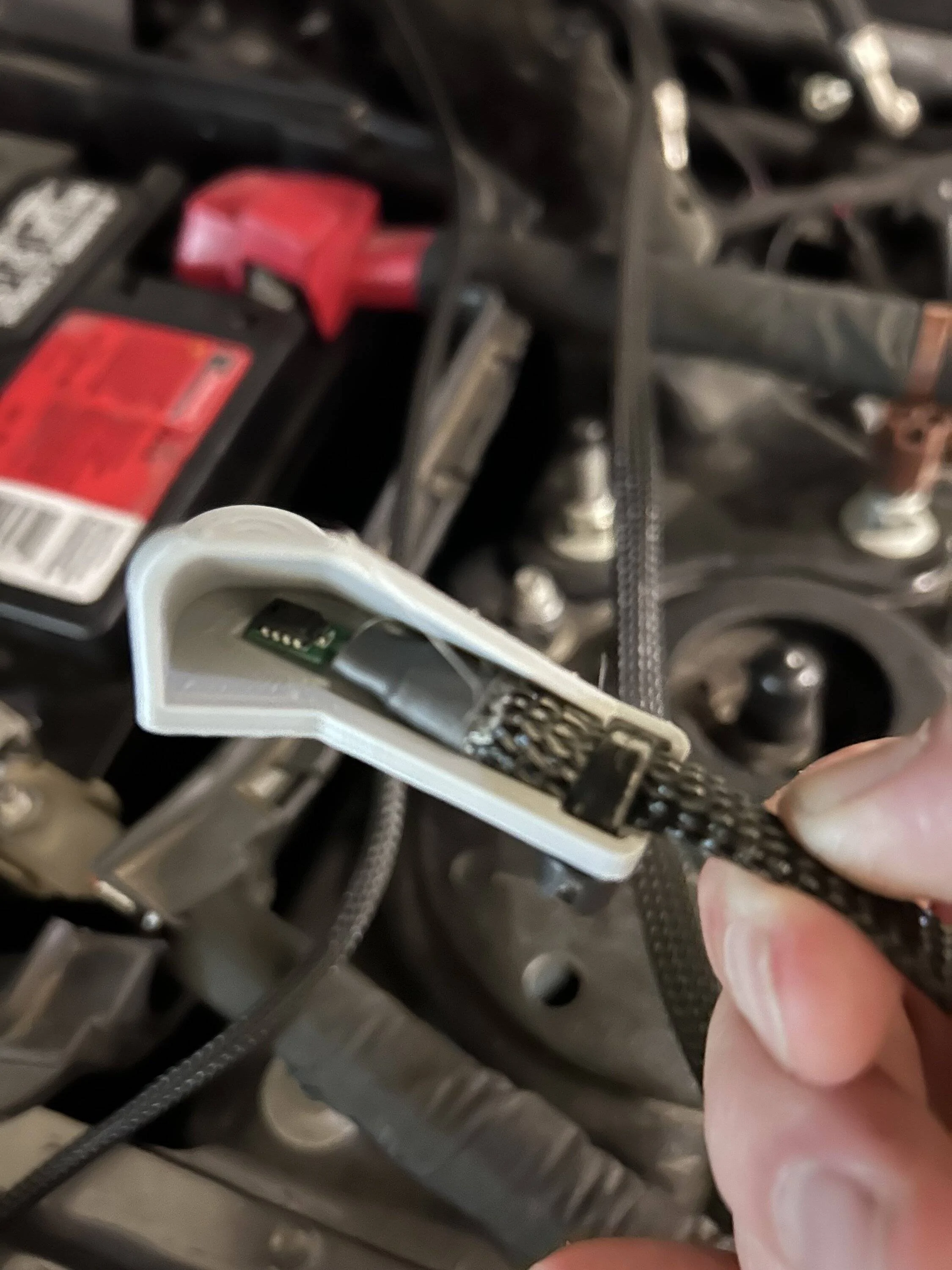

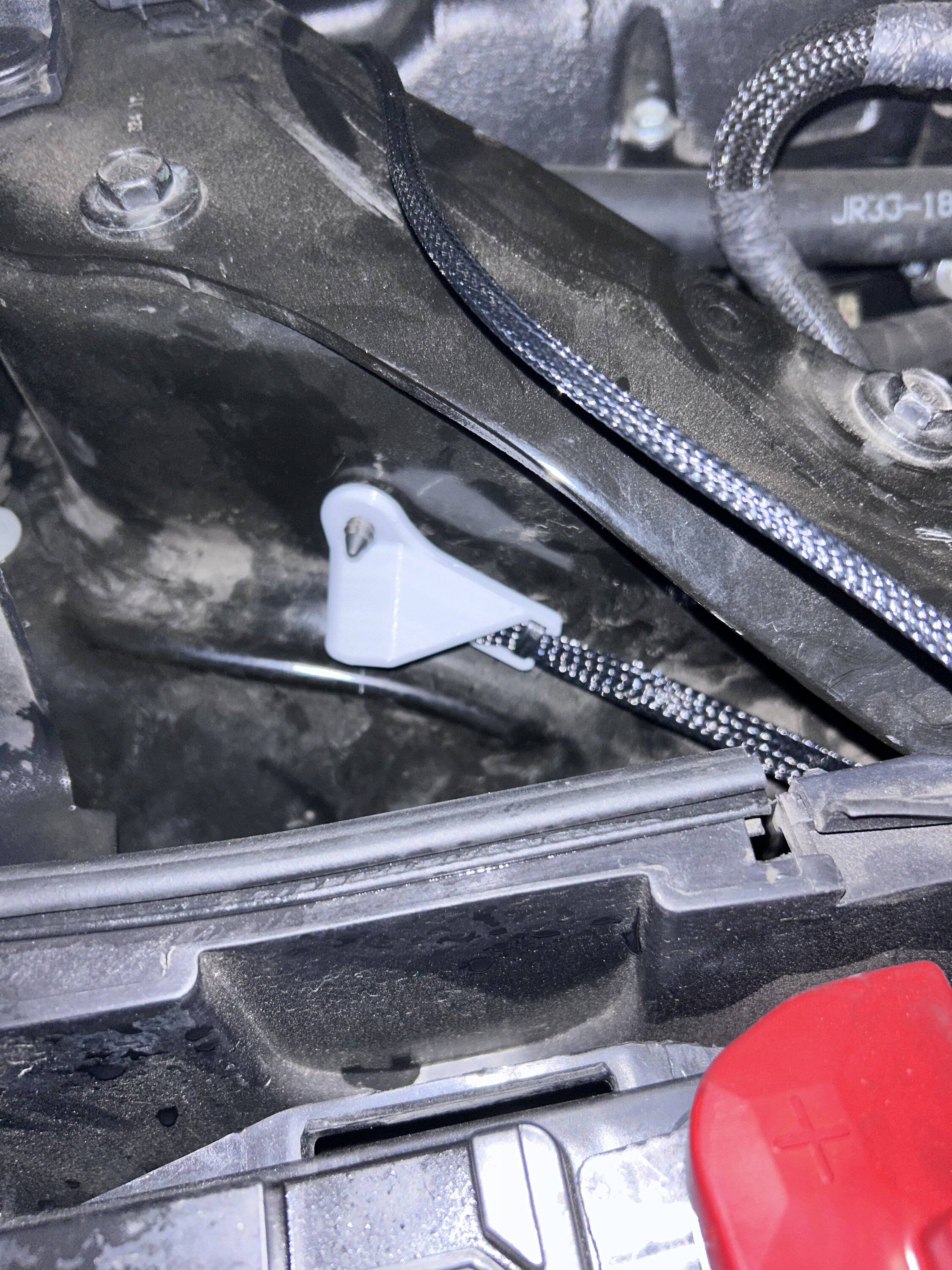

Creality cr-10 mini and solidworks here. Slice with cura. I’m building a humidity sensor bracket and umbrella, since it needs exposure to outside air but not liquid water.
