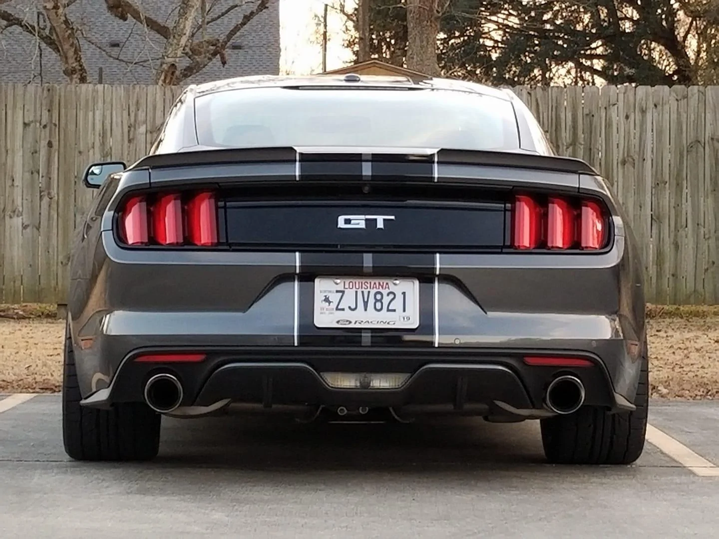

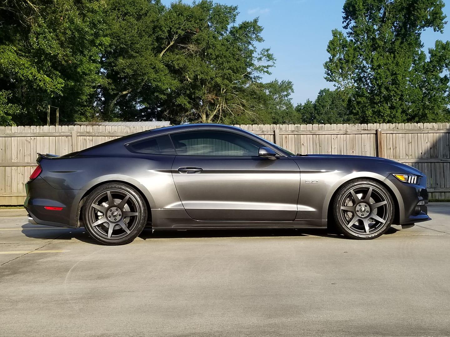

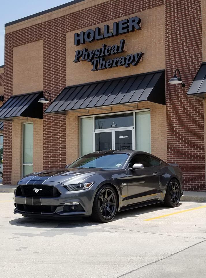

Yes I am lowered. BMR SP763 rear 1/2 inch front 7/8 inch.
CEHollier
Sep 6, 2015
81
1,570
707
Prairieville, La.
Charles
2015 GT Premium Magnetic
Prior to lowering.

Lowered with wide tires you might want to pull the camber closer to -1.5mm. With in factory spec and you get a little more tuck.

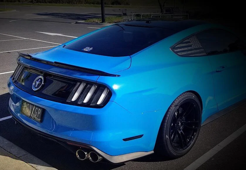

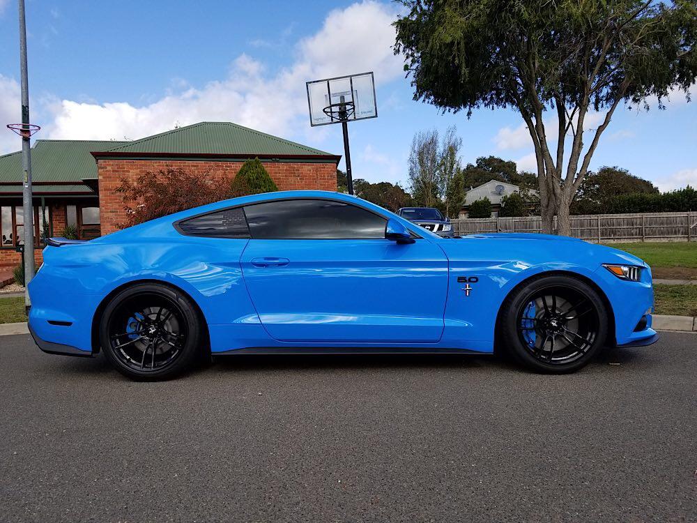

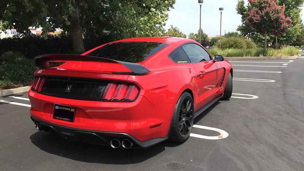

19x11" ET52 with a 305/30-19 rear tire shown below is a nice fitment for the rear of an S550. This was with factory rear camber on his GT350.
You could run a 315 on this setup and not have any poke, but tire selection is limited. A 305/35-19 will fit the same, just slightly taller of course which won't be an issue for clearance.

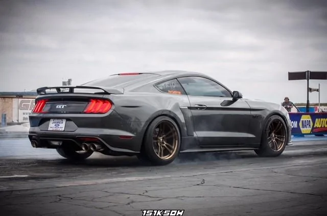

Most commonly a 19x11 ET 50 for the rear 305/35/19 or 325/30/19 stock or lowered no issues at all.

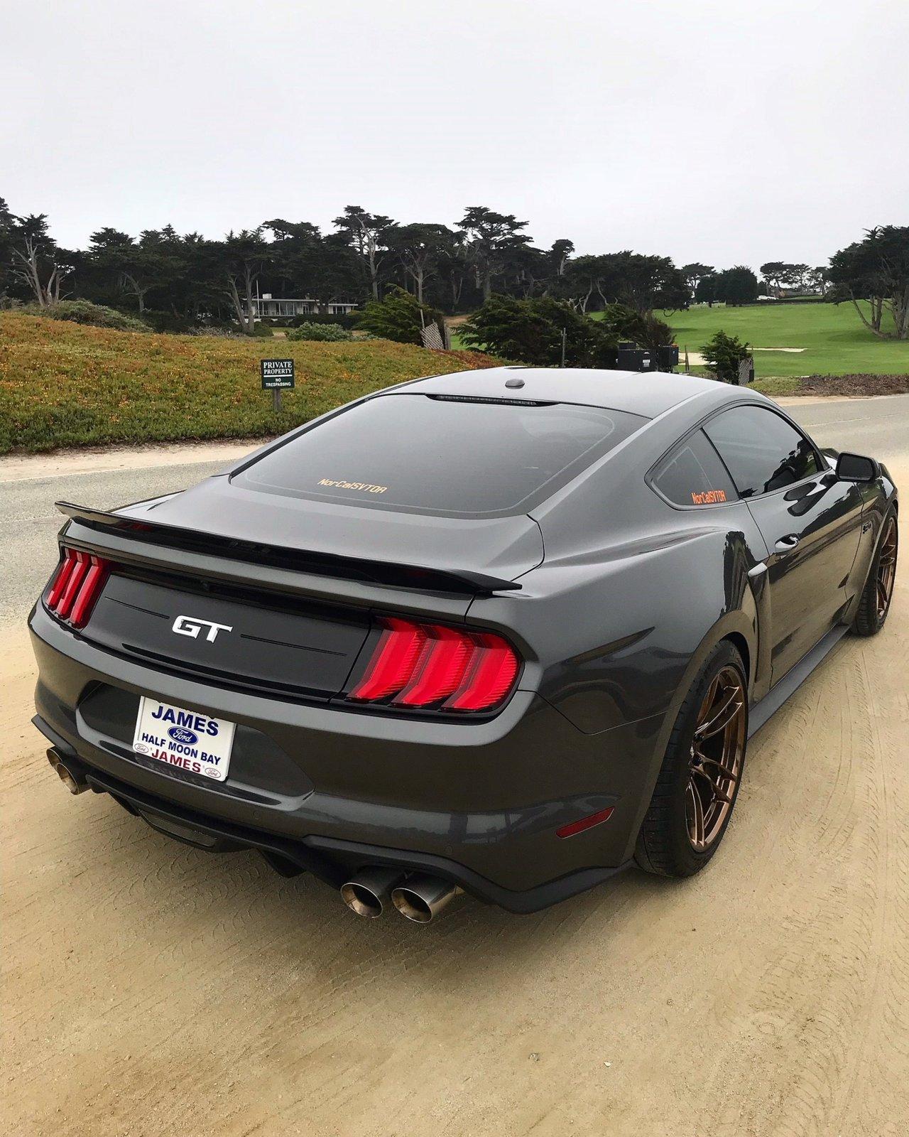

19x11 p51 on michelin ss 305 . no rub no issues at all.
