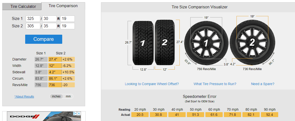

I’m currently running 295/30/19 front & 325/30/19 rears on my pp2 Mustang (on eibach sport line springs) right now the rears are currently bold and I need to replace them.
I have some 305/35/19 pilot sports 4s in my garage that I plan on replacing them with since I already have them. I was wondering would that tire setup mess with anything? Handling wise ride quality etc… I’ve done a bunch of research and couldn’t find anyone running that tire setup I’m assuming it will have a lot of rake which I don’t mind

I doubt you'll notice 9mm.

Here is what I'm seeing the differences between the two are. I'd just want to make sure the tire would fit fine on the rim itself
