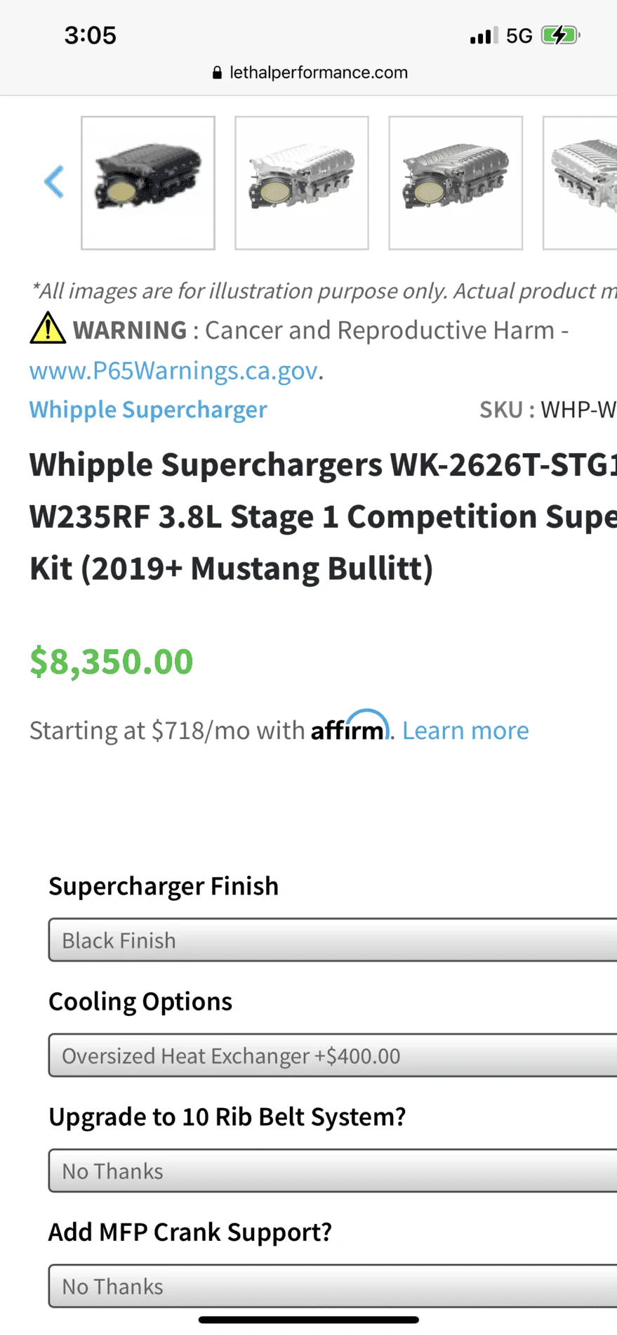

it’s actually a bigger saving than I thought starting with the swap kit .
If I will ordered the complete kit with HD exchanger it would be $8350 , so about $550 savings .

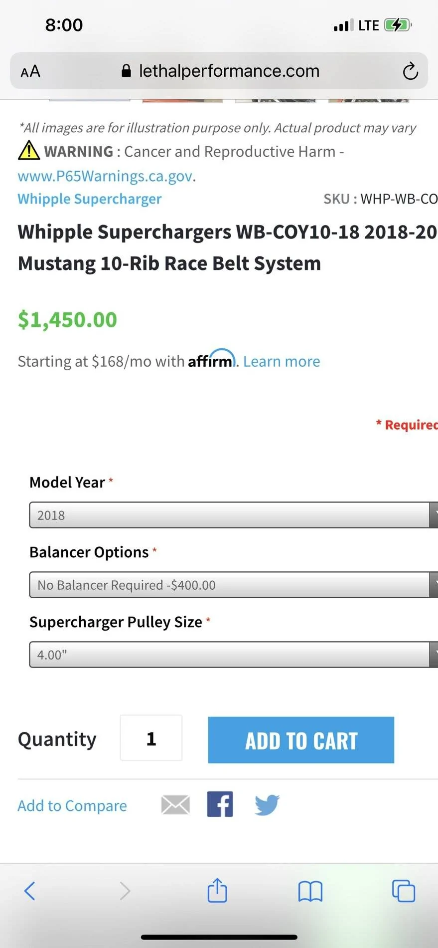

Can you also see if I can get the cobra jet kit without the 10 rib drive since I already have one and several pulleys ?
I figure that potential $1450 plus the cost of a pulley off the price of the kit .

The CJ upgrade kit is totally separate from the 10rib. Yes it deletes the pulley system, but if you already have 10 rib (which, remember, the 3.8L has a different supercharger pulley than the 3.0 its 5 bolt instead) we are unsure if it will be exactly the same as the 3.0L. The idler setup/tensioner plate may end up being different. We'll see.

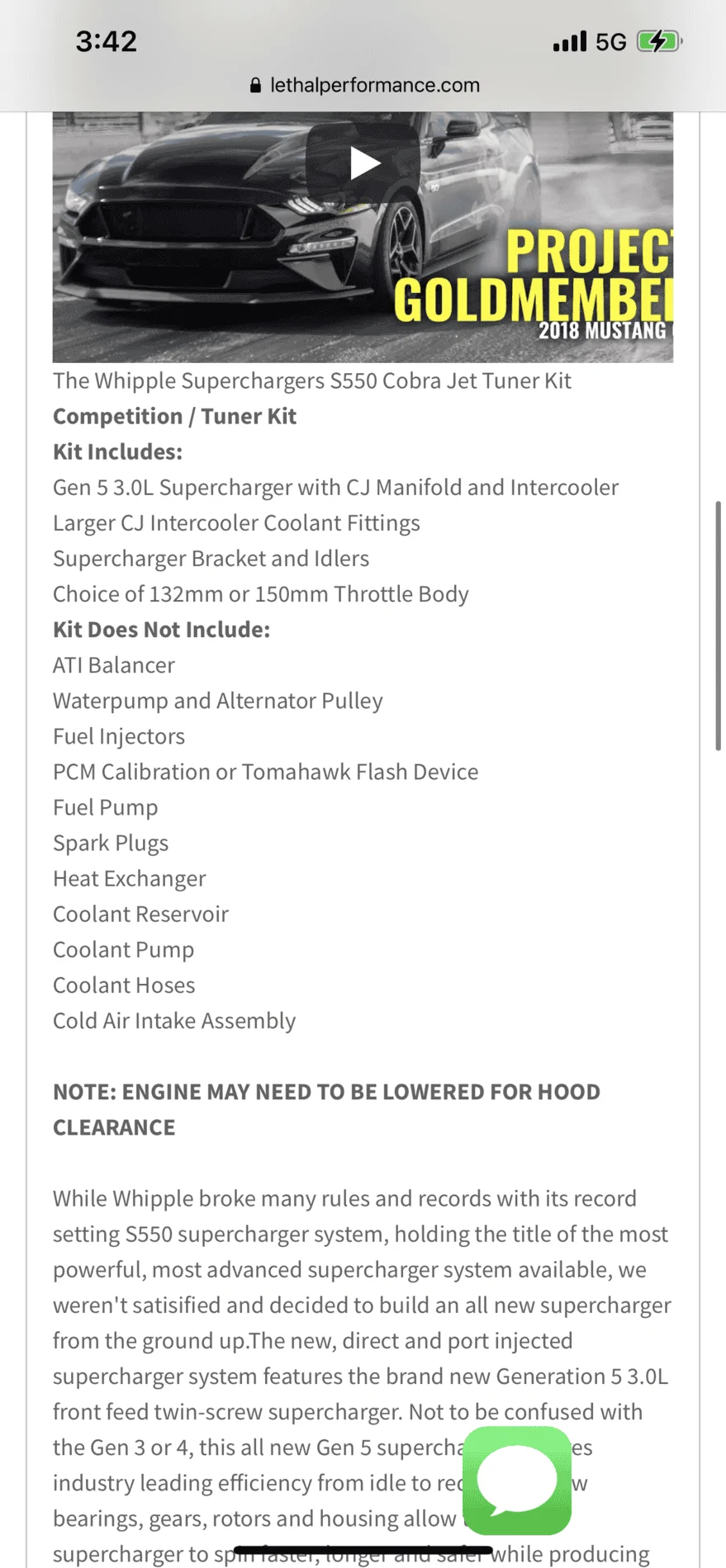

Ok , forget the 3.8 then , too many potential complications.
I was referring to the cobra jet tuner kit (not the lid upgrade )
I know it does NOT include the damper but I assumed it came with the rest of the 10 rib kit .
