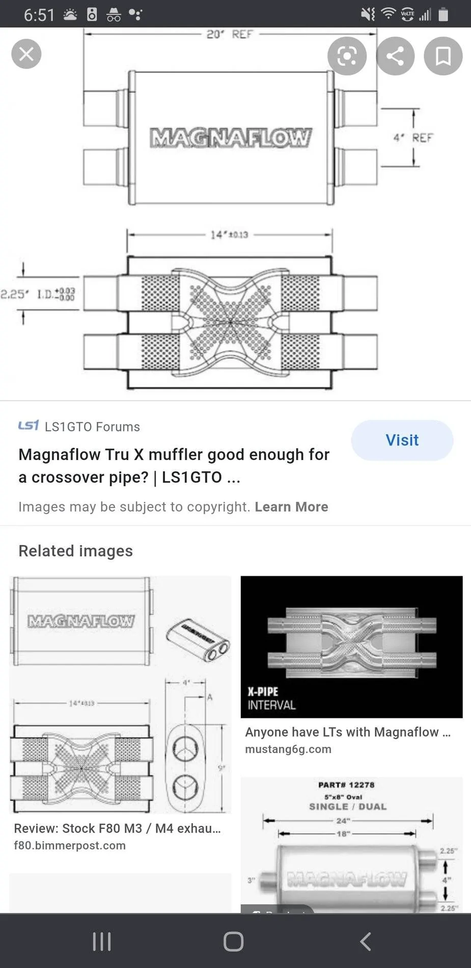

H pipes sound terrible on the car IMO. Want something thats sounds clean add an x-pipe box muffler. Think magnaflow tru-x. Replace stock resonator with this product or just pick up a cheap ebay x-pipe, paint it with some VHT, then grab some vibrant resonators, have them welded to the x-pipe by exhaust shop, replace the stock resonator with this configuration. Trust me both these options sound good and won't ruin the sound like an h-pipe does in the high rpm band. The tru-x (pic attached) is close to having zero drone as a bonus when highway cruising.

Not quite what I was saying. If you throw in just an xpipe in the place of the stock resonator it will not sound good at high rpm and highway load. Needs to be an x-pipe MUFFLER. Like the picture above. Its an XPIPE encased in a muffler. That design makes for a great clean sound with little to no drone. They do need to break in...
