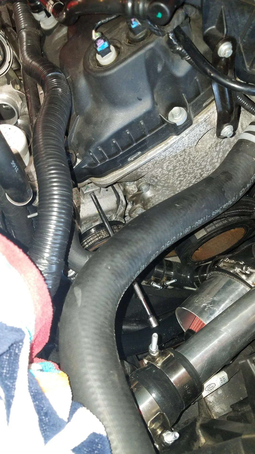

2017 Mustang V6
I was looking for instructions on how to deal with this belt for a long time. I had to take my compressor off 3 times and the first two I just manhandled the thing off / on it was a complete pain in the ass. The third time I noticed a block with a hole in it on the top front of the compressor casting. I'm not sure what it's meant for, but I used a 1/4 socket extension to get the leverage needed to stretch the belt. I was able to get the belt off and back on way easier this way. Loosen all three bolts, pull them out as far as you can and pivot the compressor on the front 2 mounting points to remove / stretch the belt. IDK if this is how you're supposed to do it, but it worked.
