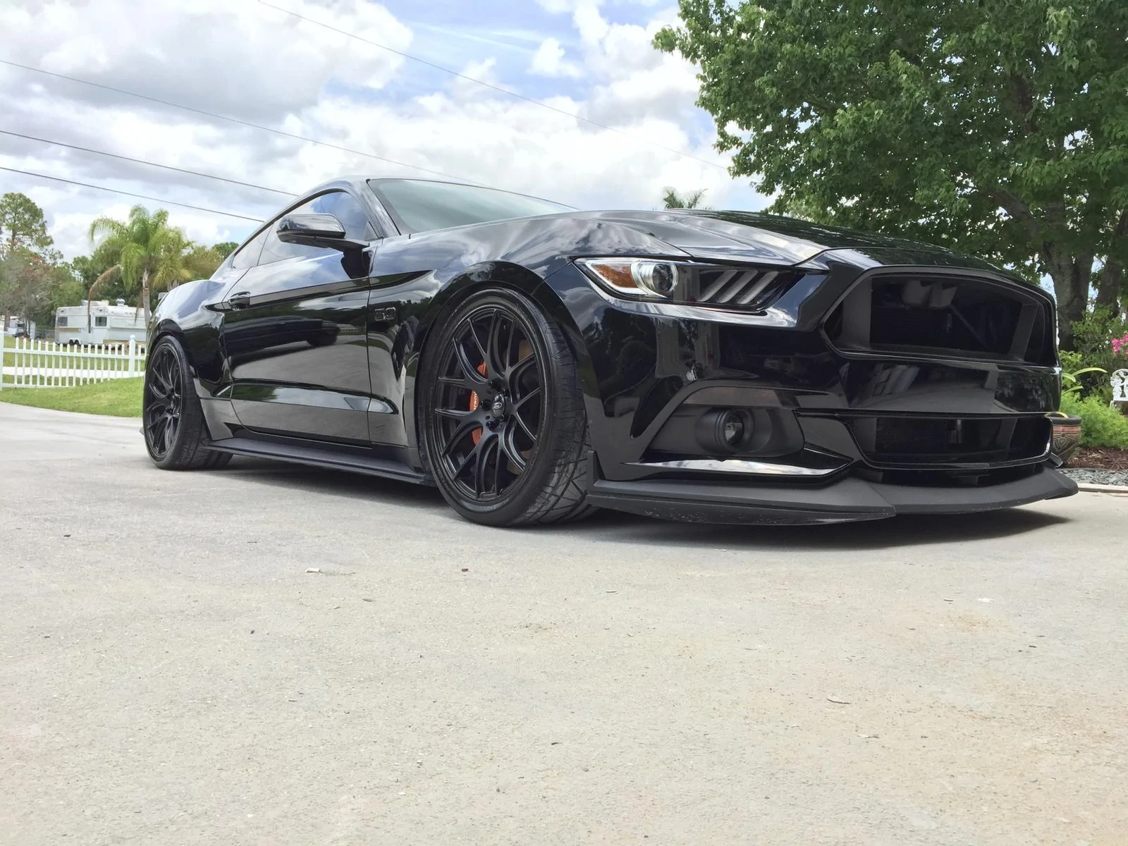

I have multiple members running these on multiple platforms they work great, stick like crazy and are awesome.
Were doing a TSW setup with these tires next week car is lowered of course.
They are rated as a 200 treadwear but act as a 100.

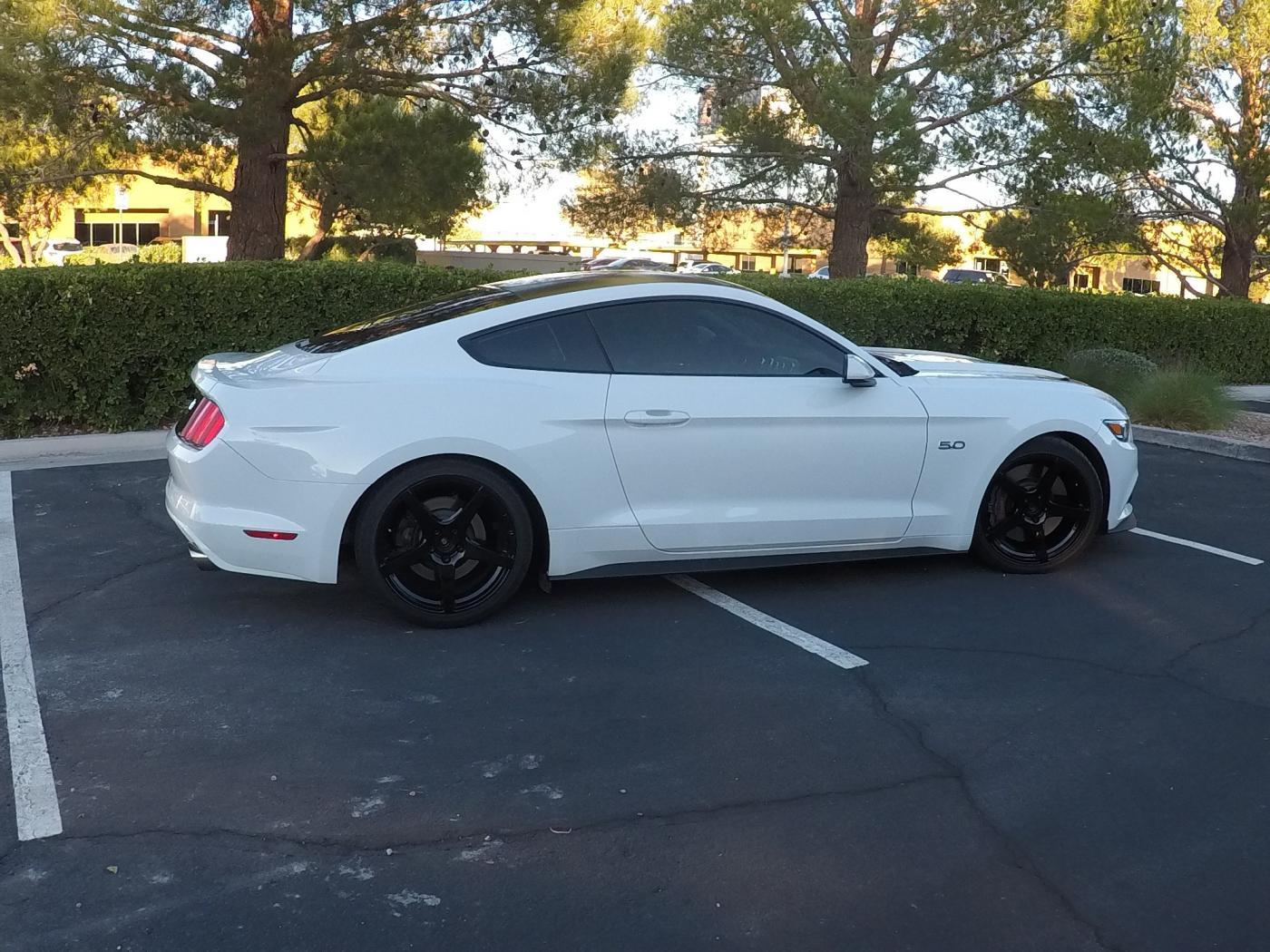

Not the same tire, but 285/25/19 firestone on 19x10 +48 wheels (5mm spacer in front to clear brakes). Lowered about 1.5 inches on afe coilovers.
What wheels are they?

That doesn't look to bad at all, I'm thinking of picking up some of the SVE gt350 wheels, 19x10 all 4 corners with a +40 offset

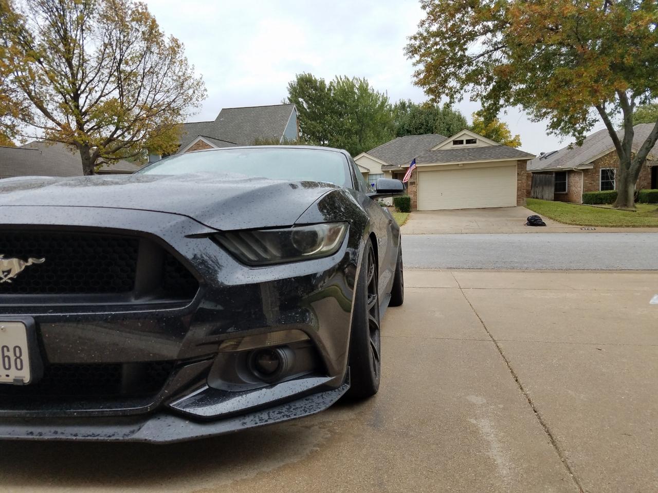

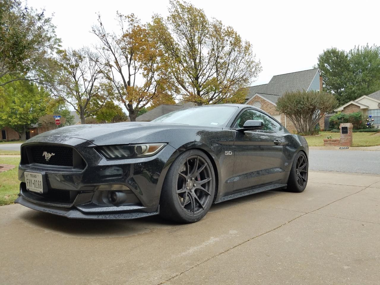

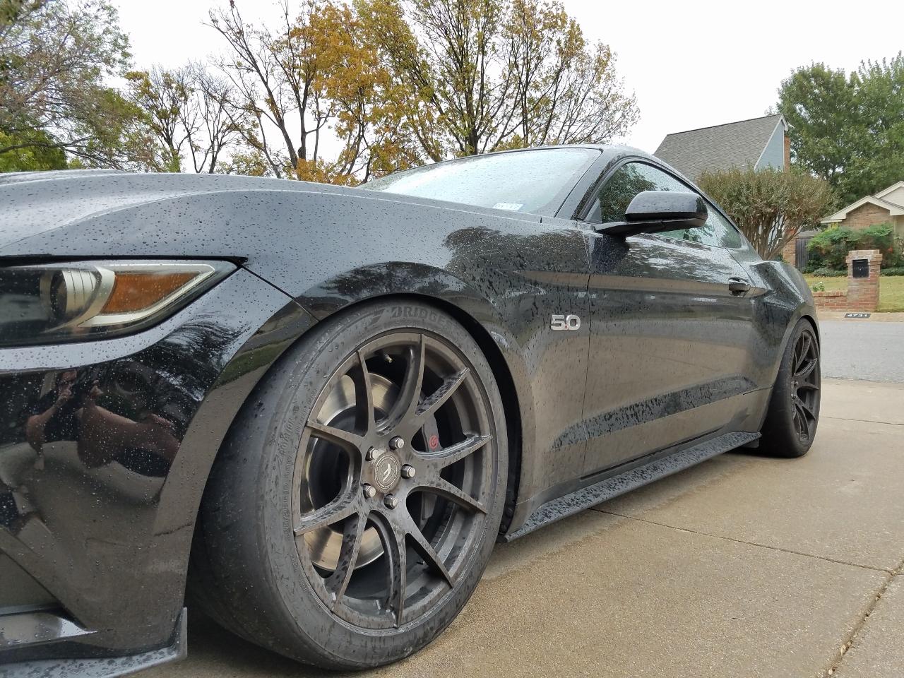

Here is exactly what you want ;) 285/35/19 RE-71R's, lowered car. Wheels are 19x10 +35 all around. Yes, car is filthy in this pic.....
