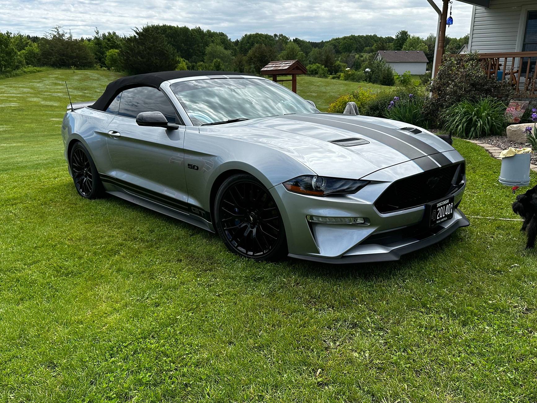

You really only need the lower splitter part. The PP1 splitter can be drilled from underneath to attach the PP2 splitter. It's not easy to line up as you need to hold the PP2 splitter in place with the ends attached at the wheels and somehow make marks on the underside of the PP1 part. I put masking tape in the places where the clips have to go through and used the imprints to mark the drill locations. Only drill as deep as required. Put tape on your drill bit to make sure you are not drilling through the top surface. The PP2 part (JR3Z-17626-AA) comes with a hardware kit, but the plastic rivets are janky. I ended up using some better plastic rivets (size 6.3mm x 25.2mm POM rivets, 21 pieces required) from my local auto hardware store. I think for you guys in the US, they can be bought from Harbor Freight. You'll need the pop rivet tool to install these. The install is solid and looks factory.

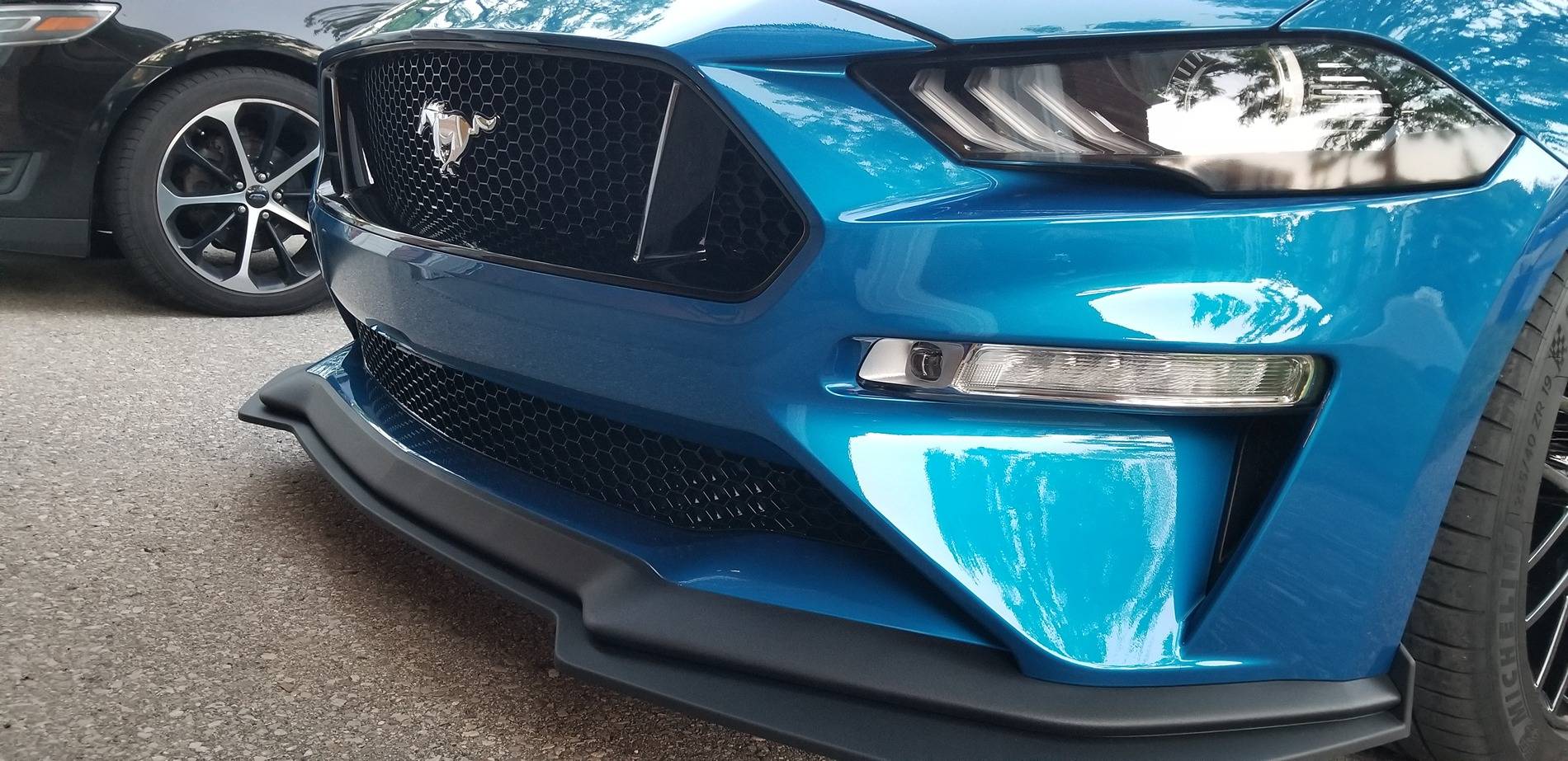

OEM PP2 splitter picture.
Did you add the PP2 splitter? I’m doing the Mach 1 PP2 style Ford Performance wheels, the front lower splitter, and a couple other things.

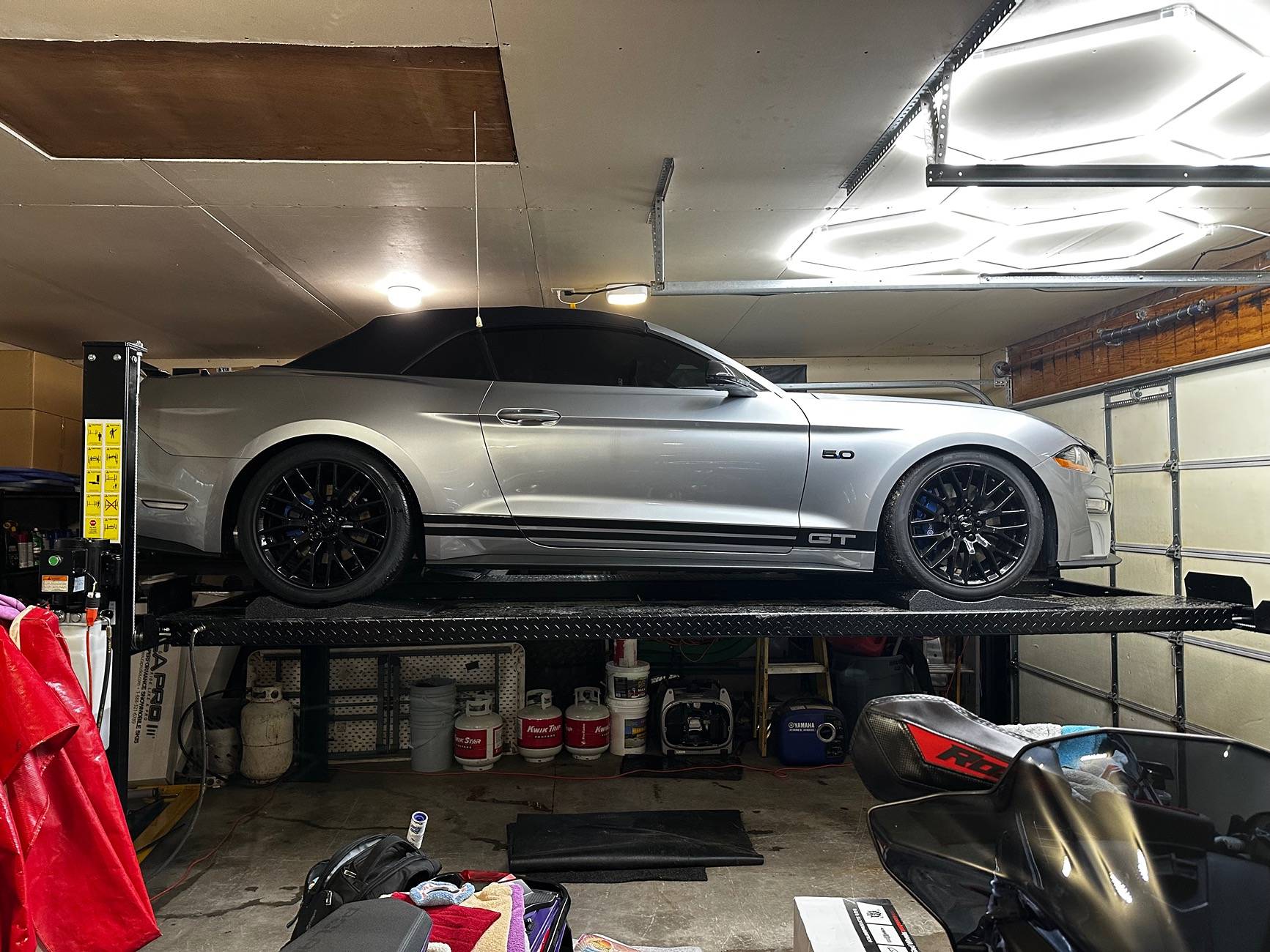

Thanks for the information, I have a 4 post lift so that will make my life easier doing the install
