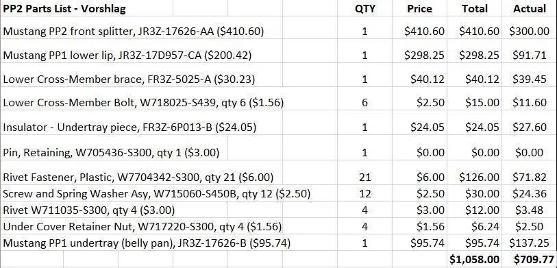

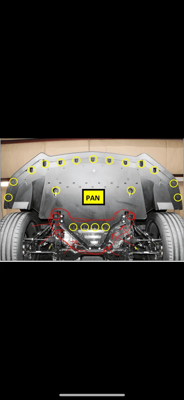

I wanted to give a quick heads up to anyone looking to do this. Many sources will tell you that you just need the performance pack belly pan, a few bits of hardware for it and the PP2 splitter kit. This is incorrect and you need several other parts after doing some digging. I was able to find the full list with all part numbers, so nobody runs into the same issue down the road. The circled red piece is the part that everyone fails to mention is necessary to finish bolting the belly pan to the car, otherwise it extends further than you need. In addition to those part numbers in the photo, for the belly pan you will also need:
W704823-S439 (12 total)
And
W715060-S439 (8 total)
EDIT: You also will need the performance pack fender liners.
Drivers side: JR3Z-16103-C
Passenger side: JR3Z-16102-F
Hopefully this saves someone some time!

So let's say I was going to buy this
https://www.lethalperformance.com/f...ZYlGd2Xjs3GlabnbYFIleH0OdLH9ysloaAu91EALw_wcB
What else on the list would I need?
Also on your sheet, price is, I'm guessing from Ford? How would we get the price under "actual"? That decent savings.
Thanks for doing, I haven't seen any how to videos on YouTube about doing this.
So if you were to purchase that kit you would not need the PP2 front splitter or PP1 lower lip on the list but you would need everything else, plus the fender liners I added to the post if you’d like functional brake vents and the best fitment. The pricing honestly is from someone else, I found that photo deep on some forums trying to create this post so I’m not entirely sure how to get the savings. That being said I would assume the parts are going for about the same price or less these days.

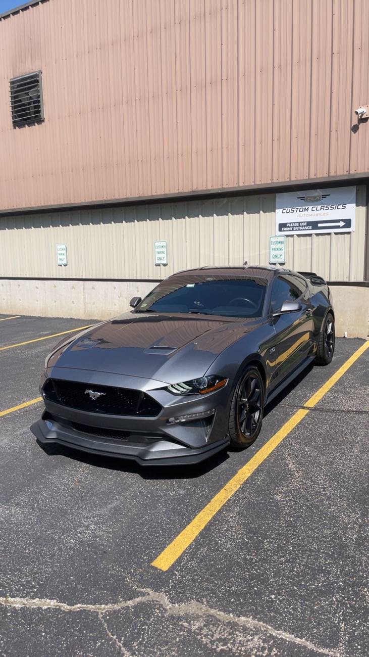

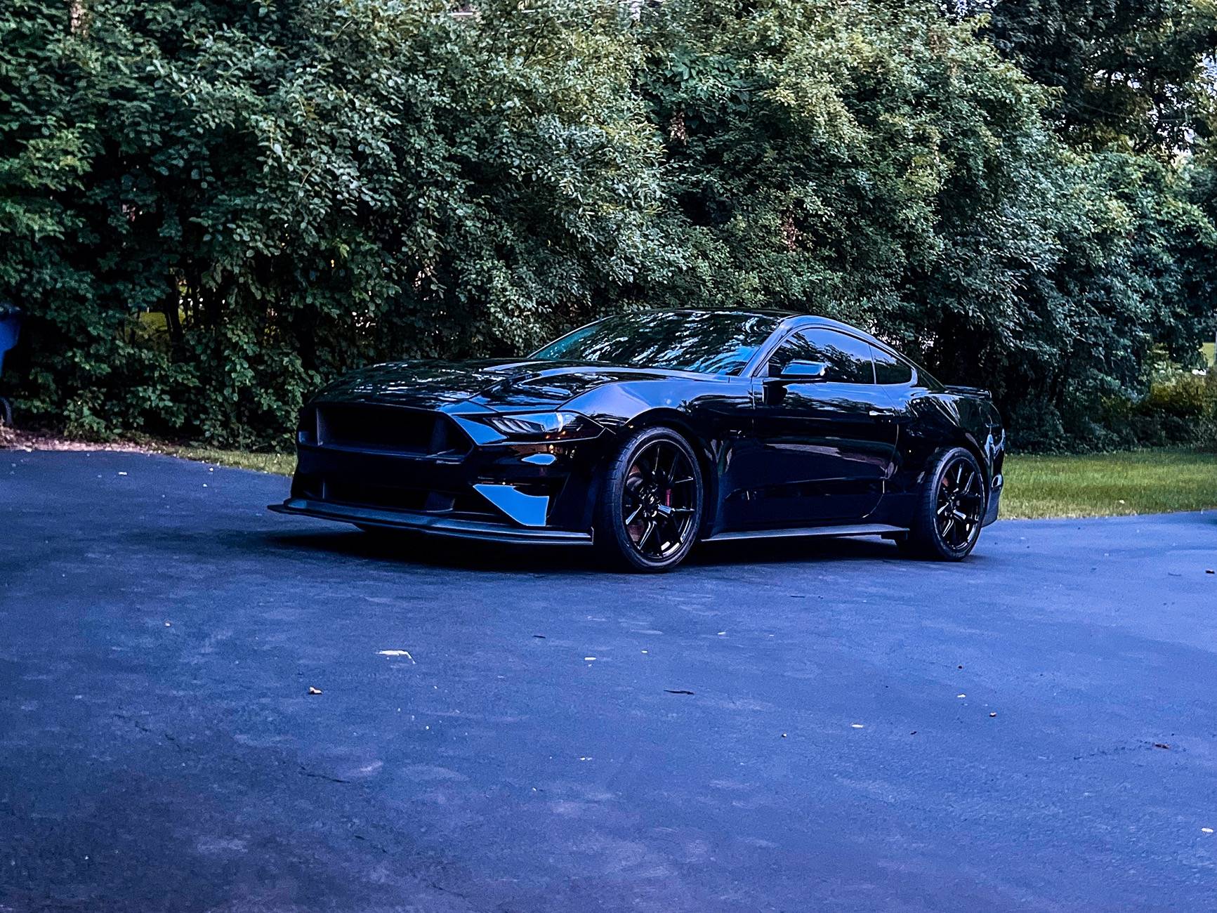

How mine turned out

Dammit. You guys are going to make me spend more money now 🤭.

Watch out for inclined parking lot entrances now 😂 I’ve heard a few scrapes already. Looks awesome!
Thank you for the heads up I’ll be careful! 😭

w717220-s300 , how do these little black things go it, I'm having the hardest time figuring this out, I'm sure it's simple. Undercover retainer nut is what it's called.
