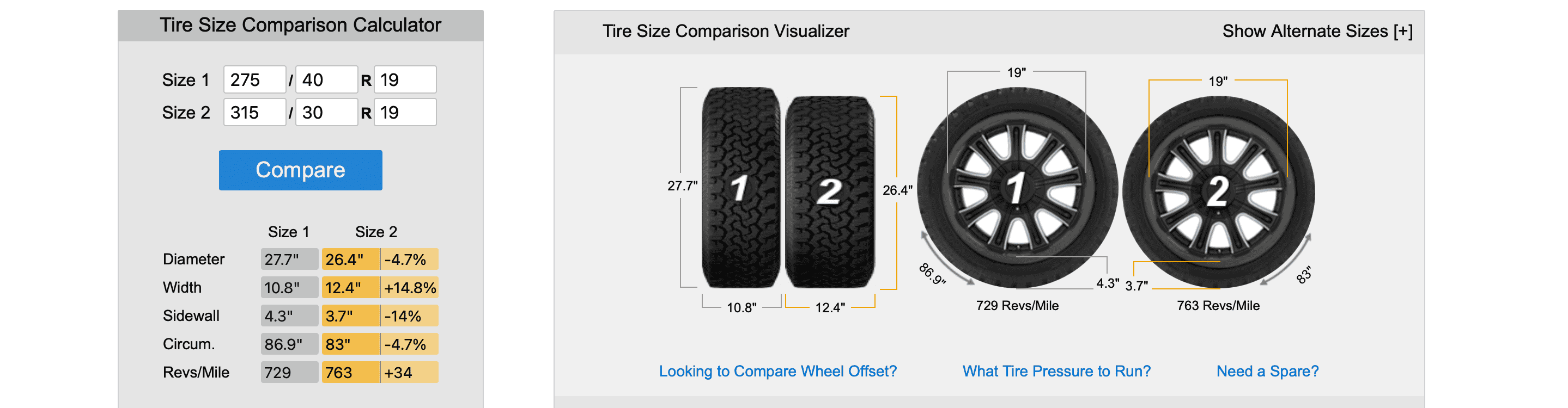

The tire difference are 27,7" Vs 26,4", is 1,3" lower

0,6 x 0,6 don't forget the upper difference this is te reason 1,3 lower tires.
1.3" is the difference in total diameter, not the amount the car is lowered. That difference in diameter would only lower the car about .6"
Supposedly the factory HP springs are .4" lower (which I believe is unconfirmed).
So at most the HP cars are 1" lower than non-HP cars. But, like Charlemagne said, I believe the real hight difference is less than that.
