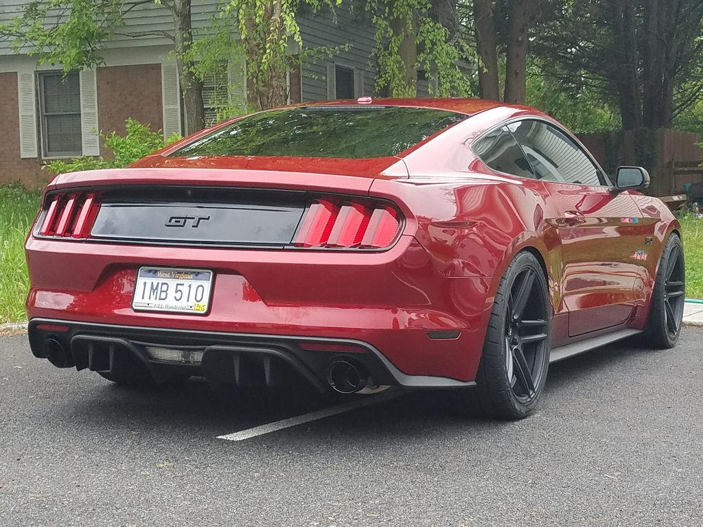

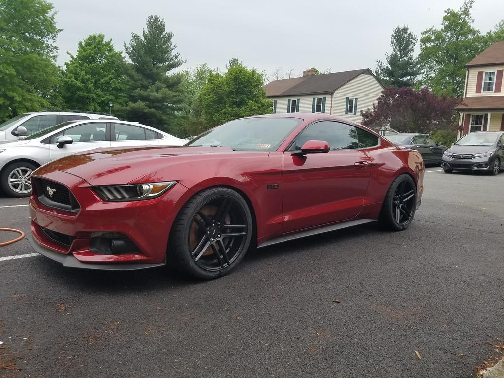

Velgen Split 5 20x10.5 45 offset, 8mm spacer upfront. Nitto555 g2 305/30/20 all around. Steeda Ultralight springs and Non adjustable shocks/struts for the drop.

This gives some idea's..
How does it ride with the 30 series tires?
I wanted to stay at 35.

With the steeda setup I think it rides great. Its stiff but not harsh at all. I feel road cracks abit more and I take it easier over things like railroad tracks and driveways but that to be expected. Anyway its not that big of a difference from the stock setup... with the increase in width the 30 series is only about a half inch shorter(1/4 between contact patch and rim)in the front from the performance pack size. So not a huge difference.

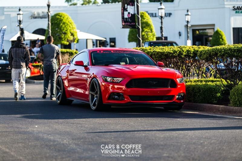

Here is mine
