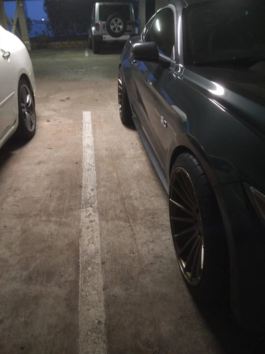

So does the 20x10.5 with 285 fit all around without any rubbing with passengers? Or do you have to be on sportline vs pro to get it to work?
Itll work with a 285 yes , you can be stock height, lowering helps of course.

looking really solid [MENTION=16422]Oracle[/MENTION]

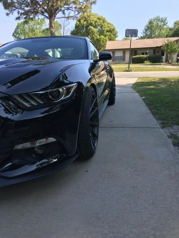

Threw some 285s on that I got from a buddy. They are self clearencing as we speak.
I like it. Adding just a half a degree more camber would fix that rubbing and it doesn't look like you are running much camber right now maybe 1.5-1.7* just a guess.
I threw my fender roller on there(with a heat gun of course), made like 3-4 passes tightening it only 1/4 turn each time and its flawless now. i may pull them a little more so i can run less camber actually, little more contact patch
I know the fronts are not fully rolled but the rears are fully rolled or were you able to use it to pull the rear fenders out a little?

What a square 10.5" +25ET looks like with a 275 35 20. I'm lowered on Sportlines
Finger barely fits and it just came off the lift hadn't driven on them yet.
