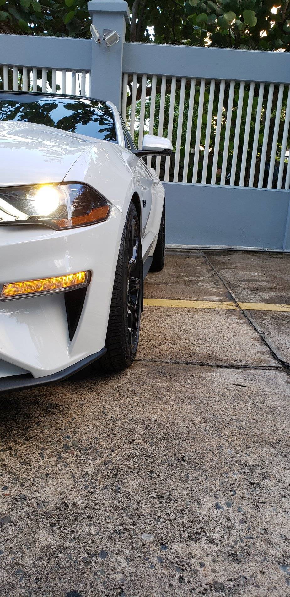

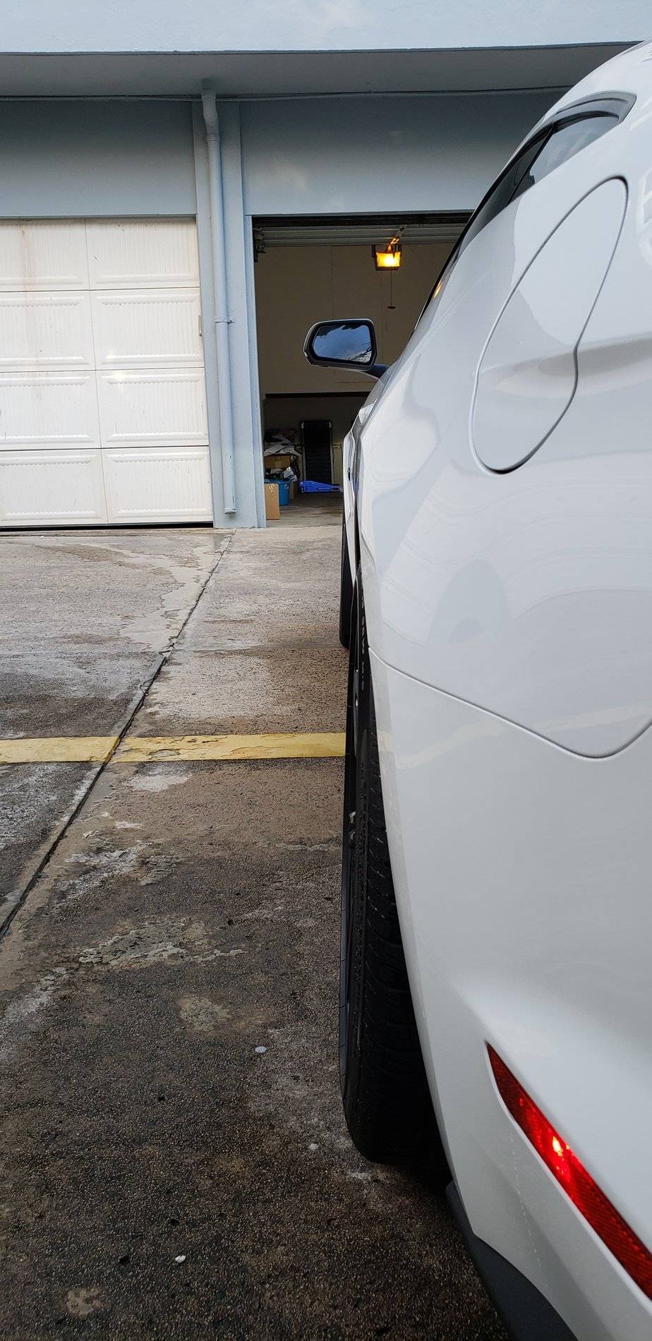

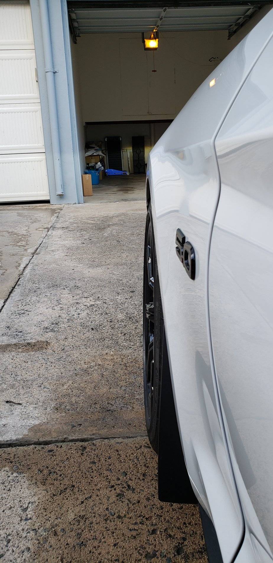

25mm front, 20mm rear. Way to go with black accent wheels. Perfectly flush, no stud trimming needed

What's the difference or benefit of doing 25mm all around versus 25mm front / 20mm rear? Do the rears poke with 25mm?
Jonyxz
Apr 16, 2017
354
269
San Juan, PR
2019 5.0 401A 10R80
Yes, black accent pack wheel will poke a little on rear
