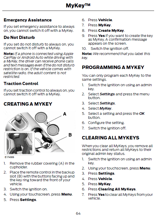

i think if you pull up the rubber mats at the bottom of the cup holder there is a square slot to put the fob into, i think you can turn that MY KEY back into a normal key using that slot and the menu options in the my key app in the dash.
Has anyone tried this before?

I made a My key then decided to change it back to a regular key as i live alone, but i don't remember the exact process
You most likely had both keys at the time in order to change it back. I just tried what was mentioned above about placing my key in the slot inside of the cup holder and I got the same options as before. I only can view key status. No option to change back to admin.

if you only have the one key to hand how many keys does the car have registered? If not one then you have a key floating about out there that can be used on your car to drive it away.
I'd suggest getting the dealer you bought the car from to not only supply another key but to clear all keys from the car and then set both the current and newly supplied key to the car - as per the manual. I had to have this done on my own 17GT though it took two dealers to actually do it right. This process will give you two admin keys and only those keys will be registered to your vehicle.
